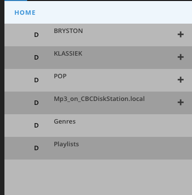

Re: Manic Moose (S2) - BDP's third major firmware release
« Reply #515 on: 30 May 2014, 10:01 am »
Hey Chris,
New icons in the playlist, work well! (though the folder icons still is a bit too Computery for me...(don't you have a nice icon of stacked records :D,  or at least something along the ones of
http://www.iconarchive.com/show/hyperion-icons-by-icondesigner.net/Music-icon.html), and a separate one for the network drives would be nice too. If so, we could do away with the strange and rather ugly naming of the network drives right now.
More essential: Will you be adding a direct Home-button ? Since the music library is often deeply nested, this is rather a highly necessary option. And, to make it even better, make the breadcrumbs hot clickable on every nested folder. Would be wonderful.
Marius

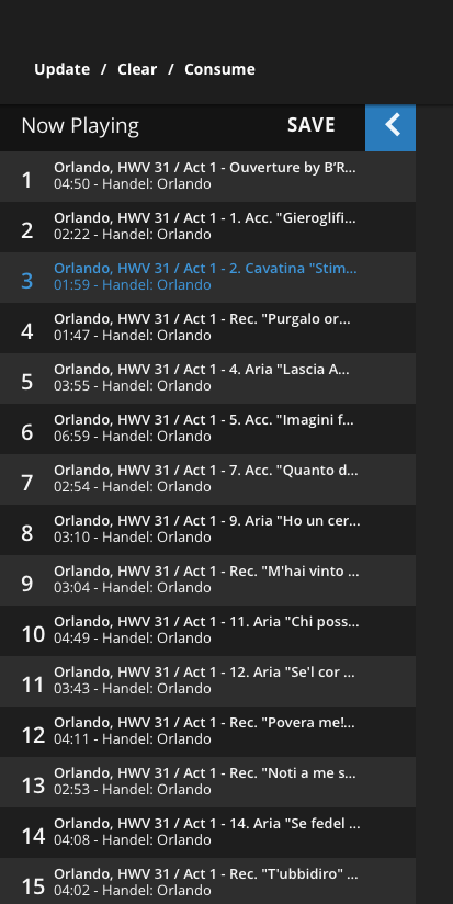

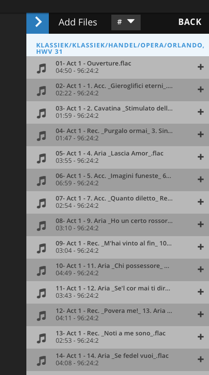

« Reply #516 on: 30 May 2014, 10:10 am »
Chris,
Using the filename over tag data option still won't solve the issue of long filenames not being shown from the relevant parts of it.... and, it doesn't affect the display in the playlist. This results in 2 different ways of the tracks being displayed.
Also, ive noticed that hovering the playlist only shows the first bit of the filename, not the full file name like before (cant screen it, because of the mouse pointer obviously )
