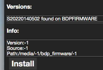

Marius
Re: Manic Moose (S2) - BDP's third major firmware release
« Reply #469 on: 3 May 2014, 08:29 am »
HI,
Thought i was safe in 0410 to upgrade to the todays version, which downloaded fine to my usb thumb drive, but alas, this is what keeps happening when clicking install ...
Chris, is there a terminal command you can help me with, or do i gave to go back again to LL 1.73 and start all over?
Marius
unincognito
  • Posts: 2067
    • bryston.com
« Reply #470 on: 3 May 2014, 03:49 pm »
Hi Marius,
I'd recommend trying the non advance method of updating the firmware.  You may also need to refresh the seperate update pages or even clear your cache.
Chris
Marius
« Reply #471 on: 3 May 2014, 04:05 pm »
It finally went after downloading another version thus forcing to make a choice between versions ... Seems odd but it worked.
Cache etall were cleared and refreshed several times, even rebooted the bdp twice.
Will try non advanced next time, though I have non idea what that means ,-)
