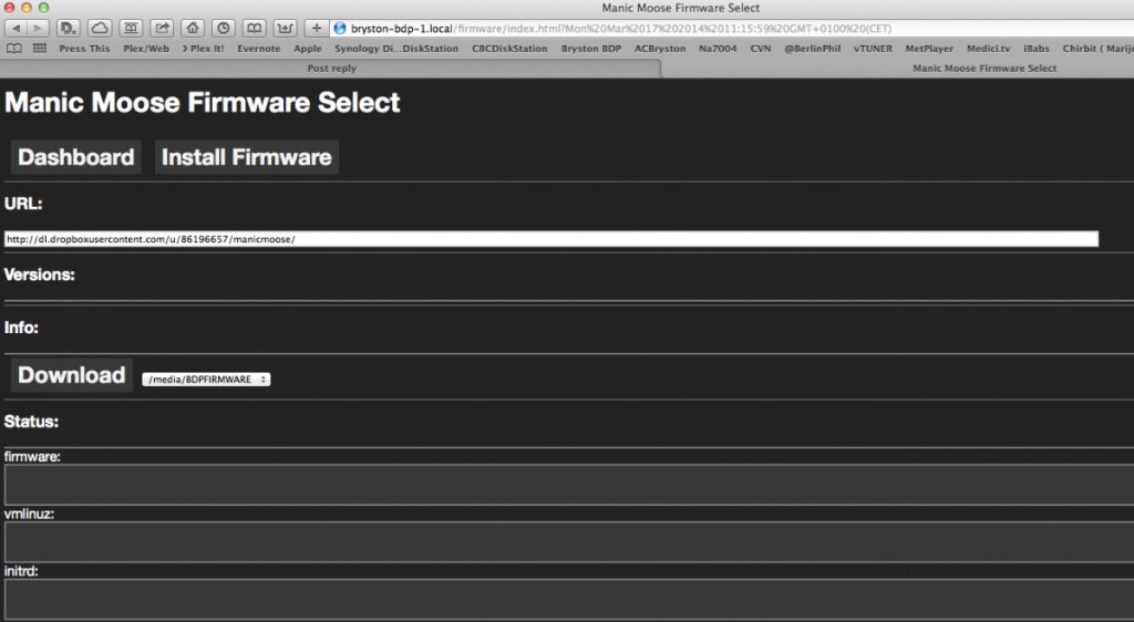

Something's up in the url for updating firmware, it looks at http://bryston-bdp-1.local/firmware/index.html?Mon%20Mar%2017%202014%2011:13:34%20GMT+0100%20(CET), and gives no result.. Chris, whats the url to check for updating firmware to the latest version?

Hi Chris,
Marius
Well the extra bits, ? followed by the date and time are there to force your browser to refresh the contents of the page rather then potentially reload data from cache.  As to why your BDP isn't loading the list of available firmware revisions, my best guess is its unable to make it out to the internet.  I'd try powercycling the BDP and if its still not working your router and anything between the router and BDP.
Chris

My internet streams are playing, so the BDP does see the internet. Updating still doesn't work though. Ive rebooted the bdp, briefly saw a list of available firmware versions, but again, nothing s showing, and the firmware field in the settings remains an empty list....
can you provide an shh routine to upgrade maybe?
btw, i'm on 0314, and thats when the upgrading-issues started to arise.
Thanks,.
Marius
Chris
