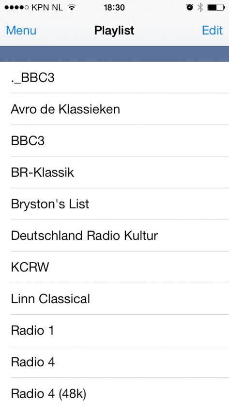

Marius

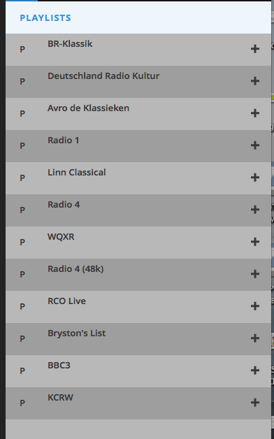

Re: Manic Moose (S2) - BDP's third major firmware release
« Reply #362 on: 6 Mar 2014, 05:24 pm »
Dont know what changed the bdp's mind, but just now the playlists appeared in mpod too!  :scratch:
The _bbc3 included....

unincognito
  • Posts: 2067
    • bryston.com
« Reply #363 on: 7 Mar 2014, 02:27 am »
Hi Marius,
The folders beginning with ._ followed by the same folder name as an existing folder I believe are temp folders made by Mac OS X.  I have been meaning for years now to create a program to help clean these and other system related files up, but the pursuit of a better interface has always taken priority.  Perhaps once manic moose is finally released I can find the time to work in these other things.
Cheers
Chris

Marius
« Reply #365 on: 7 Mar 2014, 07:00 am »
Cleaning up of these so called Mac folders/files is done with good result by the apps Blueharvest (automatically on each drive) and tinker tools (loads of great options)
I've posted on that before on AC.
This is not one of these though, no hidden folder /file to be found.  :scratch: I stand corrected... in hidden files settings of Mac/finder no hidden file was displayed. fired up my good old Tinkertools, and bingo, files discovered and deleted without a problem:
Chris, how to change the order of these files? How are they sorted? and, can we make a subdivision in these playlists?
Marius

unincognito
  • Posts: 2067
    • bryston.com
« Reply #366 on: 7 Mar 2014, 04:28 pm »
Marius
Thats a good question..... i don't know and hopefully I won't be a liar when i say.... yet
I would have thought they would be listed in alphabetical order as they would be in the file system.
Chris

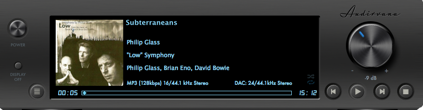

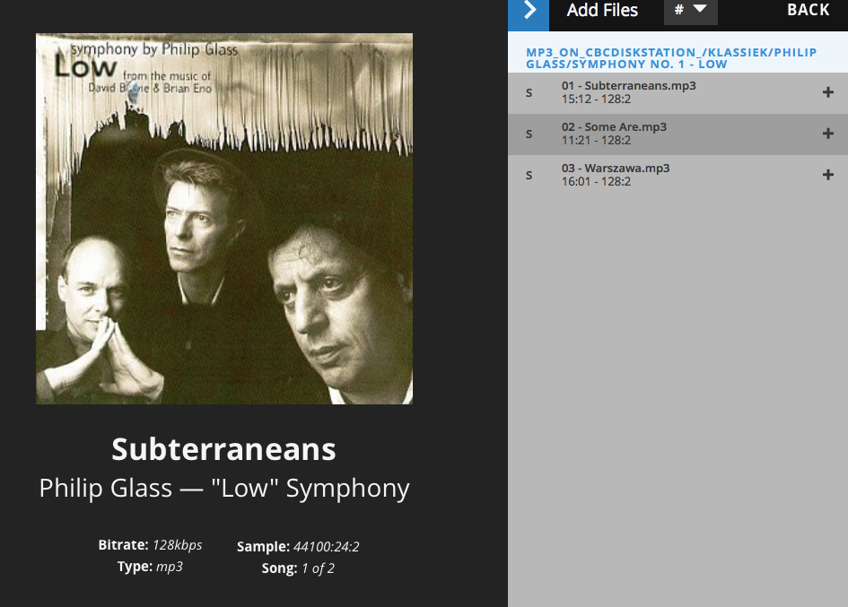

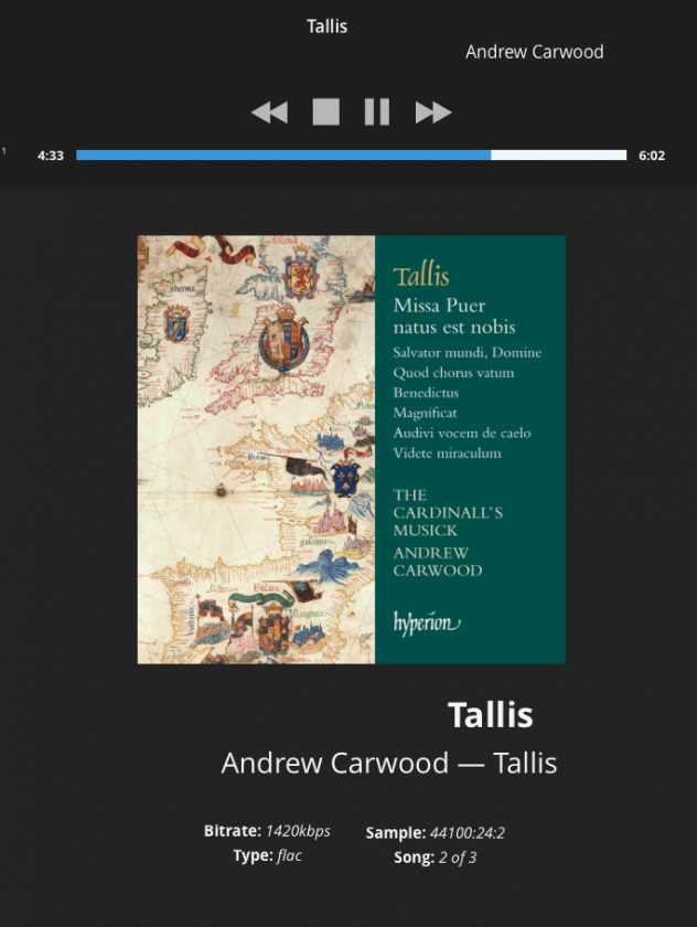

HI Chris,
Thanks for the latest update, showing bit depth and scrolling marquee.
The latter though still doesn't solve the issue of not showing all info desired,
 have a look at these previously posted pictures. The marquee now shows only Tallis and Andrew Carwood - Tallis, while the Audirvana screenshot shows whats available in the tags, and how nicely displayed that can/should be:
Please check how Audirvana displays album information, MM can adopt this?
Marius

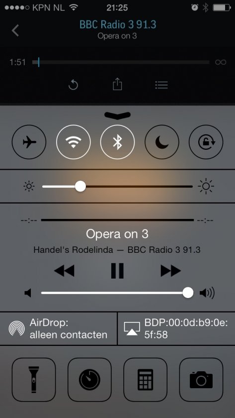

Hi Chris,
Just found out we can use the shairplay successfully! Streaming BBC3 from my iPhone Tunein pro app right now . Amazing.
Only thing is the front panel display is black showing no activity. Will you update this anytime soon?
Great substitute for Bradio , although the shairplay may not use the utmost of bit depth and resolution possible .
Cheers Marius

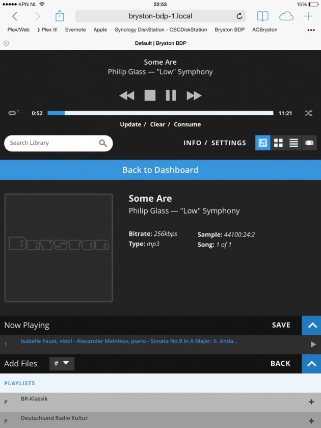

Hi Chris,
Bitdepth is not quit correct on this one:
definitely a 16 bit MP3 file:
How come?
Marius

Hi Chris,
Cheers Marius
Should be fine, it should stream at 48KHz 16 bit loss less, so anything compressed (like streaming radio)  should be fine and not suffer any loss in quality.  Also if your using a Mac you can set the output device in system presences as the BDP, there is delay though so it really isn't any good for video.
Chris

HI Chris,
Marius
Perhaps its because i'm not displaying all the tag data, like composer?
Chris
