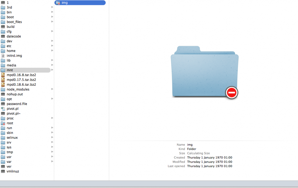

only thing is i m not allowed to view, nor write to it
seems one has to be logged into the drive. Can you provide the ssh command to make the mnt/img/playlists folder, so i can copy my old playlists here please?
and, before they were .m3u files that still correct?

Marius

I'll have to change some permissions, in the mean time log in using the user name root rather then bryston, the password is also bryston.  Or ssh into the BDP and enter the command
chown -R bryston /mnt
Yes, m3u, I thought you said something different earlier.

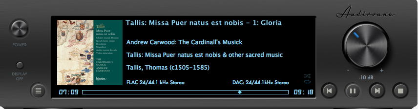

Marius
Re: Manic Moose (S2) - BDP's third major firmware release
« Reply #349 on: 4 Mar 2014, 06:39 am »
nope, cant see it:
no 24 bit displayed. It's a 24b 44.1 flac file. Resolution confirmed in Audirvana +.
Please check how Audirvana displays album information, MM can adopt this?
Marius

I always ssh in as [email protected]
and, in this case, to no avail, it doesn't change the permissions. Or should i reboot after that? As i am in developer mode, maybe i have to change that with a command in MM? Root is always displayed in Mac/Finder.
Marius

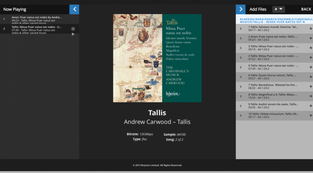

It's visible when browsing the library, but I think Marius is saying it should be visible in the now playing window.
Marius
« Reply #353 on: 4 Mar 2014, 06:51 pm »
Hi Chris,

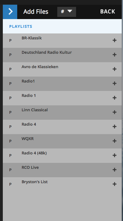

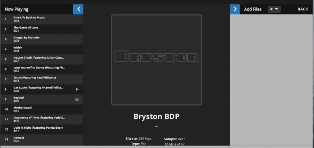

Yes i meant the main (central) display. I see now you have an indication to the right in the track list ... Missed that before , sorry.
I think the 2 pics clearly indicate the issues I experience here, concerning file names folders and tracks. Audirvana seems to get it exactly right, where the MM display misses out on details in all listings.
Hope you are inspired by them!

great! playlists are functional, and my internet radio streams are playing  :thumb:
somehow the display still lacks some info-feedback, but, after a long time of absence, thats minor detail.
Chris, thanks!
If you'd give us the option of editing these manually like before, that would be really nice. And, create the option of entering a web address in the interface somehow, for creating new ones, without having to hack into the root....

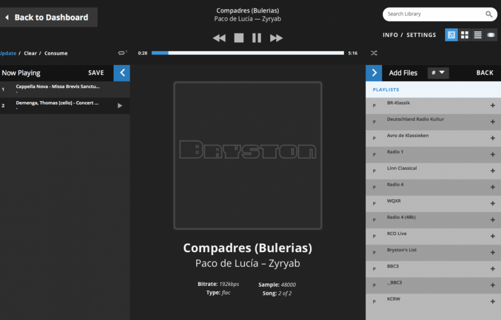

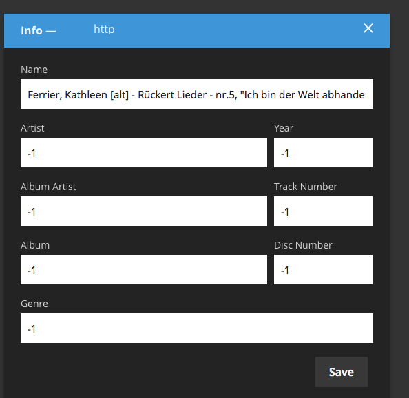

some small quirks :
- the player info is incorrect and not updated adequately, and keeps coming back to Compadres by Paco de Lucia, a track ive played before.
- You see in the left panel what's playing, but the line is way too small to show it correctly, (but hovering shows it in a popup) didn't we have a button before to widen this view?
- the info window only shows a scrolling 'http" without any further address-info
- in the right panel an entry with _BBC3 is displayed. I can't seem to find anything in the folder that this could be. How to take that away? Ive updated the mpd but that didn't resolve it.
- only clicking the plus makes the list active, while clicking the name is expected behaviour... will you change that in a future version?
- lastly: in the info window this scrolling of the track being played is what some of us have asked for long since. Could you enable this in the main window too, when a track has a file name too long for the available screen real-estate ?
- if so, please have that on the main frontpanel of the BDP too.... now that would be really super!
Cheers!
