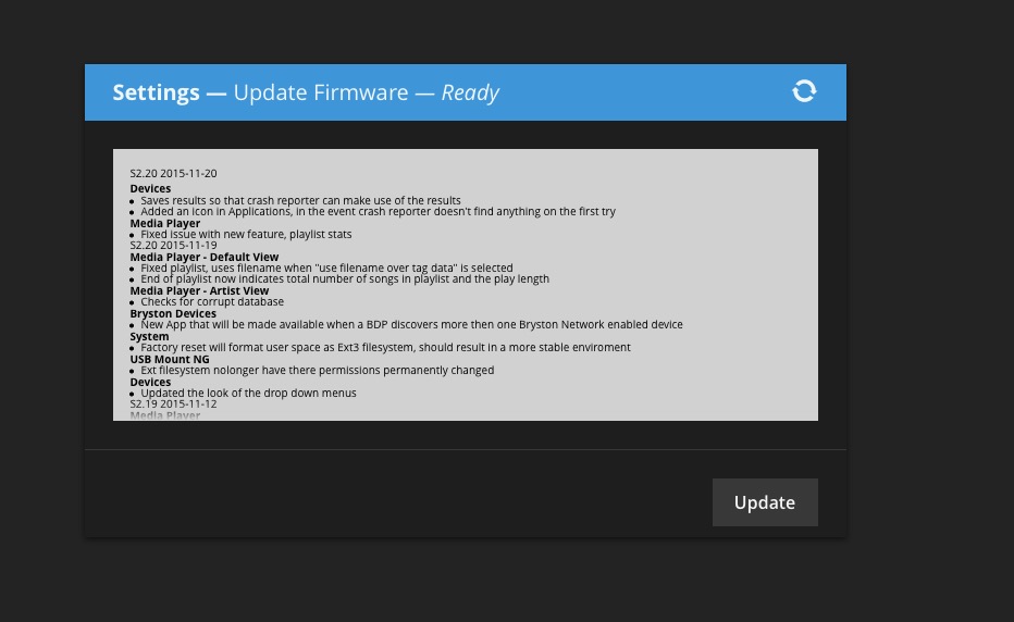

Hi Chris,
to make updating the firmware a bit more convenient, could you add a 'current firmware version ' to the window on the update firmware page? I know current version is stated on the system page, but obviously it requires clicking and reloading the update page, which sometimes takes quite a while to load. Combining these on the Update page is just that bit more user-friendly.
Especially for the beta testers, for whom the update icon doesn't light-up blue whenever an update is available.

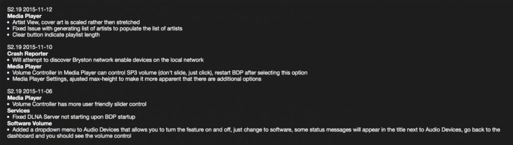

Hi Marius,
We have recently started building a new support page, it's still pretty early in its development; however it currently does contain features requested.
http://support.bryston.com/site/?firmware
You can look up and read about current firmware releases (stable and testing) and it will show the firmware currently installed on your BDP and the current stable release.
Cheers
Chris

HI Chris,
looking promising! only gripe: yet another interface we have to load separately. Will you build this into MM? It would really be very nice to have it all available in one click/view/interface.
btw, is the stable release developed further than the beta right now? version numbers seem to be incorrect?
  my beta (or so i think it is) MM is showing
my BDP won't upgrade at all at the moment, is anything happening on the server side maybe?
Marius
Hi Marius,
Cheers
Chris

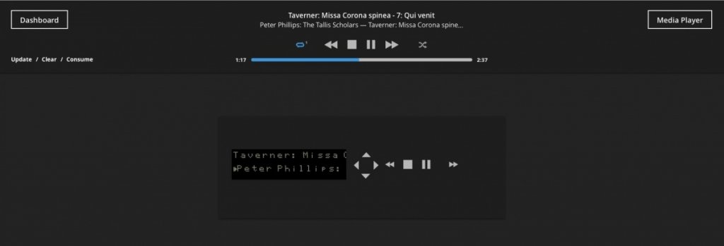

Hi Chris,
Did my request to streamline the 'Back, Dashboard and Mediaplayer' buttons ever reach you?
Please consider always displaying both Dashboard (left) and Mediaplayer (right), as you do on the virtual frontpanel page (see enclosed pic). With the obvious exception of the Dashboard and Mediaplayer pages themselves.
Also, 'Back' could always be replaced by Dashboard, thus simplifying the interface even further.
Above would make the interface faster (one doesn't need to go back to the dashboard anymore to load Mediaplayer from within the settings tabs, since the button Mediaplayer would always be there) and Back wouldn't be necessary, Dashboard will do better (and be more exact, since it goes back to Dashboard...) and take out the confusion it might cause on some pages, where Back isn;t as clear as it could be when called Dashboard ;)
on the VFP: as shown it doesn't fully reflect what is shown on the real front panel, which is wider and contains more characters, could you please correct that? Ive used this VFP often for testing purposes, checking the BDP. It would be most helpful if it correctly shows what is displayed on the real frontpanel.
Marius

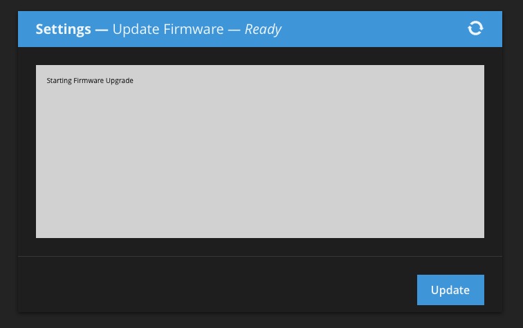

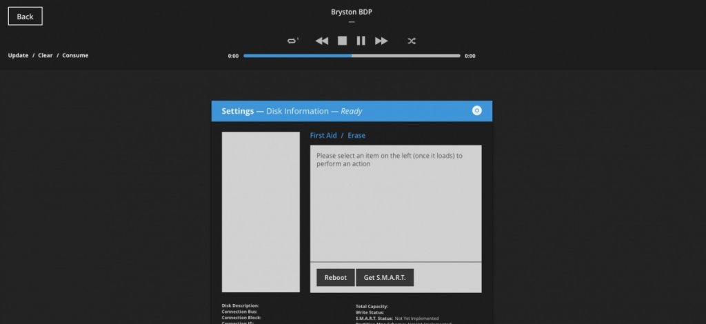

Chris,
I just loaded the latest firmware, S2.20 2015-11-20, onto my BDP-2.  There appears to be a couple of issues with this release.
  • When I go to Disk Information, it does not list my internal 256GB SSD.  It used to list it in the last stable release.  I am able to access the drive in the MPD player and play files off of it.
  • When I go to Update Firmware, it only shows, "Loading..."  It does not matter how long I wait.  It does not show the latest available firmware for updating.
