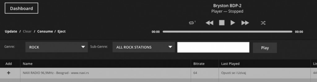

Any suggestions on how to find radio stations (e.g. radio paradise) easily in bRadio?
Pearlcfam

Hi Pearlcfam
I have used the arrows but for the life of me I cannot find where radio paradise is.
This is my favourite radio station - can any one tell me where it is in bRadio?
Thanks

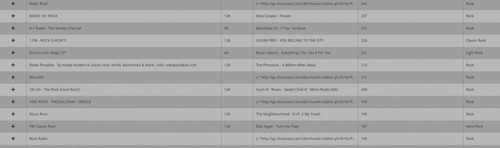

« Reply #1332 on: 2 Dec 2015, 01:49 pm »
Hi Pearlcfam
Thanks
Hi
Go to ROCK then ALL ROCK STATIONS  - then scroll down - then click on + sign and let it turn Blue.  It will then be in your list of stations when you click on BRADIO going forward.

« Reply #1333 on: 2 Dec 2015, 01:55 pm »
Thanks James
I don't see Rock on my scroll down box. It stops at electronic.
I am using Safari. I have tried arrow keys etc but it won't scroll down
Tezza009
  • Posts: 55
Re: Manic Moose (S2) - BDP's third major firmware release
« Reply #1334 on: 2 Dec 2015, 02:06 pm »
Found it! Needed to click up arrow before I could scroll down . Thanks
