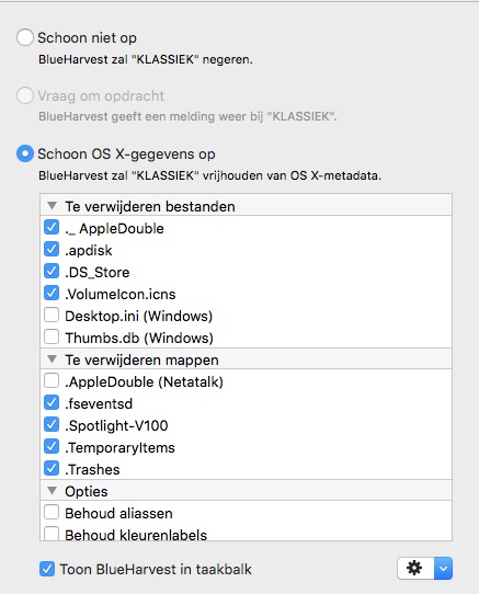

HI TJ,
you can get rid of a lot of these files, so called Apple files and its orphan files, by using Blue Harvest http://www.zeroonetwenty.com/blueharvest/ on your usb drives. Won't take out the red files that should be there but aren't indexed by MM (like album art etc) but takes out all the other garbage.
if you want to do an extreme cleanup use Tinkertool System http://www.bresink.com/osx/TinkerToolSys2.html
Both are small and cheap, and extremely useful (caution: powerful) apps.
