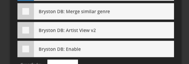

BrystonDB doesn't require (shouldn't anyways) a reboot and is required for media player features that in some way sort your music (except for file folder structure).  When the BRyston DB feature is turned on it should rebuild each time the MPD database is updated.  That message is a bit outdated, originally it was the next time you loaded the artist view, now it just starts automatically (no reboot).  When the BDP isn't connected to a NAS in its config file it will look for reasons as to why it wasn't able to connect and one of things it does is it looks at the arp tables.  If the old arp entry is still there then it will also return the old address as well.
bdp_front_44.jpg and bdp_front_250.jpg are taken from existing cover art and optimized for the media player interface.  The third, i can't remember why this file is made and havn't looked to closely at it either.

I'll do something about the buttons, but the lastfm settings are directly related to mpd, they allow mpd to report the music your listening to, to your last fm account.  Next time you login, lastfm will make recommendations based on what you've listened to.
HI Chris, if you do so, please also take out the Save button form the Last.FM section. It saves all settings on this page and not only Last.FM.
You might consider an extra step of confirmation after clicking the Clear cache button. This is a very strong command, and not to be used lightly. Also, some extra explanation is needed. A bit like on the Services page where you explain what every services does. Clicking it merely selects the service, and then an extra button issues the command.
Extra confirmation and explanation should be on all 'heavy' commands like Update, reset DB and clear cache t name but 3 ;-)

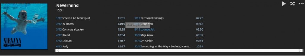

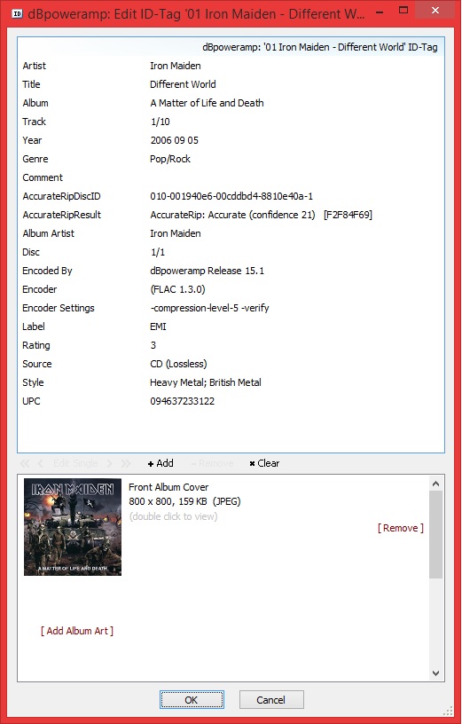

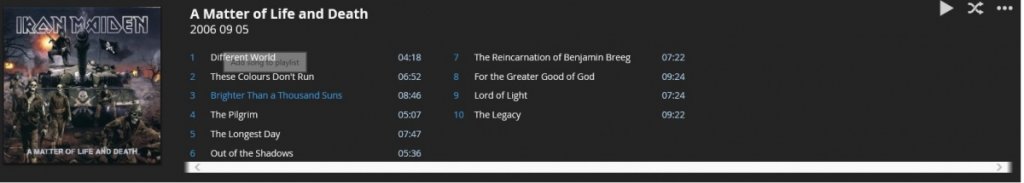

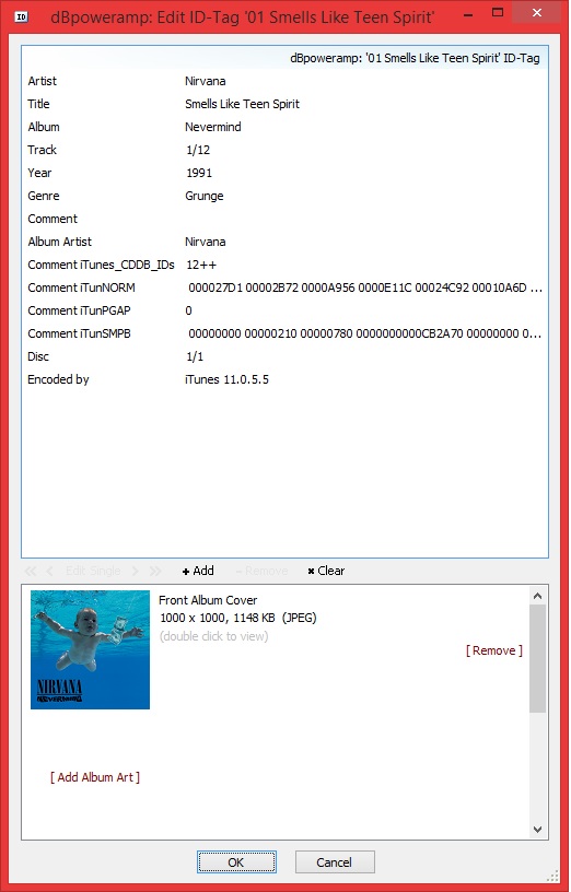

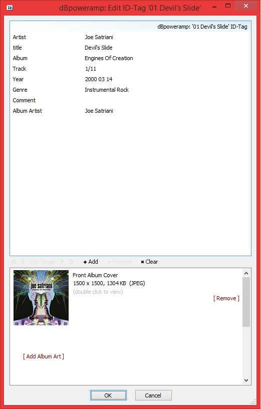

Chris, or anyone one familiar with how the BDP-2 deals with tag information, in the pics I posted on the other page any ideas why my mp3 album is displaying the song numbers as 1/11, 2/11, 3/11, etc in Artist View where both my flac albums are nicely displaying as just 1, 2, 3, etc.? As you can see the Track tags for all 3 are identical, using the 1/11, 2/11, 3/11, etc. format. It would seem for the mp3 album this is being shown as is but the 2 flac albums are stripping the /11 off. This is the only instance of this in my library i.e. all my Joe Satriani mp3 albums. I have some other mp3 albums with the tag setup the same way but they also strip the /11 off. I'm assuming it's the Track tag being used here but maybe that's not the case and there's more to it. I carefully sized my tag window screenshots so you could see all the tag information for each album.

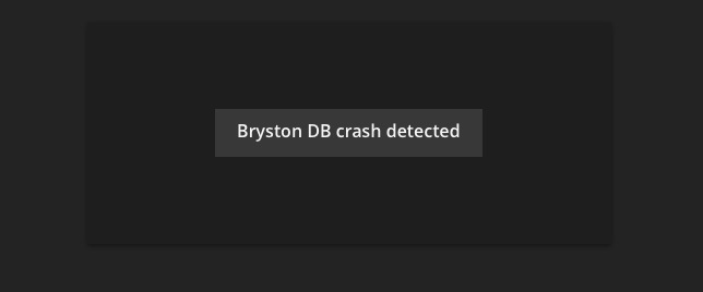

after 2 weeks of experiencing connection issues and other configuration problems to the brink of not being able to play the BDP at all, i can happily state im back on track playing my music.
Ive disabled the Bryston DB, reset it, cleared cache ea. Guess i have to wait for the BDP2/3 with bigger capacity library to use the BrystonDB.
I also experienced that Chrome somehow is a much better browser for MM than Safari....
MM does state a DB crash was detected, how could this be?
What ever might be the cause, Arturo is high blowing like never before  :thumb:
It's likley picking this numbering up in the track number tag, if you start playing a song the BDP will list the tag data in song info.
Marius
Turning off the Bryston DB doesn't delete old logs, although in this case it should remove some of these (I never thought people would be turning the feature on and off).  I think with a library your size (excess of 150,000 songs last checked) you really would need the beefier BDP2 for the Bryston DB to work.  I've been experimenting with saving the database directly to internal storage on a BDP-1, but a library of 28,000 songs goes from 5 minutes to 22 minutes to build.

« Reply #1236 on: 17 Oct 2015, 02:46 pm »
But why then is it doing it in this fashion only for the mp3 albums and not any other albums? Is there something different about mp3's because my track number tags are created the same for every album's song I have. That's thousands of them and this seems to be isolated to these mp3's.
Perhaps you should check if this is the case before asking more questions
It is, that's what I've been getting at all along, perhaps I just wasn't clear, sorry. I have 15 Joe Satriani mp3 albums and 1 Nirvana mp3 album that all show up in Artist View and all display as #/#. I have a 2nd Nirvana mp3 album along with a Black Sabbath mp3 album but those aren't showing at all in Artist view, I can't figure out why but that's another issue. I also have a couple Joe Satriani albums in wav format which are behaving the same as the mp3 track numbers but I figure if I can find out what's going on with the mp3's I'll be able to do the same with the wav albums.
On the flip side I have a few hundred CD rips to flac in the #/# track number tag format and they are consistent in displaying just the single track # in Artist View.
I guess at the end of the day it doesn't matter which is right and which is wrong I would just like to understand the behavior so I can make things consistent without having to enter the track # tags differently for some songs vs others. This type of thing drives me nuts :)
Here are more examples. It's obviously impractical to post pics of all songs so I am just showing the 1st song for each of the 4 albums.
mp3 Albums
flac albums - high res 96/24 files
Nirvana mp3
Random other flac album selection, CD rip
