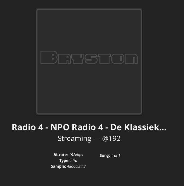

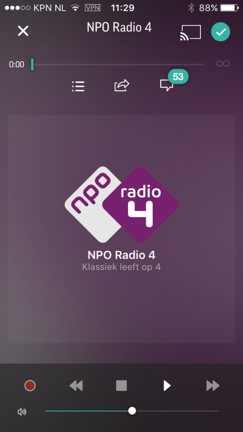

Marius
Re: Manic Moose (S2) - BDP's third major firmware release
« Reply #1253 on: 20 Oct 2015, 09:31 am »
Hi Chris,
Is there a way to get 'album art' on our playlists/radiostreams?
Ive saved several online radiostations as a playlist, (station).m3u file, and would love a station-logo to show, instead of the generic Bryston logo
something like on Tunein:
Marius
