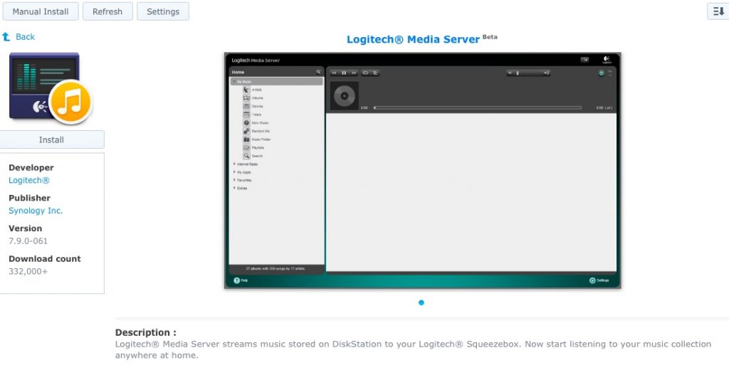

i see,
thought the renderer setting on the BDP did that. :duh:
Ill try to find it then and see what happens. This should be it?
Marius
Hi Marius
To use Squeezebox you need to have Squeezebox server installed on your NAS, where music library is. The server will see the BDP as a network player. The IOS app is just a remote control
Hope this helps

Yes, Marius, this is the server. If you use NAS there are also specific packages instead.

Ok i will dl and install. cant find the specs so let me ask you: will this support 24bit hi res flac's and wav's?
I ask because the shairplay seems not to (as doesn't airplay) and im trying to find an easy way of rendering the flags on my NAs over the BDP. And doing so, relieving the BDP of the usb tasks.

So i got the squeezelite renderer to work fine, just like the Shairplay before.
Whats missing though is some kind of visual feedback in MM and the frontpanel of what's playing. Chris is it correct that's not showing right now? if so, could you implement that?
