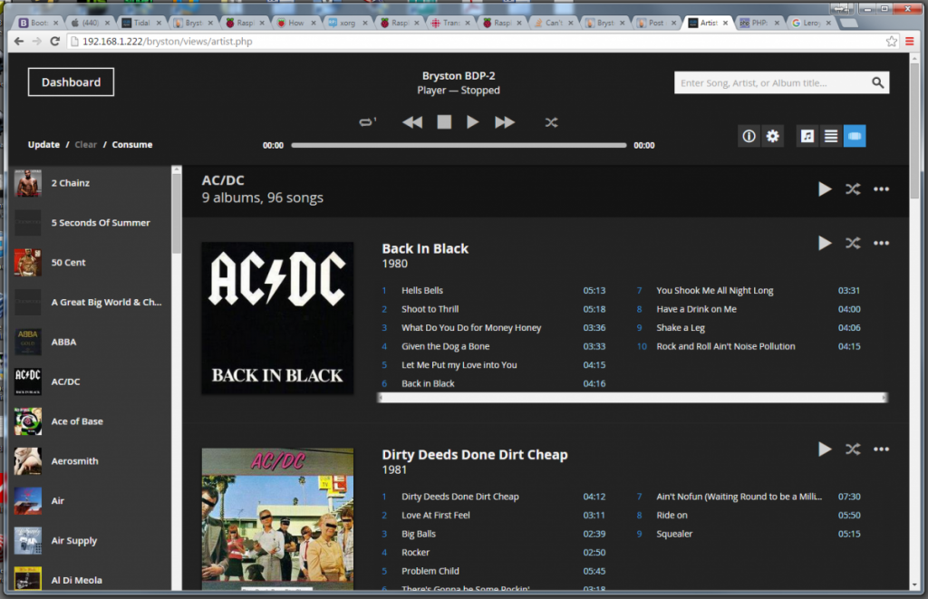

Its the artist view in manic moose media player, it organizes your music by artist
Thanks
I followed the instructions above I.e. Click the gear icon then enable Bryston DB, I clicked save and then reset DB. A message displays saying the DB will be rebuilt on next load. Not sure what that means so I forced a reboot, that didn't enable the Artist view so I power cycled the unit but still no go. I must be missing something simple.

after clicking the reset db button the BDP begins to take the MPD database and creates a second copy in the form of an sqlite database along with creating cover art optimized for the web interface.  While this is going on the BDP will report the percentage completed from the artist view page.  Something may have occurred when the BDP was forced off, you should review the video linked below and if you still continue to experience problems you should place the bdp into service mode and email me the service id.
https://dl.dropboxusercontent.com/u/86196657/Videos/BOSS/BOSS%20Intro.html
https://dl.dropboxusercontent.com/u/86196657/Videos/BOSS/BOSS%20Intro.mov
artist view is covered at the 32 minute mark
Chris

Thanks Chris, I'll give it another try, I would have definitely performed the reboot well before it would have had a chance to finish.
Chris
So I got it to work, thanks. It wasn't doing the build after clicking Update DB but rather only after I re-clicked on Artist View so that was a bit different than the instructions.
Something I just noticed though, once the DB was rebuilt and I was done playing/browsing I went to take a look at my NAS folders and when I went back the Artist view was gone and once again said it was disabled and would have to be setup again. Is this normal? Shouldn't it retain this view once built?

« Reply #1165 on: 8 Oct 2015, 12:46 pm »
Is this normal after enabling Reset DB and re-clicking Artist View?
Rod_S
  • Posts: 1096
Re: Manic Moose (S2) - BDP's third major firmware release
« Reply #1166 on: 8 Oct 2015, 12:55 pm »
Never mind, I got it to work again, had to click Update this time.

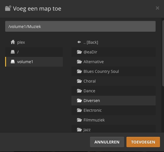

-the album art seems to be case sensitive, which i hope you can take out. cover.jpg and Back.jpg in the folder shows only cover.jpg, while cover.jpg and back.jpg shows them both, clicking on the album art.
- im trying to add a share for some nested folders on my NAS Synology. All genres are sorted under a shared folder Mp3. In MM, i won't get the box where one can select a subfolder. I thought that a shared folder would also share its nested folders, but apparently that doesn't work? I cant select these folders in the Synology software to share separately since apparently shared nested folders aren't allowed. Please tell me if this is expected behavior. If not , what to do to solve this? I could of course upgrade all nested folders to root folders, but that would destruct my full library logic. Id rather not, if not necessary.
in MM am able to select the main share, but clicking the NEXT button does nothing.
see how Plex does this easily:
Marius

It shouldn't be case sensitive, it might be filesystem related (as i have only thoroughly tested it against fat32 and samba shares) or caused by older versions of the firmware.  The next build of the firmware will have the first revision of a new tool with the intention of assisting with cover art and tag data issues.
I'm not quite following the second question.  If using the NAS Setup and you select a SMB share you can optionally select a sub folder.  The BDP will share these using its own samba sharing service, however if the BDP mounts the shares after it has already initialized the samba service you can can restart the samba service to force it to recreate share points.

Its just that i can't optionally select a subfolder. It isn't presented as an option in the extra dropdown box as shown in your video.
Chris
