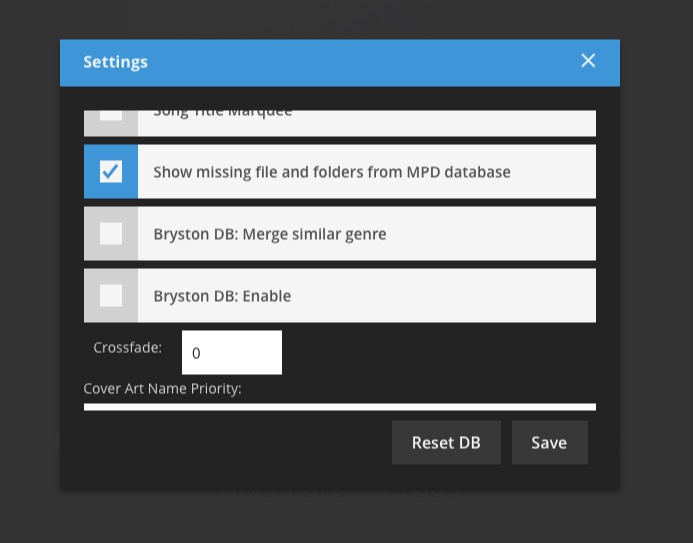

Before i click these 2 new DB options in Media Player settings, please let us know what they do (i would have thought the DB was enabled, since i am able to view, select and play tracks)
Cheers, Marius
So as mentioned in the build notes (aka README) the Bryston DB (the database that the artist view and future album view are derived from) now automatically builds after MPD is done updating.  Because the new system hasn't been tested to thoroughly, it is by default turned off.  Checking "Bryston DB: Enable" turns the feature on and you can begin building the database by clicking the "Reset DB" button.  From then on forward each time MPD is done updating the Bryston DB will be updated.  "Bryston DB: Merge similar genre" will merge genres that are predefined and currently static.  When it does the comparison it is also suppose to ignore case.  Also I have revised my 120,000 song (BDP-1) limit to 60,000 for the BDP-1 and 8x this for the BDP-2, its a limitation of available system memory.
Chris

My db is far over 60000 tracks. Would enabling this brick my bdp again?

It shouldn't brick a BDP-1, i downloaded your tag_cache and ran the new art ware against it on one of my BDP-1's.  It should error out once the unit uses up the allotted amount of system memory and the crash reporter should display a message next time you visit the dashboard and free up the system space used

'free up the system space used" is his something the system does, or I should do manually. If the latter, please let me know how.
what is the new art ware? havent found any new options for Album Art in MM, maybe i just missed these?
I'll try and see what happens then :Xn

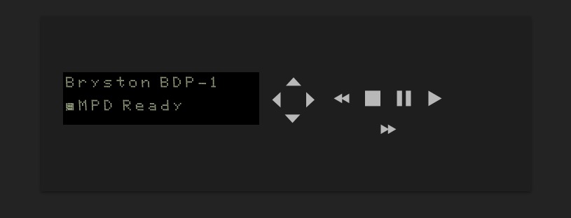

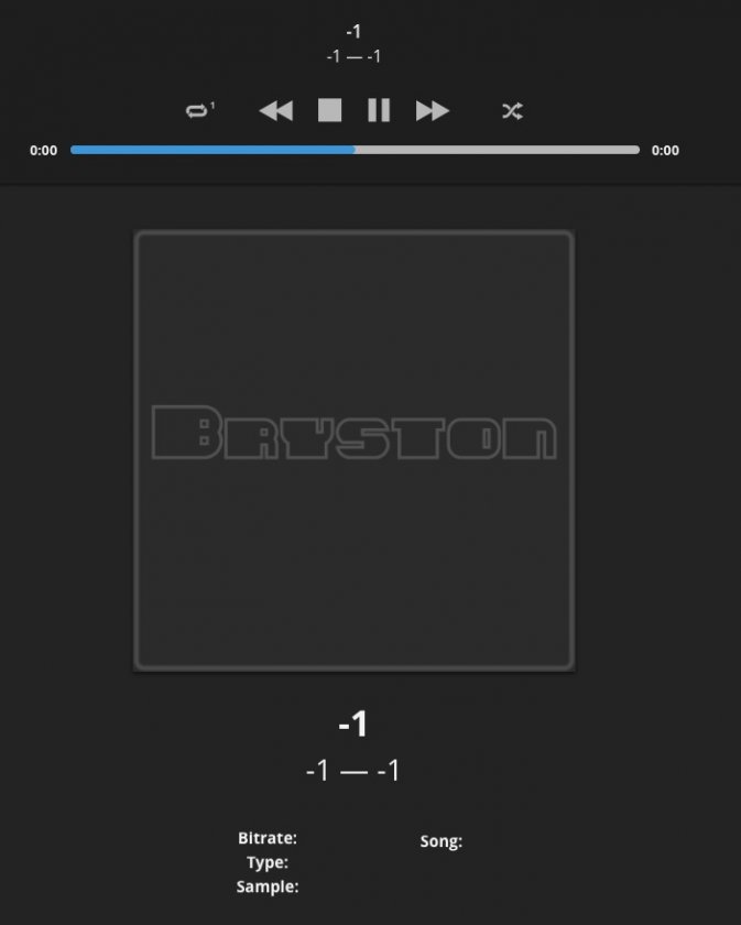

Acted as instructed: my MPD sees all music, but won't play anything. The -1's are there again.... I don't see any error message or other activity feedback for that matter. No idea if a DB is being built. Should i be seeing any MM feedback?  Might be a good idea to let the MM show some kind of activity feedback.
MPD seems to be ready

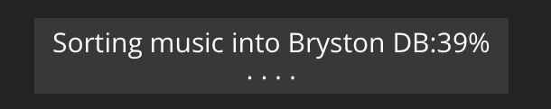

Marius problem is his library of +150,000 songs is far to large for a BDP-1 to handle and its not stating that it has failed

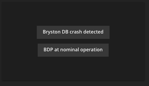

When you see that a message on the dashboard should appear "Bryston DB Crash Detected" or there abouts.  The artist page just display's how much of the library has been processed.  What you posted looks like the BDP was rebooted after a failed attempt.  To try again you would force the BDP to rebuild the database again by using the "Reset DB" button found under the Media Player Settings page.

I got this after clicking the Artist View button, not after rebooting.
Indeed i now get a Crash detection message, but clicking it does nothing but reload the dashboard, although it seems to be a clickable link (get the hand pointer). Please build in some instruction on these error messages?
my Artist View page shows a 39% music sorting, so it either is still sorting and is progress in itself, or is crashed and the screen is frozen. I dont know how to tell.
BDP still at nominal operation..... which is clearly isn't of course ;-0
Will resetting the DB start all over, a continue from where it left off?
