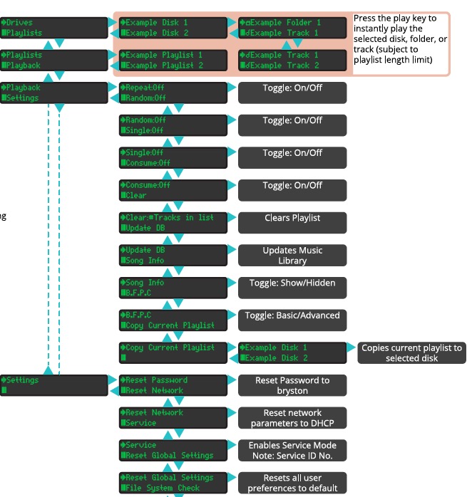

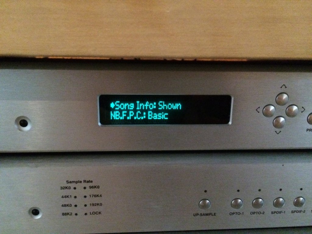

secondly: what does BFPC mean in frontpanel settings?
              And where could we change the Bryston Pw? (you offer a reset back to default bryston)
The reset password function was left in for just Incase scenario, one of the problems we had in loony loon and Canadian beaver would be the settings files would become corrupt; although I was confident that would remain fixed I figured it couldn't hurt to leave it in manicmoose.
Bryston Front Panel Controls, originally figured you guys would ask for more features regarding the controls on the front of the BDP.  So the idea was you could toggle those features using this menu, but nothing ever really came of it.
