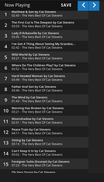

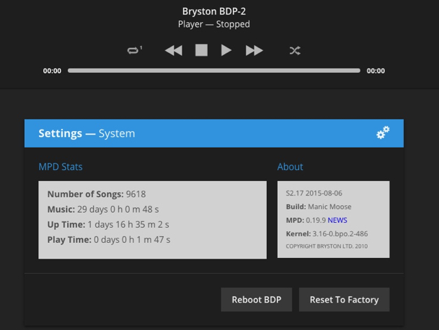

Excellent. Here's some additional input. I am running the latest BETA (S2.17 2015-08-06) and now all of my tracks within an album sort like this:
1, 10, 11, ... 19, 2, 3, ... N
If you have more than 20 tracks in an album, it looks like:
1, 10, ... 19, 2, 20, 21... 29, 3, ... M
The tracks display this way and actually play back in this order. This is a new issue from this build.
No changes to the album art missing from folders named with spacial characters (I assume this is still in-progress).

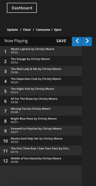

Here are samples of mine at home:
I will let Chris comment but it must be your ripping program?  Which one are you using?
james

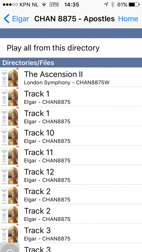

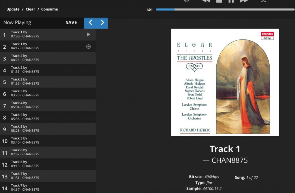

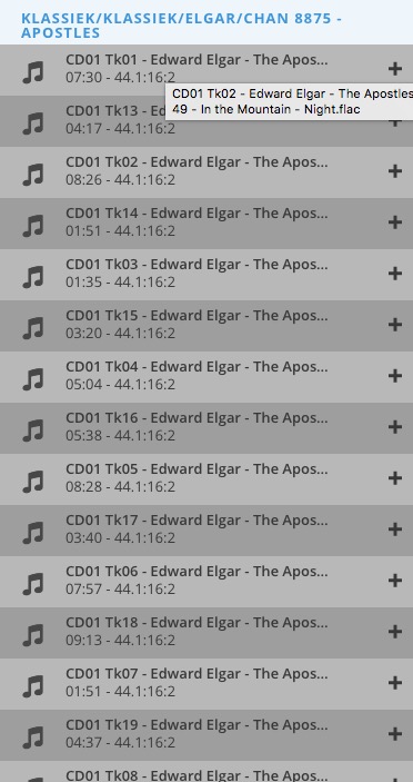

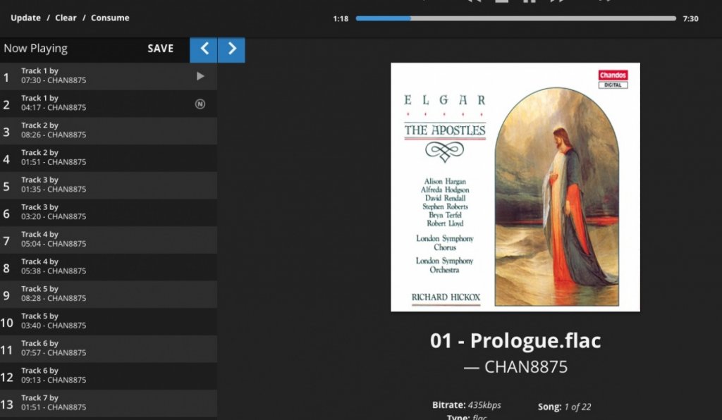

Hi,

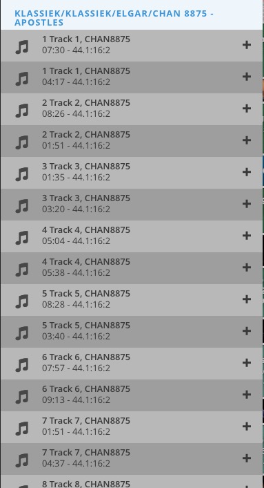

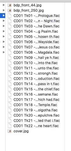

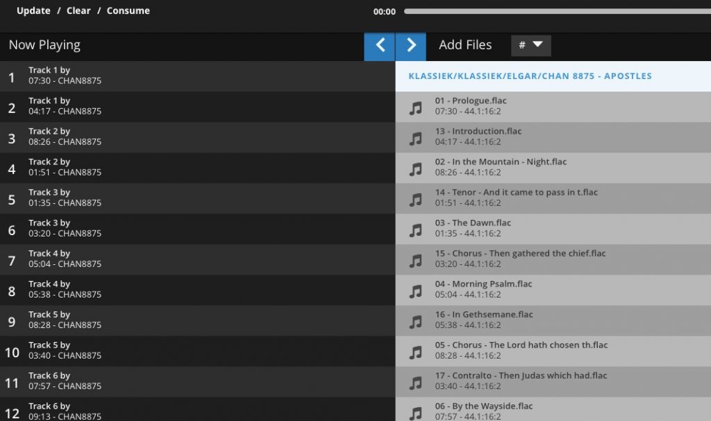

An issue that was there from the very beginning/development of the BDP in fact. On some recordings/rips. check for example this Chandos Thumbdrive of all Elgar vocal scores. I this case The Apostles. To see the real order look at the Finder screenshot.
Ive run into this on several occasions, most of the time it can be solved by numbering 01, 02, 03 instead of 1, 2 3.
Trying filenames over tag date in options might help on occasion. Not here:
This seems to be a tagging issue i cant resolve either way. Check what the BDP makes of it...
MPOD/Mpad don't behave without issues either....
Because i only now realized i hadn't changed the files names like stated above (01,02,03,04 etc) i changed them accordingly today. An even stranger result: the meaningless track titles in the playlist, and all in wrong order  :scratch:
must be the original tagging i suppose. Anyone here to know how to change that? (obviously the files in this folder belonged to 2 separate cd's joined into one folder by Chandos. Ill try to separate them again, playlist order might faal into place then)
Cheers, Marius
