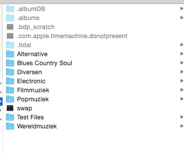

Hi Chris,
Thanks for fixing the DB crash, all back to normal again:
you state that the latest iteration: "Fixes a number of issue with the Bryston DB and removes the need of a scratch drive". The scratch drive is still there though, both on the drive, and in the Disk information  settings. Is there a way in MM to delete it, or can we just delete the files through Finder/Filemanager. And if the latter, which files to delete. .bdp_Scratch and swap, or just .bdp_scratch:
do you still use .albumdb and .albums or are these obsolete also?
Cheers (cleaning up)
Marius

Hi Chris,
Marius
tidal will still use a scratch drive for cache picture files and a swap file will still remain, but otherwise the artist view should be independent of the scratch drive by the next stable release.
.bdp_scratch designates that the drive is to be the scratch drive, once removed, restart the BDP
Marius

HI Chris,
not 100% confident i'm sure of what you're saying, so please let me be precise:
we can delete:
.albumsdb
.albums
.bdp_scratch
.tidal will remain to be used by tidal
- i do have a lot of other pictures/files in my library, ordered in their respective folders, but MM doesn't use them i think? Do one of these files relate to those picture files? You seem to imply that.
- the swapfile you mention to be used by tidal, is that the file named .tidal. If so, can we delete .swap? Or is it .swap, and both .tidal and .swap need to stay.
Sorry for this  :oops:
cheers,
Marius

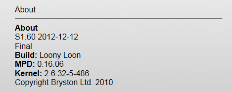

I'm having lots of grief in trying to update my BDP-2.
I connect to my BDP-2 (via IE 11), click on Update Available and then Install and I get error “failed to acquire instruction file”.
Then I downloaded the Manic Mouse bin file and pointed to it but when I click Update all I see is “UpdateWEB” but nothing happens.
My current config is:
What next?

You should be able to go from S1.60 to manic moose.  Assmuning you've tried updating more then once then the simplist fix would be a replacement cf card.  If your in North America you can get one directly from us.  Otherwise you'll need to go through a Bryston distributor.
Cheers
Chris
