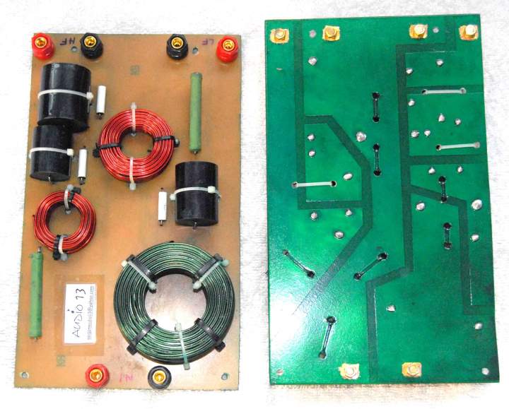

I got my N3TL crossover components assembled on a custom made Printed Circuit Board made in Vietnam especially for me.
Cost of PCB fully assembled ?
32.50 USD/each PCB.
It’s expensive considering that the Vietnamese are paid approximately 6 USD a day or 150 USD a month.
But if you take into account that they have designed and built a custom PCB, then it’s not too expensive.
With a price like that, I will use that little Vietnamese again.

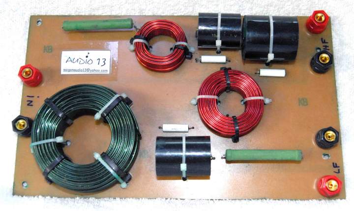

It looks like from the layout of the inductors there is some possibility of crosstalk between them as they are all in the same plane.
You might want to try some of the hints in Danny's XO build thread to minimize inductor interaction.
http://www.audiocircle.com/index.php?topic=83325.0

« Reply #7 on: 25 Mar 2011, 10:35 pm »
I was wondering how long it would be before someone commented on that!
Yep, might want to redo that a little...good link HAL.
Of course, I don't know how much that will help, given that Danny as plain as day has a 'sticky' on his forum specifically for Crossover Assembly.
Lie down before you hurt yourself. At least it only cost $30. This picture should be a helpful tip:
And this link should be a review. Here is another helpful link.
Best,
Anand.

It looks like a pretty large pcb, there may be 20cm from center point to center point.
As long as the inductors we are talking about are the same size.
Anand.

Based on the size of those Sonicap bypass caps, I'd say those inductors are no more than 1" to 1.5" apart.  I was also curious to see how long it would take before it drew a response.
20cm is just under 8" !

Right. I was thinking mm, not cm... :o
Steve
