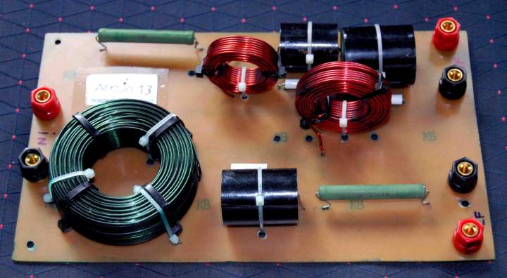

It looks like from the layout of the inductors there is some possibility of crosstalk between them as they are all in the same plane.
You might want to try some of the hints in Danny's XO build thread to minimize inductor interaction.
http://www.audiocircle.com/index.php?topic=83325.0
Hi HAL and all Audio Circle members.
I will looking more closely into that possible problem...
Thanks for bringing that up.

I was wondering how long it would be before someone commented on that!
Yep, might want to redo that a little...good link HAL.
Hi jn316 and all young and old Audio Circle members.
I was expecting some comments on my PCB layout and...
Yes, it took some time, but there it is...
Maybne I did that PCB problematic layout on purpose, to keep all Audio Circle members awake... (LOL)
Guy 13

Of course, I don't know how much that will help, given that Danny as plain as day has a 'sticky' on his forum specifically for Crossover Assembly.
Lie down before you hurt yourself. At least it only cost $30. This picture should be a helpful tip:
And this link should be a review. Here is another helpful link.

I just posted the comment as a possible way to make an improvement.   If folks look at this thread and see another XO layout that is different, at least the pointer to the sticky might be helpful.
No need to lie down, my blood pressure is fine!   :D

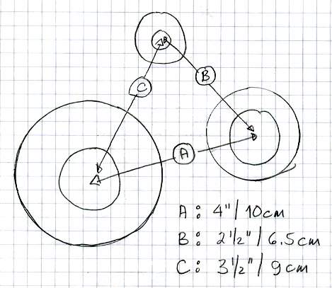

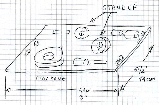

It looks like a pretty large pcb, there may be 20cm from center point to center point.
Hi dvenardos and all Audio Circle members.
With all the information above, for which I thank you all,
I now know that I can improve my PCB layout.
Find below hand sketches of what I intend to do next week, therefore any Audio Circle members that want to comment or suggest something different, please speak up or stay quiet forever... (LOL)
The above should answer many questions you have in mind.
If you have more concern and questions, please post them.
I will make the two smaller coils standing up.

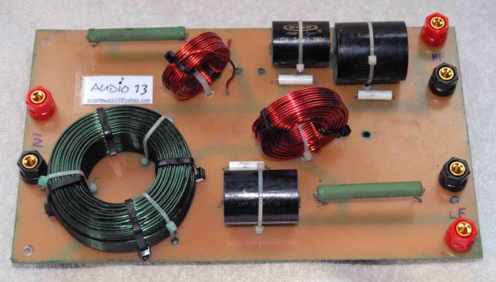

« Reply #35 on: 30 Mar 2011, 08:53 am »
Hi all Audio Circle members.
I am back ! (That was fast... My middle name is speedy Gonzales)
I did what some Audio Circle members perfectionnists suggested.
See the results below.
Who said I always do things my own way?
I do listen to suggestions from more knowledgeable Audio Circle members, well not all the time, but often...
The two smallers coils of my N3TL PCB are now standing up, however, they are still a little too close to the main coil, but I am certainly not gona scrap those two beautifull looking PCB Made in Vietnam.
Guy 13

« Reply #36 on: 30 Mar 2011, 04:00 pm »
Okay, you are getting closer.
However now your two smaller coils are just like the example number 2 in the posted graph. They are facing the same way and are pretty close.
Rotate each of them so that they are in different planes from each other. So twist them both to where if they were to roll then they would each roll right into the larger inductor. Then turn them slightly more than that to make sure that their planes are at more of a right angle to each other.
See examples here: http://www.audiocircle.com/index.php?topic=83325.0

« Reply #37 on: 30 Mar 2011, 04:01 pm »
To make that even easier, take the smallest coil and rotate it 90 degrees and you're there.

« Reply #38 on: 2 Apr 2011, 09:23 am »
Hi Danny and all Audio Circle members.
Now, is this better or does the coils need to be re-oriented again ?

Re: Custom made crossover PCB - Made in Vietnam !
« Reply #39 on: 2 Apr 2011, 11:41 pm »
Guy 13
I am no expert, but this looks better to me.
