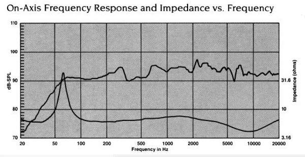

The JBL 4312A is rated at 8 ohms nominal, but it's impedance doesn't dip too much lower in the lower frequencies.  The impedance graph shows it reaches its minimum of 3 ohms between 5KHz and 10KHz.
The Virtue TWO.2 is rated at ~ 44W/ch @ 8 ohms and 87W/ch @ 4 ohms with the 130W supply.  I would also venture to say you would probably be happier with a tube amplifier with 30W - 40W per channel.

Steve you always have great stuff....I never knew how to read the graphs or what they meant but your post flipped the switch in my brain, I'm dim...but I see whats happening now, speakers present more of a load to an amp (lower ohms) when trying to recreate lower frequencies..correct? So when a speakers nominal impedance is 8 ohms thats like an average as the "ohmage" fluctuates depending on how much work it takes a particular speaker to recreate certain freqs. Am I right in thinking that a passage in a song that has alot of low end drives the ohm load say from 8 down to 4 because its harder to reproduce those freqs??
If so, then I am officially smarter now then 10 minutes ago... :thumb: or not... :thumbdown:
Maybe not!  Certainly some speakers have lower impedances with lower frequencies, but this particular speaker has a fairly even impedance around ~ 6-8 (?) ohms througout the low frequency range, except for a higher impedance peak of > 30 ohms between 50Hz and 100Hz.
This speaker then reaches it's lowest impedance of ~ 3 ohms just before 10KHz.
Steve

The graph looks like the speakers are relatively easy for a tube amp to drive, although the phase angle graph would help as well.
