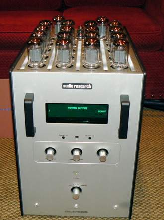

Eclein, I also agree you should have some power in reserve.  May I recommend a pair of the Audio Research Reference 610T monoblocks with 16 X 6550C output tubes and 600W per channel (@ 16 ohms - not sure what the power output is at 8 ohms)  ;)
Steve
I have heard those Amps before driving some Wilson Sophia's. Lots of tube power there 8)
I can not add any scientific methods to your query, but I can tell you that speaker efficiency and impedence are very important as you have found.  A good push/pull amp EL34 based will give you plenty of power and drive/ with the Tube Magic in a good designed Amp. :wink:
I'm with you I for one will not go without tubes in my system somewhere.
Good Luck
