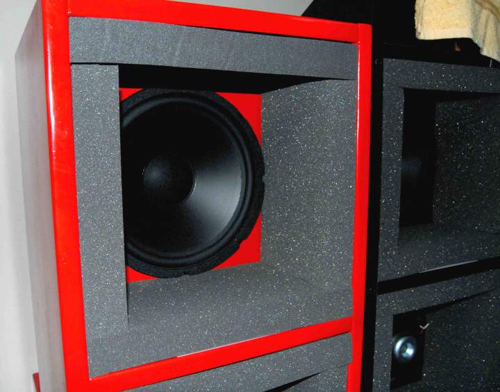

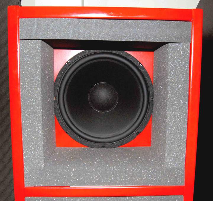

Hi all Audio Circle members.
It's me again !
This time, I took pictures of the dense Made in Vietnam foam that I found here in Saigon and that cost so little that they almost pay you to take it. (Ha, ha ha...) With only 15 USD, I bough enough pre-cut foam to do two V2 front and back.
Of course this is not Danny's NoRez, but for now, it will do. Tomorrow I will do a test with the two V2, one with and one without foam to try to ear the difference in sound. Do you think I will be able to ear a (BIG) difference ?

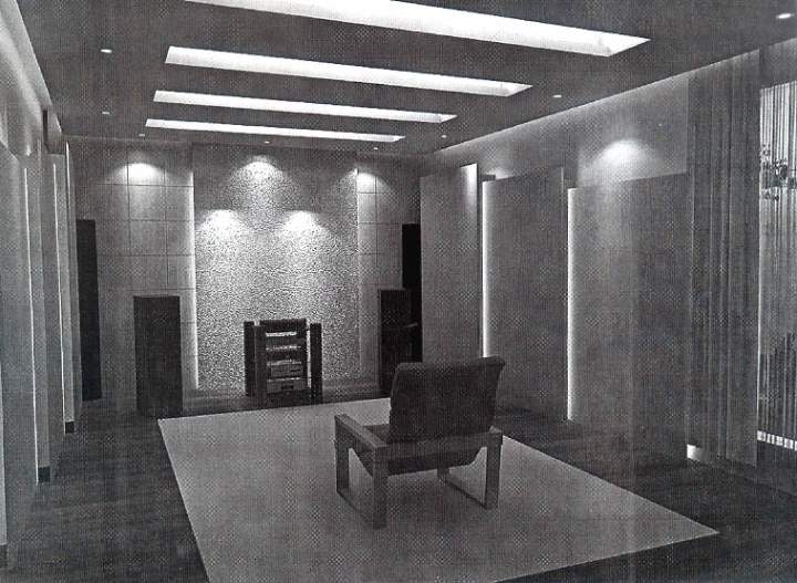

Hi (Again) all.
Ideas for my next listening room.
You are welcome to post any other ideas and especially pictures.
A picture is worth a thousand words...

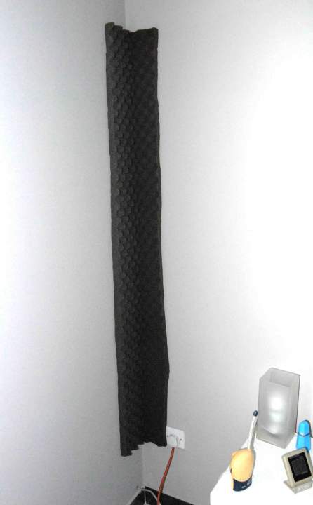

For the corner's (Bass) traps, I was wondering what would be the best way of doing them, the way that gives the best results. I can get the corners rounded with cement, since all the walls here in Vietnam here build with soft bricks covered with half an inch of cement, then covered with some plaster. I can also round the joint where the wall and ceiling meet.
As usual, I have plenty of crazy ideas and here's one of them.
How about putting some soft foam (Egg shell) in the corner with 6" on each side, of course with a decorative wood border/frame. Would that eliminate the standing waves? Is that the purpose of the trap?

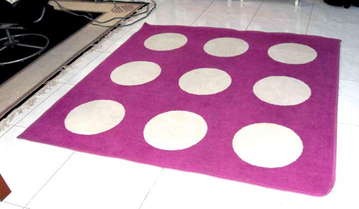

For the absorptive panels? How about a decorative IKEA carpet (Or any thick rug) glued to a 3/8” plywood board and screwed on the wall?
Can that work?

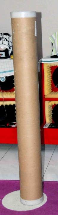

Now, for the reflective material.
I have many heavy duty carton rolls/tubes which are 9” in diameter by about 5’5” high. If I cut them in two on the length and stick them to the wall with the curved section toward and behind the V1, I wonder if that will work? Any one has tried something like that?

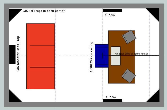

My 1st thought was maybe stuffing that cylinder with fiberglass but that's probably as available in Vietnam as palm trees are in Palin's Alaska.  :lol:   But here's a pretty good diy website that's right up your alley for what you'e doing. The site is from of our own bpage. Bryan would surely have lots of diy ideas for ya, and he also represents the GIK room treatment that you have labeled in your drawing.  :thumb:
Robin
jtwrace
  • Posts: 11430
    • TIPP YouTube Channel
Re: The new winner is: V1 (The winner is: V2)
« Reply #135 on: 19 Nov 2010, 12:27 pm »
I highly recommend Bryan & Glenn from GIK.  If you want to diy, Bryan's site is great too.
Great stuff Robin!

The tubes can work OK to break up flat surfaces.  Don't expect them to go very low and they'll reflect most upper mids and highs.
Felt on board will do pretty much nothing below a few kHz.
In the corners, I'd strongly recommend not rounding them.  They're still corners and this just makes them harder to treat.  The foam will get rid of a little honk but do nothing in the lower frequencies.
