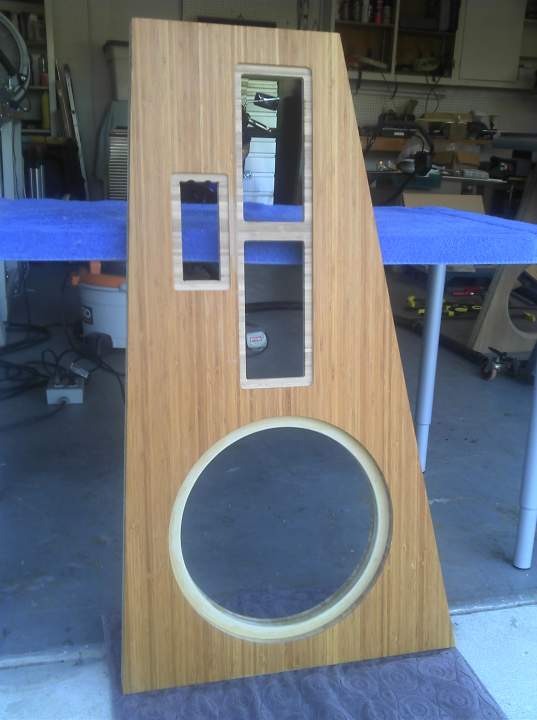

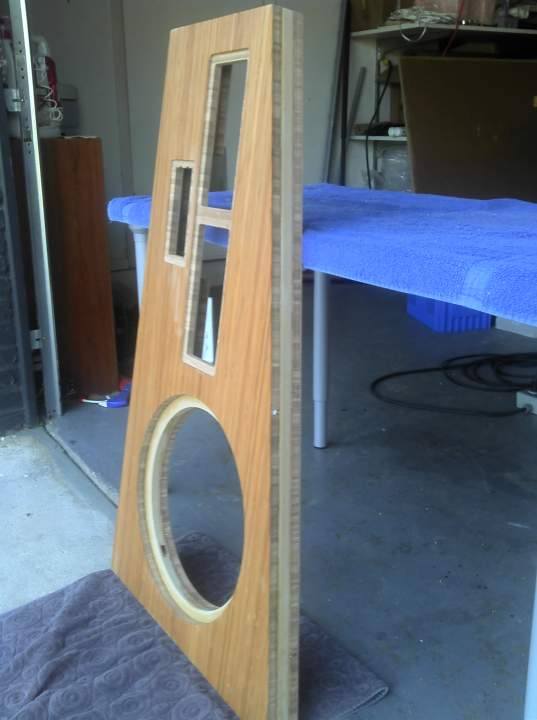

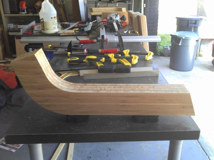

« Reply #81 on: 23 Apr 2011, 01:45 am »

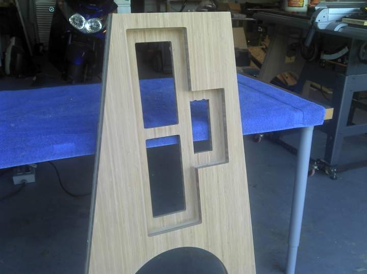

Got some more done.  One baffle glued up.  Second done this weekend and then back to the woodshop to get the roundovers routed in and the rear leg cnc'd out of more bamboo.
As it stands right now, the lamination of Bamboo/mdf/bamboo is significantly stiffer than the plywood laminted prototype.

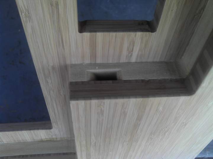

Last pict shows the opening of the wire channel beneath the tweeter.  This keeps a nice, clean appearance on the back side with no wires showing until they terminate at the drivers.  There is one down low for the woofer too.  I will be using a Neutrik NL8 screwed in right over top of the routed wire channel for connection from the Digmoda amps.

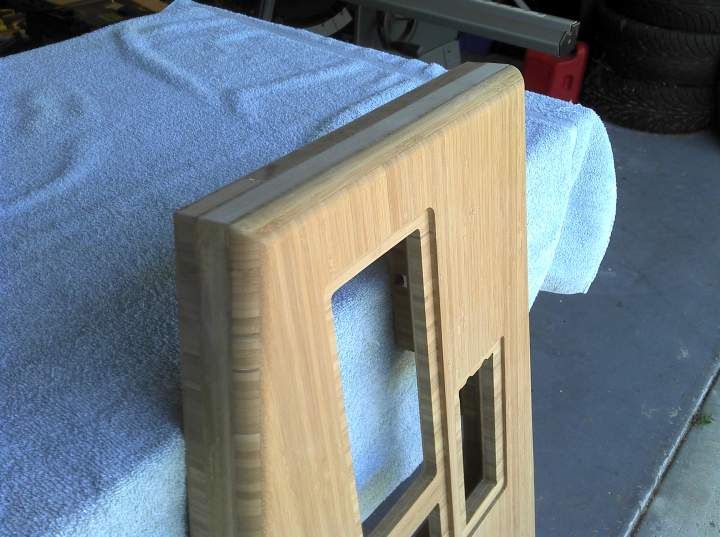

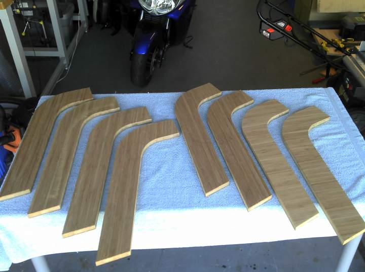

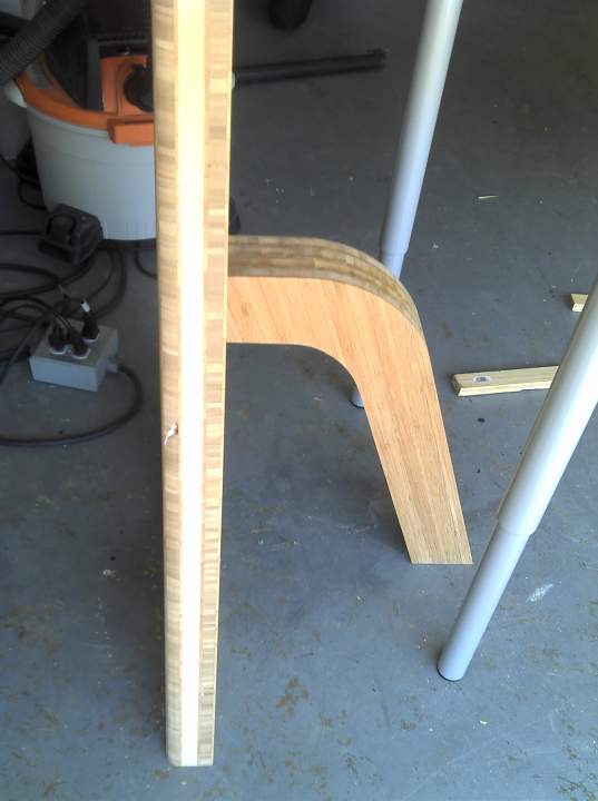

Good and bad news today....

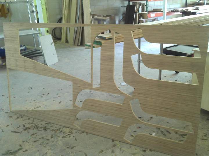

Good news, is that I finally got back to the CNC shop to get the 4th layer of the baffle cut and the rear support leg.
Bad news is that the guy programmed the machine to cut INSIDE the line rather than outside like last time.  New pieces are now 1/4" too small all of the way around. Grrrrrrrrrrrrrrrrrrrrrrrr.   :evil:
Not concerned that the support leg is thinner, but the rear of the baffle is going to be a problem.  That is a lot of wasted $$$ bamboo plywood right there.  I have one more sheet left, but was hoping to use that for 2 pairs of studio monitors for clients.  May just make the rear piece of out something else now.  I'm sure I could get the guy to throw in a perfectly good piece of baltic birch and more machining time after that big of a screw-up.

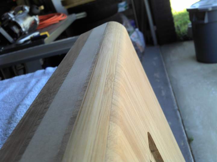

Here are some picts of the progress so far.  I also got the 1" roundovers done on the front side of the baffles too.
Greg

« Reply #96 on: 8 May 2011, 07:36 pm »
Looking at what's left of the sheet it would seem that 1/4" outside of the line would have left no material between cuts, or next to none. Could this even have been do-able?

« Reply #98 on: 8 May 2011, 07:54 pm »
Yes, there was room.....barely, but it would have worked.  I'm sure whhat happened.  He even asked me if all the cuts were to the outside of the lines, but then did not set it correctly.
Greg

« Reply #99 on: 8 May 2011, 08:02 pm »
Beautiful job with the radiused edges on the baffle. I am very jealous.
