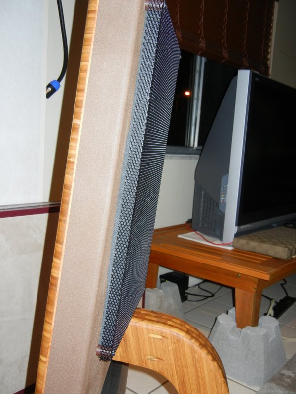

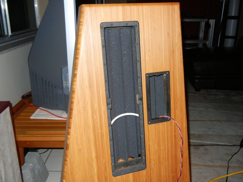

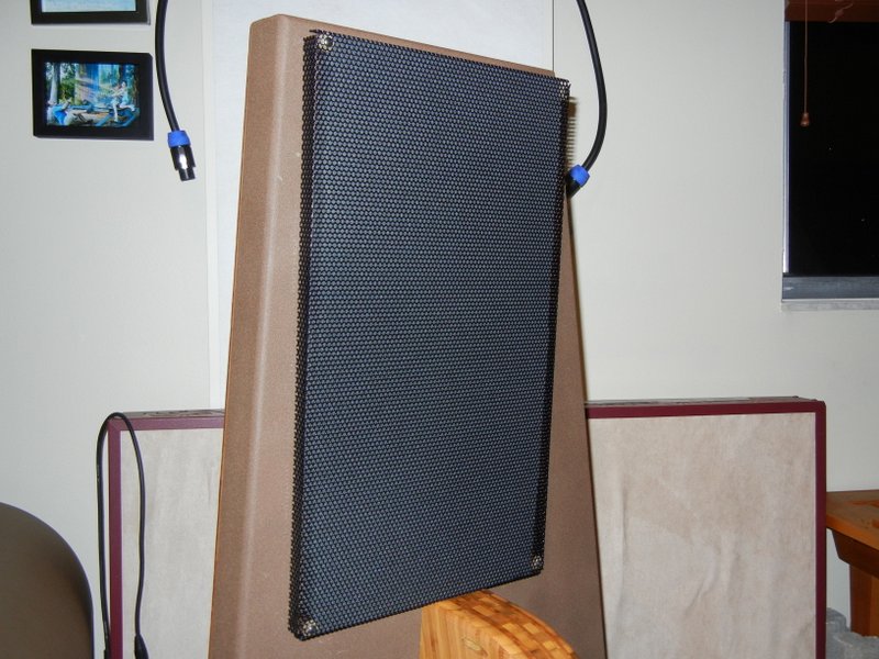

My Digmoda are still being used at the studio, so no measurements to report yet, but I got the rear grills installed finally.  Just some thin, basic foam in there more to hide the wiring and rear of the drivers than really try to absorb anything.
