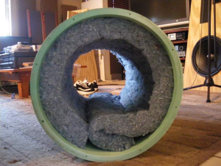

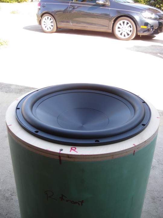

The PVC is for the Rythmik servo subs that will augment the Dipole 15s below about 50Hz.

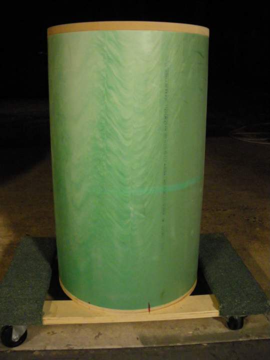

What is the PVC pipe? Sewer pipe?
studiotech
Re: Raal 140, Neo10, AE Dipole 15 in the works
« Reply #44 on: 27 Nov 2010, 07:38 pm »
Yes, this is schedule 80(thicker wall than 40) PVC pipe.  Much stiffer than any sane box and easier than making a good box.  I will be working on getting these pieces prep'd tomorrow to fit in the drivers and servo amps.  The amp JUST fits with about .5" to spare on the sides.

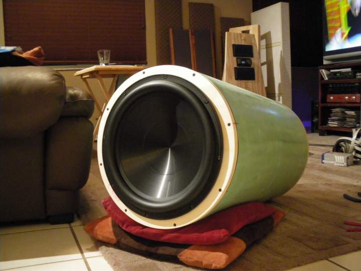

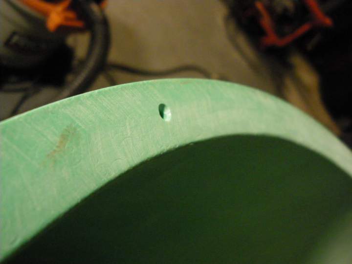

Sub tubes are getting close to being playable, if not cosmetically finished.
Greg

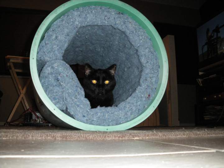

OK, got one done.  Cat approves too!
face
« Reply #48 on: 6 Dec 2010, 02:36 am »
Cat approves too!
That would change quickly if you were to power it up with him inside.  :icon_twisted: :lol:
studiotech
« Reply #49 on: 6 Dec 2010, 02:41 am »
I hope he's not in there after I sealed it up!   :o

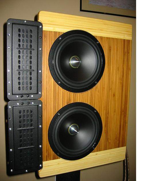

Slow. Build has kind of come to a halt with work travel and holiday prep. Plan is to hit it again after New Years and get the bamboo plywood over to the cnc guy for precision cuts. Thanks for checking in....more soon.
Greg
studiotech
« Reply #55 on: 7 Jan 2011, 12:24 am »
Bamboo ply ordered from these guys today!
http://www.calibamboo.com/bambooplywood.html
3/4" carbonized vertical grain.  Got samples from several suppliers and their quality seems the highest.  Pricey, but so dense and won't require veneering OR painting, so price is not too bad once you consider those factors.

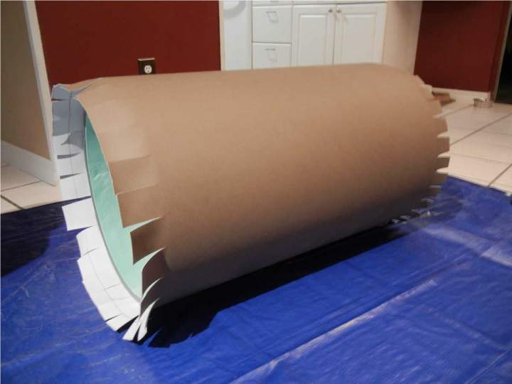

Got the vinyl.  Started applying tonight.

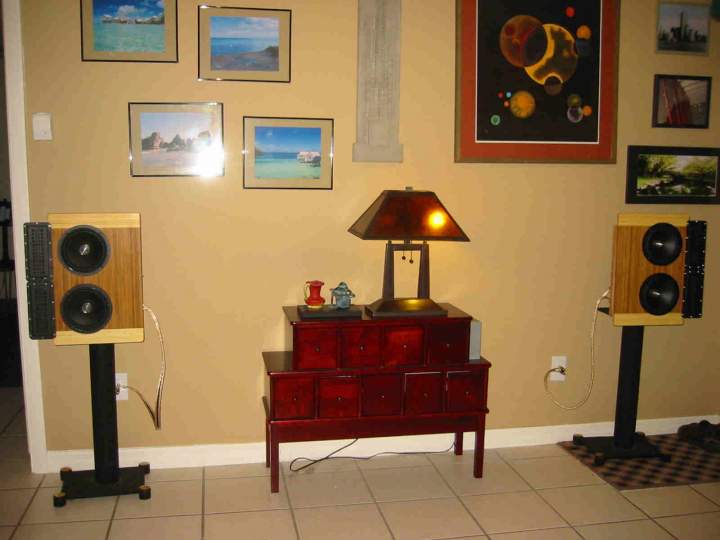

Some prior bamboo speakers used as my surrounds.
