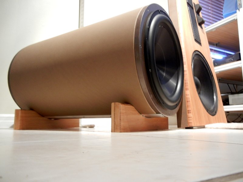

One item off the list.  I got help earlier than expected.  The move across the room is complete.  The baffles are now only 2ft out from the wall where previously they were 6ft.  Hope I can make this work out with the Mondo traps and some other broadband absorbers behind and around them.  Don't forget, I am using Bonded Logic directly behind the Neo10 anyways, so mids are more or less cardioid.   The closest side wall is now 7-8ft rather than right next to them before.  Who says side walls don't matter with dipoles?  That's hot steaming BS.  If you've ever measured one, you would know that there's still plenty of sound between 45-60 deg off axis which illuminates the side walls.  Listening position is now at 8fh rather than 10ft prior, so closer in should be better too.
If this works out, the next step will be to get a slim LCD mounted in front of the window and relocate the rack well off to the right side where the maroon curtain hangs which is back to where it was originally.  That big ass rack is great, but causes a nice fat obstruction right between the speakers.  IF I get that thing out of there, we might really be on to sonic nirvana.  I think I would mount the LCD from wire rope kind of floating from the ceiling.  That would look sweet.
The system looks great here, BUT the flow of the whole living room sucks now.  Not sure if better sound can win this one out....to be continued.
