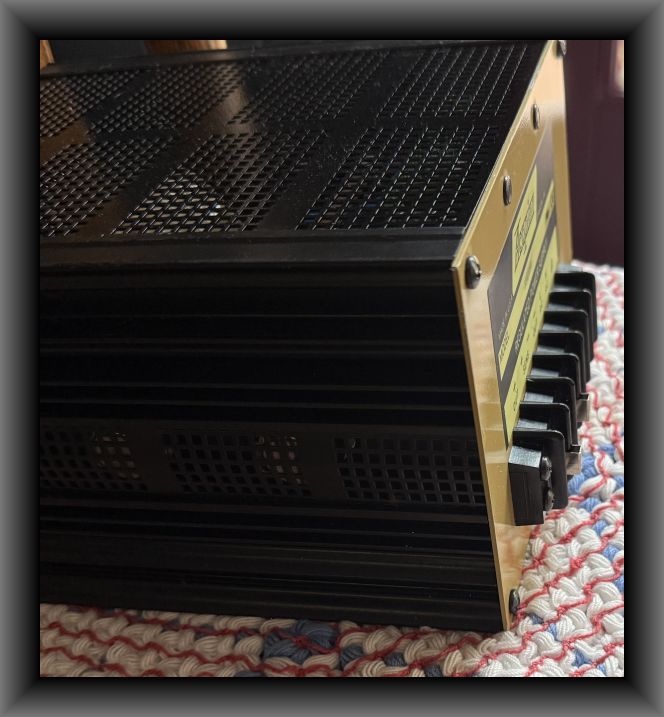

My assessment, between a GaN versus LPS power supply. LPS wins hands down!

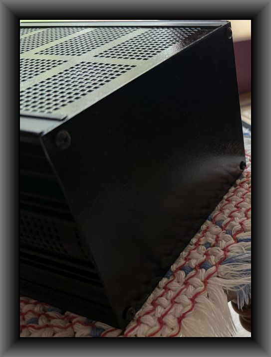

They do not require modifications, but you may need to buy a cover plate for the terminal blocks, from either Acopian or make your own.
Ring terminal connectors are a good option too. Now a days, there are some really high quality ones online for sale.
The bottom of all three LPS's  have 8-32 Screw holes on bottom of chassis. They have no rubber footing support, since their used primarily for rack mounting. Here are two options, budget rubber feet, or audiophile grade sorbothane rubber feet.
