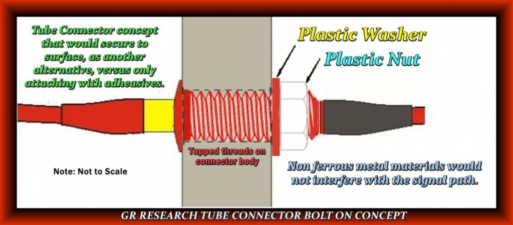

For me, it's either tube connector or KLE banana plug on the speaker cables. Currently have tube connectors on there but they stick out like ½". Not a surprise there though. I did pull those plastic nuts for now.
As for adhesives to secure everything, I sell auto paint and body shop materials for my day gig. I have stuff at home that could glue two pieces of sheet metal together where you'd rip the metal apart before the adhesive lets go. The way I figure, if it's good enough to glue a car back together, it's strong enough for audio. Lol.

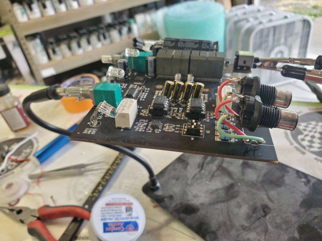

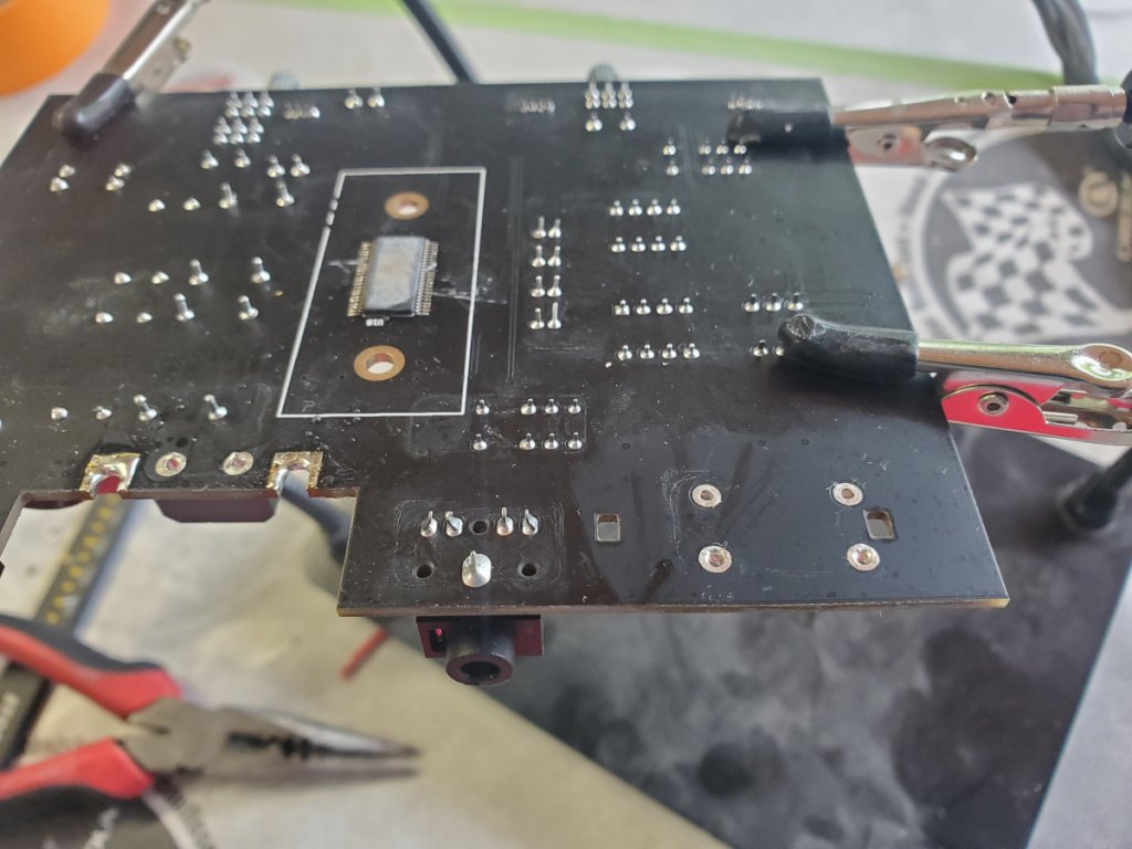

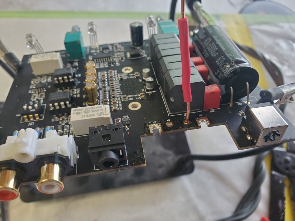

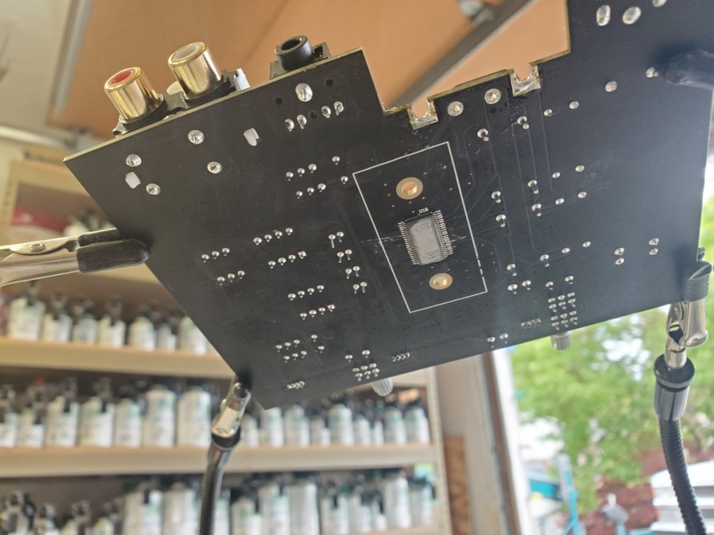

So I got bored this morning and busted out a soldering iron. First off, if you go to mod, do yourself a favor and remove ALL the hot glue from the binding posts before attempting removal. I literally had to bust out a cutoff wheel to get the last one. PITA. Secondly, the underside does have some thermal paste going from the pcb to the case. If you go to tear it apart, make sure you have some laying around. Any computer geek probably has 2 or 3 tubes laying around...
Underside of board to show thermal paste heat transfer spot.
Next up, when you disassemble, the ground speaker terminal is just a solder filled cutout, and the GR Research solid core wire does fit in for the positive, but barely.

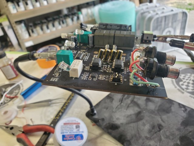

Next up for disassembly was the rca plugs. Seriously, F those things in the A. Holy balls. The crappy lead free solder they use needs a SUPER hot iron to flow (I had to double up like red hot tweezers). So make sure your iron is super powerful. Once those finally removed, I installed the KLE connectors with some VH Audio airlock cable.
Once those were soldered on, the backplate pops right on. IF given the opportunity, ream out those RCA holes a little to the outsides as it'll allow a little more space for your cables to not pinch.

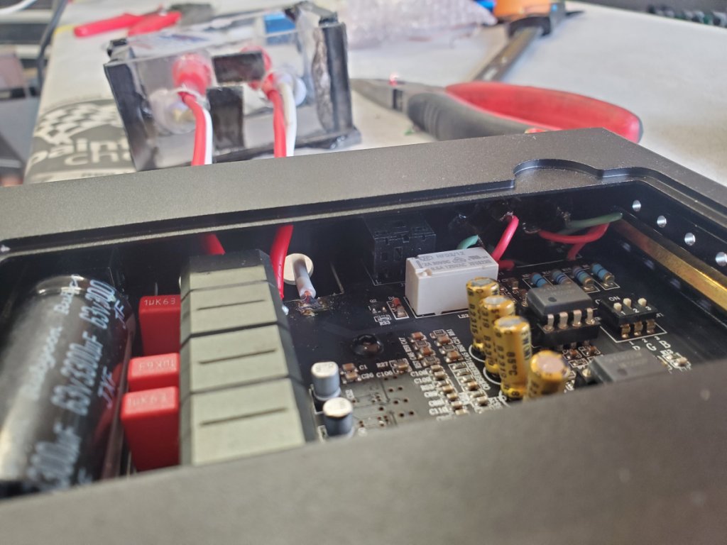

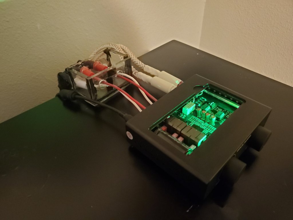

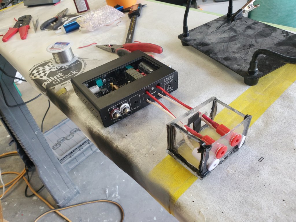

Next was installing the tube connectors in an ancillary box as proof of concept. I'll go back and make things flushed up and pretty later. I oversized my drill holes a little and bobbed on a dollop of hot glue for temporary security.
Aaaaand done for now. I'll bust into it more next weekend when caps and opamps arrive. If you notice the little 10uf50v caps standing up right next to the opamps, those suckers are what's getting replaced.
Also thanks for the link to power supply. I'll pick one up soon.  :thumb:

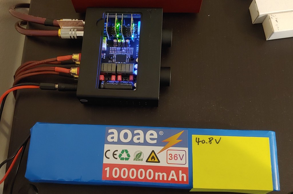

You should try batteries on the Douk A5 along with your Battery-powered Dodd preamp!  Off the Grid  :thumb:

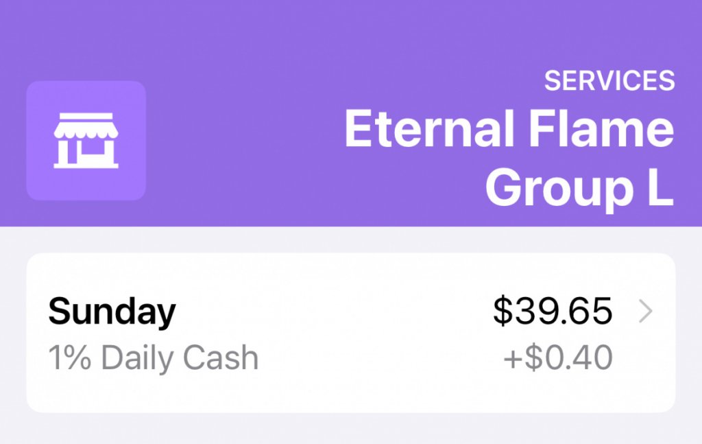

I think you are right about that being a scam. My CC showed this for the charge:
