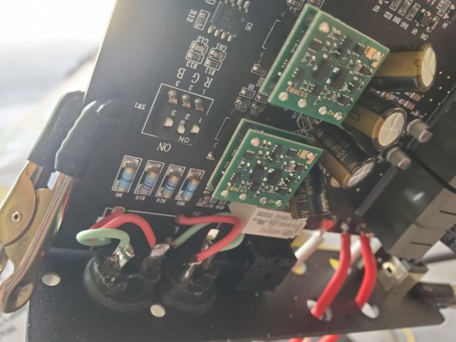

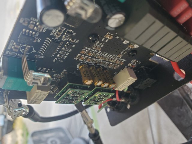

Finally got around to popping these Nichicon Muse caps into the Douk. Pretty easy to wiggle these out of the old spot, suck out the solder, and wiggle the new boys into place.
Old caps all content and lazy
New caps ready to get some work done.

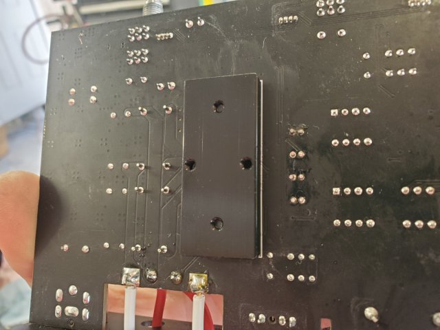

While I was in there, I also redid the thermal paste on the bottom. As you can see, just to the right next to the thermal transfer plate is the line of capacitors to squeeze in.
Now, these KZ caps do fit into the old pcb holes, but barely. It'll take a little wiggling and possibly a soldering iron if there's any leftover solder reminants still in the holes.

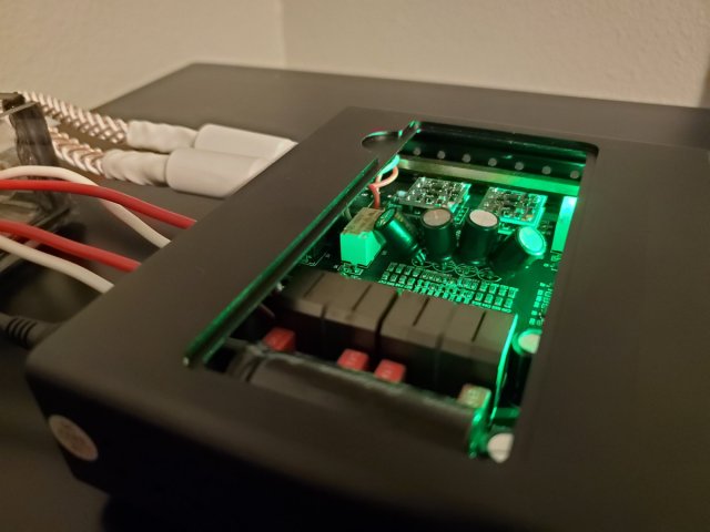

Ready to rock!
Also while I had the soldering iron hot, I popped in some Miflex 0.15 high pass caps in my preamp (between out1&out2) and they seem about the same value rolloff point as the Douk cranked but much more clarity.
So yeah, long story short get your soldering iron out and freakin go to town. Super easy mods, but SO SO SO much better. Like seriously, I'm listening to Dave Matthew's "The Gorge" and it's just amazingly huge and spacious sound. I'm here giggling to myself typing on my phone right now.  :thumb: :thumb:

Btw, how on earth did you solder those caps on? There is barely any room.
nlitworld
  • Posts: 2722
Whenever working on thru hole boards, always try to solder from underside. Easy peasy. They're the super narrow double row right next to the heat transfer plate.
