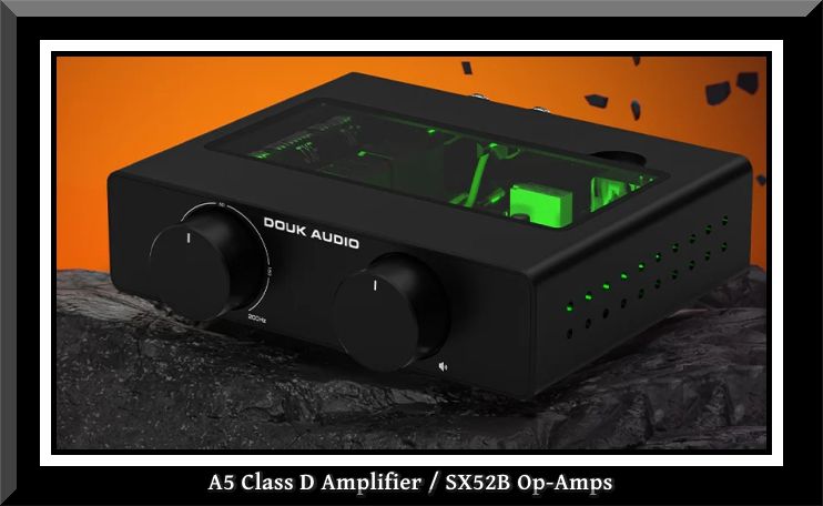

Douk Audio A5 is a welcomed product in the household.
Through a couple of years experience using a Douk Audio A5, I've determined this Class D amp out of the box sounds pretty good. However, it has the potential to really turn into something quite special in audiophile performance. Reading on you'll get to learn about various upgrade options, people chose sharing their experiences.

NXSTUDIO-DRUMMER
  • Posts: 300
I've heard and read favorable reviews on a SX52B OP-Amp. I personally own and highly recommend.  :thumb:
