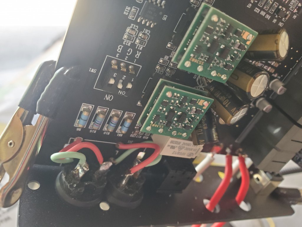

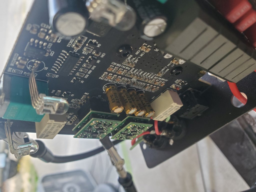

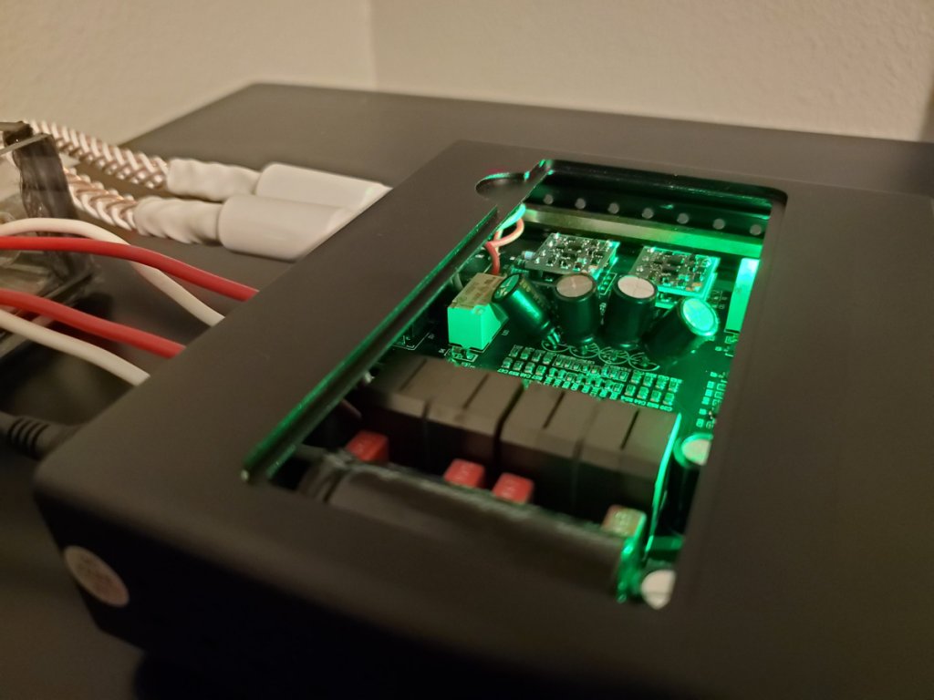

Finally got around to popping these Nichicon Muse caps into the Douk. Pretty easy to wiggle these out of the old spot, suck out the solder, and wiggle the new boys into place.
Old caps all content and lazy
New caps ready to get some work done.

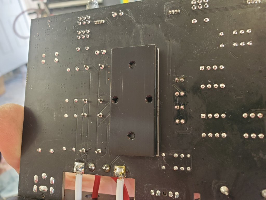

While I was in there, I also redid the thermal paste on the bottom. As you can see, just to the right next to the thermal transfer plate is the line of capacitors to squeeze in.
Now, these KZ caps do fit into the old pcb holes, but barely. It'll take a little wiggling and possibly a soldering iron if there's any leftover solder reminants still in the holes.
Ready to rock!
Also while I had the soldering iron hot, I popped in some Miflex 0.15 high pass caps in my preamp (between out1&out2) and they seem about the same value rolloff point as the Douk cranked but much more clarity.
So yeah, long story short get your soldering iron out and freakin go to town. Super easy mods, but SO SO SO much better. Like seriously, I'm listening to Dave Matthew's "The Gorge" and it's just amazingly huge and spacious sound. I'm here giggling to myself typing on my phone right now.  :thumb: :thumb:

NIGHTFALL1970
Very cool Lloyd!😎🤟👍😊
Today I played Rush- “Subdivisions”, then popped in new SX52BS and WOW!!!🤩 Holy crap what a difference!!! Night and day! I had the volume at 47 and then had to turn it down to 40 because it was so much louder! The soundstage opened up and it sounded like a veile had been lifted. I thought that it would make a small difference at best.
Btw, how on earth did you solder those caps on? There is barely any room.
nlitworld
  • Posts: 2906
Whenever working on thru hole boards, always try to solder from underside. Easy peasy. They're the super narrow double row right next to the heat transfer plate.
I will be excited to let everything burn in for a while. I know things are only going to get smoother from here

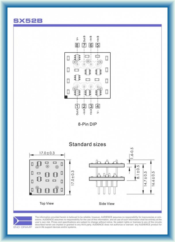

SX52B op-amp is another one to enjoy rolling with your op-amp collections.  :thumb:

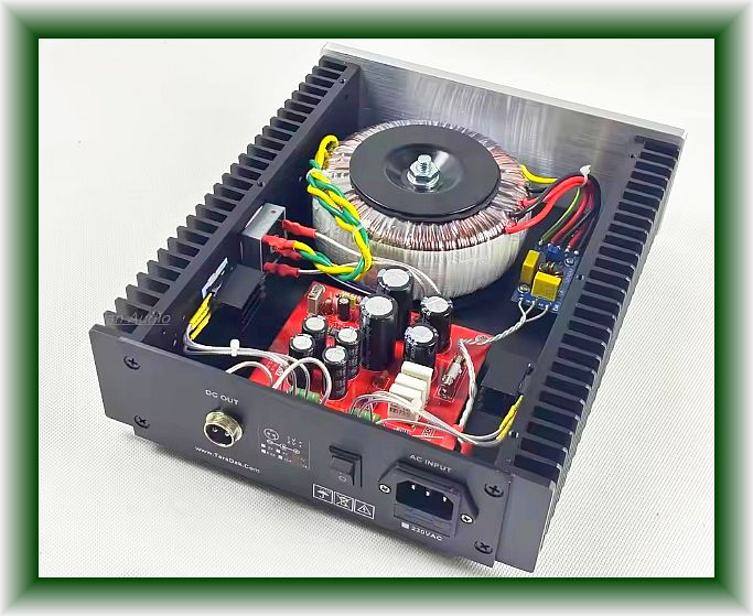

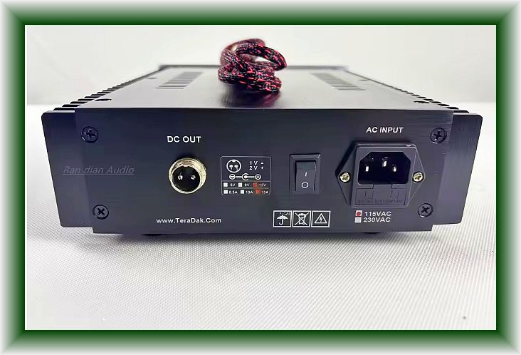

If your interested in cleaning up your signal between your router-streamer playback device.  My little Acopian A12MT400 Regulated Linear Supply, makes a difference.
Benefits by:
Lower noise floor
Improved digital timing, creating improved soundstage and more punch.
Reduced EMI/RFI Pollution Lower Noise Floor, Darker background silence.Improved Clarity, Better resolution in the midrange and highs.Better Imaging, More precise spatial location of instruments
Router running cooler, even upgrading to a higher quality ethernet cable will be beneficial.

Regulated Linear Power Supply is the way to improve the performance of a the A5.
« Last Edit: 4 Jan 2026, 05:24 pm by NXSTUDIO-DRUMMER »
