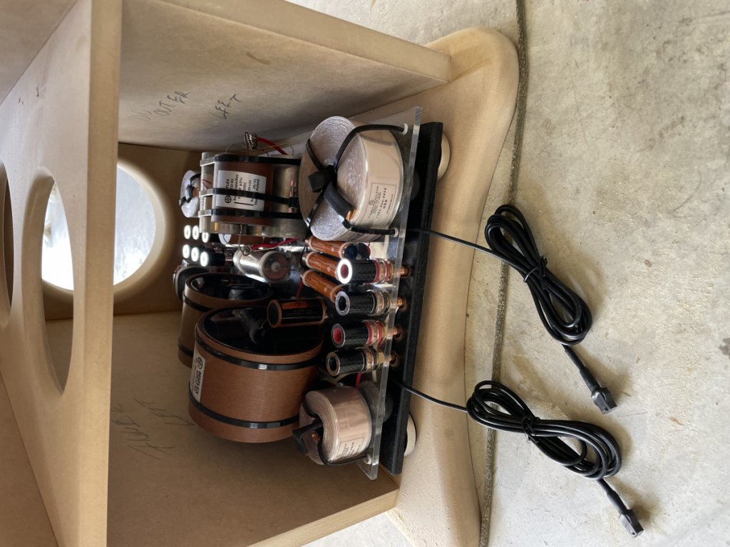

I appreciate the kind words.  I used rhodium plated copper posts to try to minimize the loss.  I have really nice cables that utilize banana plugs that wont fit in the electra connectors.
I have some Anticable speaker wire with the "Z-plug" banana connectors.  They were are a very tight fit into a fresh tube connector.  What I found was that after inserting the Anticable banana connector, the female part of the tube connector expanded a bit.  Now when inserting a male tube connector into that same female tube connector, it is no longer snug fitting.  Point being... the female part of the tube connector adapted to the very slightly larger size of the Anticable banana. "Banana" is supposed to be 4mm.  I haven't taken my calipers to them to see which ones are a bit small / large.
Huskerbryce
  • Posts: 138
Re: Well, I pulled the trigger on building a pair of NX-oticas
« Reply #23 on: 10 May 2024, 03:12 pm »
I tried to fit the banana into the electra tube connectors and pushed hard enough that I was afraid I was going to break something so I abandoned the idea of using the tube connectors.  I decided to try some higher quality rhodium plated copper binding posts.  Hopefully they work without too much signal/electrical loss.  Not sure there is any real way to ever know.
I suppose I could cut the ends off.  Then, hard solder them to the inputs of the crossover.  I think both destroying the look of the nicer cables and ruining the look of the crossover, for what is likely a very negligible difference, would not make much sense.

I appreciate the kind words.  I used rhodium plated copper posts to try to minimize the loss.  I have really nice cables that utilize banana plugs that wont fit in the electra connectors.  These are the best option for me to fit what I currently employ.  I hope the loss of performance is very very very small.  Ive tried to think of everything I can to minimize loss while maximizing form, functionality and performance!  I have high hopes that improvements will happen over time.  I tried to build them with upgrades and future improvements in mind.  Im excited to hear them.
Standard banana plugs fit right into the tube connectors. Then again, the whole point in using tube connectors is getting things like banana plugs out of the signal path.

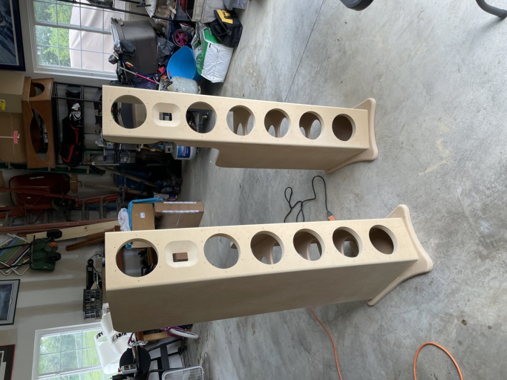

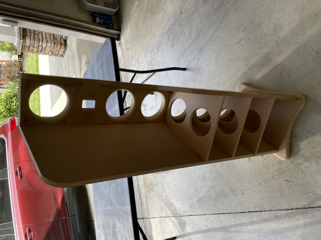

Received the flat pack.  Ive got it glued together, sanded with 220 grit and removed any wood glue dribbles and spots.  I am very much on the fence about how I want to attack the finishing process. MDF is just not a fun material to try to finish when you want flawless paint seams.   I applied bondo wood filler to any small seams and letting it dry.  I think the next step after sanding will be some kind of wood sealer. I know there are a lot of methods and products out there. I’m leaning toward some kind of shellac based sealer. I’m slightly concerned about sanding that. I have worked with shellac before and had problems with it gumming up. After all of this consideration, if anyone else has any better ideas or advice, I am all ears.
Huskerbryce
  • Posts: 138
« Reply #30 on: 22 May 2024, 06:22 pm »
A few photos of progress so far.
