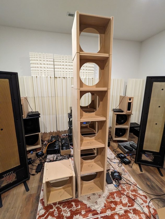

These are the standard modular open baffle H-Frame flat pack modules that captainhemo makes for the GR-Research 12in OB servo driver.  Basically the same dimensions as the full cabinets, but modular so you do not have to move heavy cabinets as the modules with servo drivers in full cabinets.  They have been around for a few years and there are threads here on other builds I have done of them.  With the top on, a 2x12 stack is at 31.25in high from base to top cap.
There are a few different top cap versions that he makes so that depends on the look the customer wants.  I have both the tops with overhand and flush fit for different sub towers.
These are designed to go with the Rythmik Audio A370 and HX300 OB series servo amps.

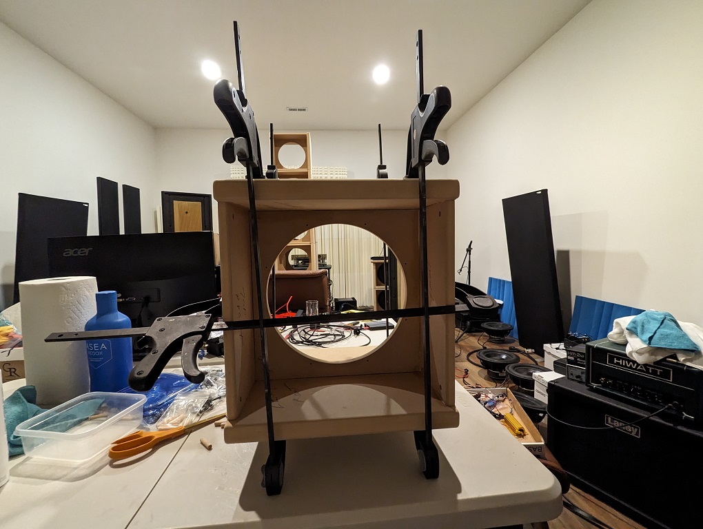

The picture is me building up two 6x12in modular servo sub stacks for my room.  These will be painted once completed with an automotive Hot Rod Black.  Just completed gluing the first 6 modules.
There is no performance difference.  The good part is that it can be made as a 2x12 and later expanded to more modules if wanted.  I have them for doing shows as they can be wired to the servo amps in either 2, 3 or 4x12 driver configurations.  For a 6x12 configuration two servo amps are needed.
Hope that helps.

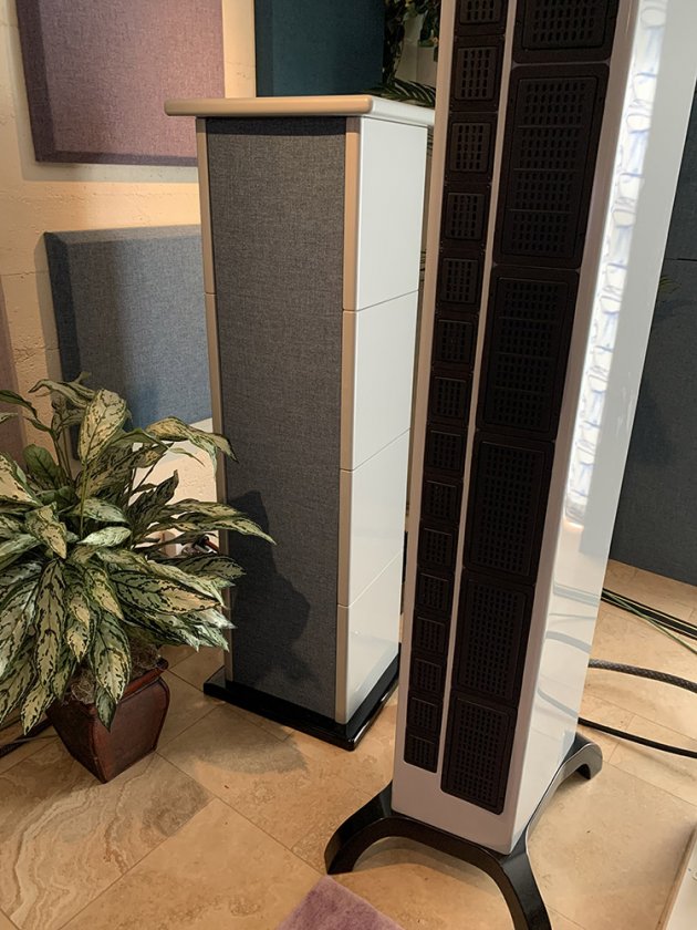

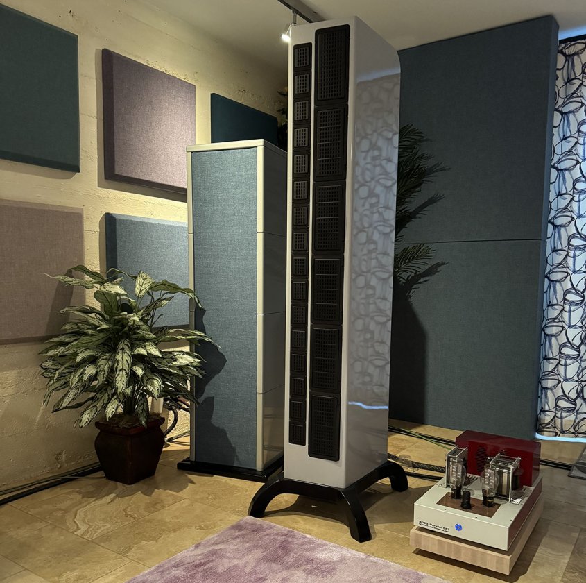

Here's a photo of my quad modular subs.
And hers a photo with the overhanging top plate. I prefer the flush look.
Those are very nice. This is your work or you had someone build these?
Nick
Jaytor
Re: Modular 1x12 Servo OB Sub enclosures
« Reply #6 on: 17 Apr 2024, 07:33 pm »
Nick
The cabinets were made by captainhemo and he had them painted by his local paint shop before I picked them up. I installed the drivers, wired them up, built the crossovers for the Line Forces and made the grills for the subs.

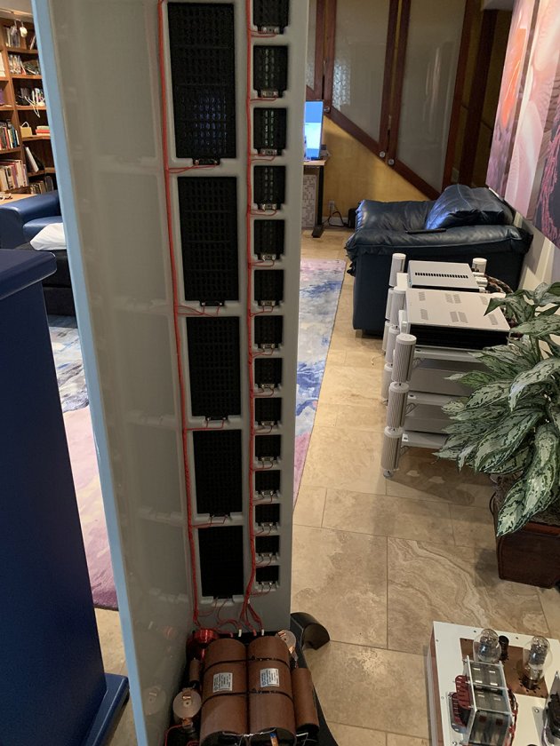

I designed the line force to be modular with three panels each with 2 Neo10's and 6 Neo3's.
So much easier to move. I can assemble and disassemble in about a half hour. (I used blind mate connectors.)
Here are some pictures:

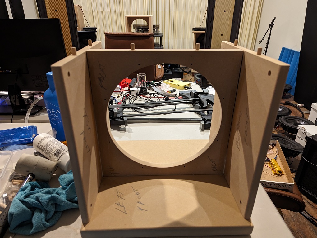

Building new 6x12 OB H-Frame servo sub cabinets from captainhemo.
Some modular 1x12 cabinets build pictures for the thread:

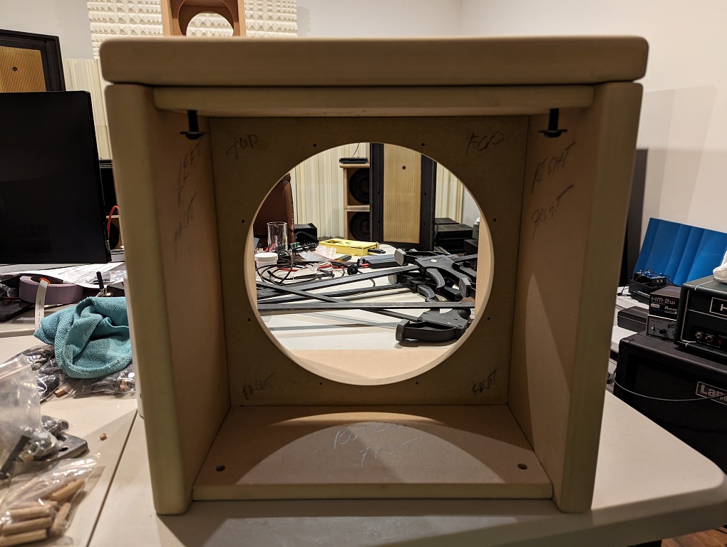

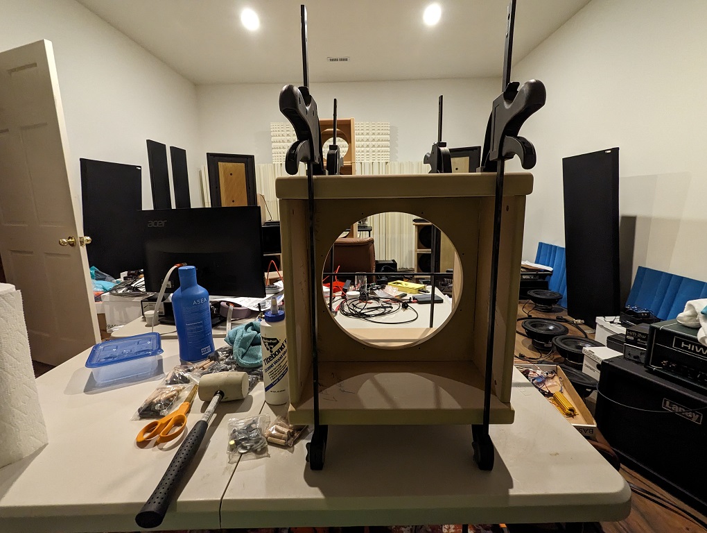

The #12 1x12 servo sub H-Frame is glued and drying.

The module tops and bottoms are bolted on to the H-Frame.
As Jaytor showed the top styles are interchangeable

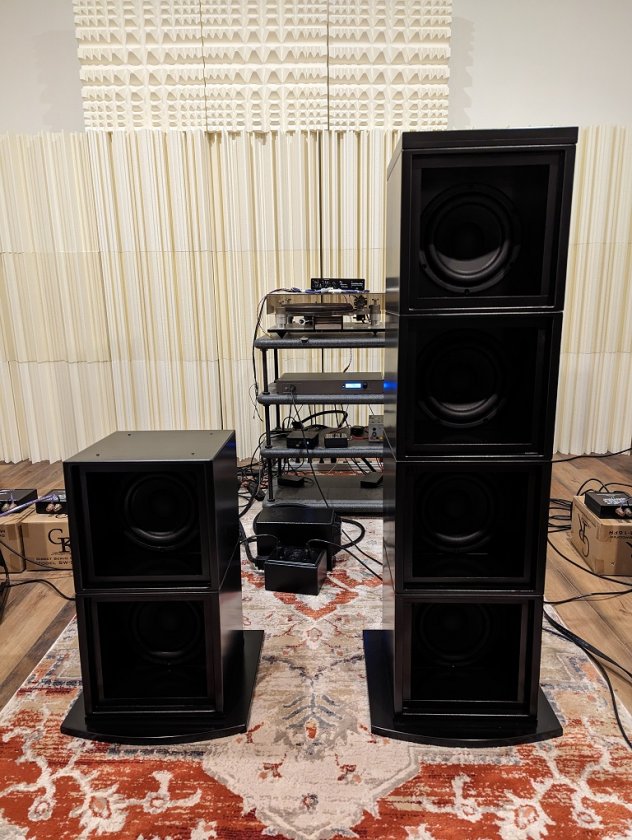

The two 6x12 OB H-Frame stacks are completed.
Taking them next week for the Hot Rod Black paint to complete the build.  The last 6 GR-Research SW-12-16FR subs arrive this week for install once the 1x12's are painted.
