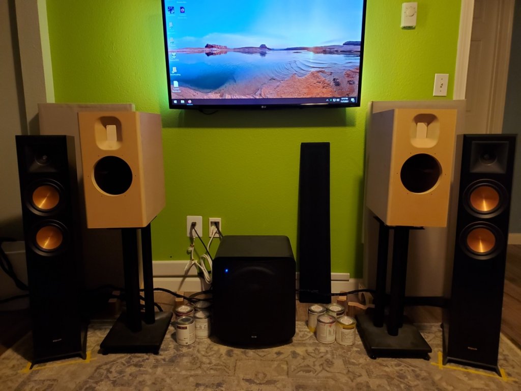

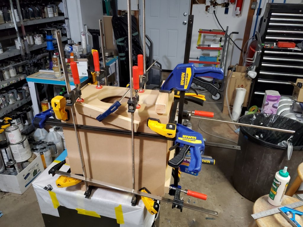

Hi everyone,
Just wanted to make a thread for another NX-Studio build. Currently I have one speaker in clamps and the second one going to be glued up in the morning. These ones will be getting full custom paint cause it sounds like fun and I think Danny would approve. We'll see how it goes, but I'll be excited to give it a try.
Also wanted to give a shout out to Jay's awesome flatpacks and Peter for being super helpful and a great assembly video. I'm excited to make some more progress.

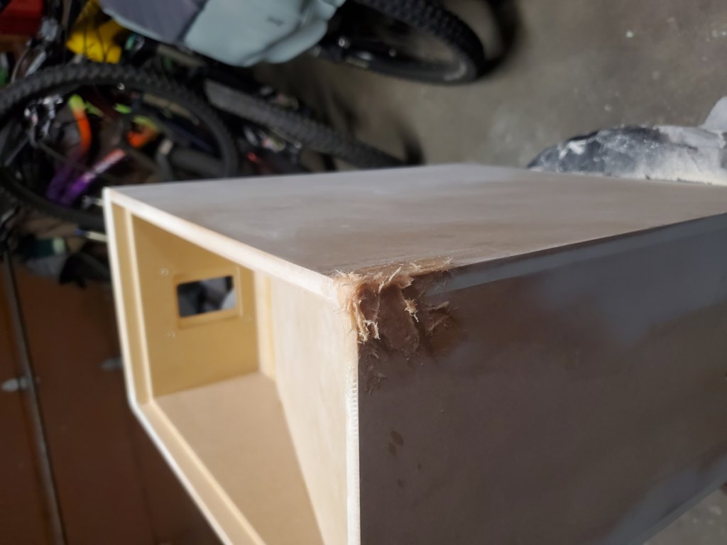

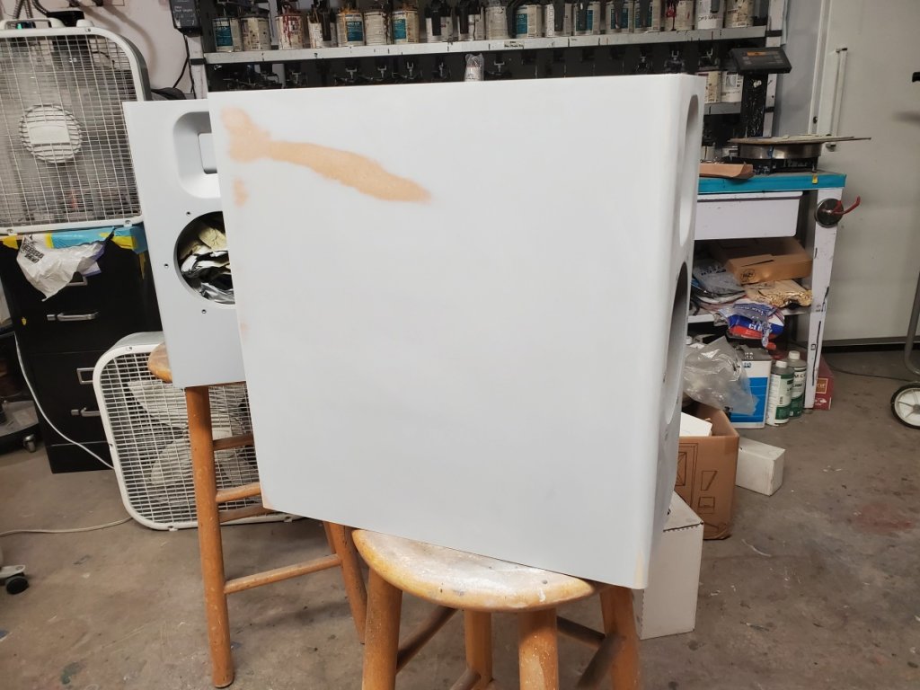

So I've made some more regress albeit with a small setback as well. Cabinets are glued up, currently smoothing the joints with filler and sanding before going into primer. The grill cover for the top is already into a satin black so that's going to get grill cloth on it next week. Unfortunately one speaker took a stagedive onto the top back corner. Glue held together strong so it only dented the mdf which has been repaired using some reinforced body filler. Everything is back on track now and good lessons learned in the process. Also, I didn't realize my "small montiors" were going to be bigger than the klipsch floorstanders they were replacing.
Thanks again to everyone recommending the nx-studios over the other options. This has been a fun project so far, and once the internals finally arrive we'll have some serious fun. For now it's time for more sanding so I can finally get them into primer.

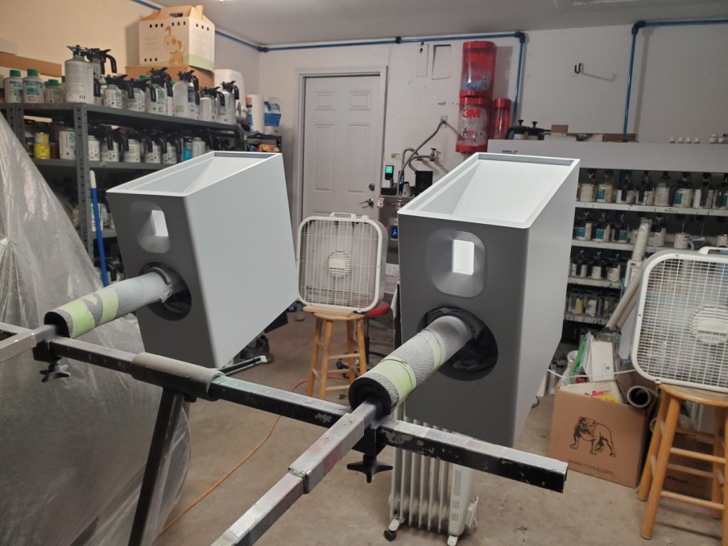

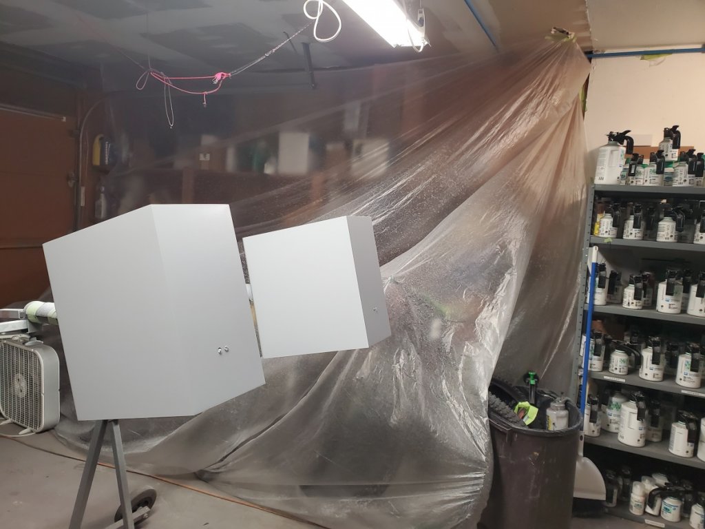

Finally. FINALLY speakers are into primer. They'll need to be sanded and re-primed just due to the nature of mdf, but all in all they are progressing.
Once I sand and re-prime, that's where the fun with color is going to start!

Paint scheme will be fun. Blue candy main color, with silver leafing GR logo on the front like a car emblem and knowing Danny is a fan of fast cars I'm putting the model name in fine bright silver along the side like an old sports car side chrome piece. Top will be black grill cloth and satin black on the inside top to look similar to an old vinyl top. Definitely over the top but fitting for these little hotrod speakers.

I knew I had to wait for my kit, so that's one of the reasons I'm going all out on paint. Since I sell automotive paint as my day gig, I can't help it getting fixated on the coolest colors and best looking paint schemes so F-it we're going all out. In the end it'll probably be 30+ hours of paint and body work and a few hundred in materials, but who's counting... That's actually less than I put into my wife's bike helmet a couple years back.

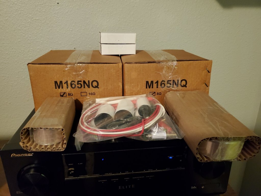

So I finally got my first box of parts, and UPS is showing the no-rez should be here Tuesday.
 I'm freakin excited to start wiring these things up. I did pick up some Path resistors and I may just start with that upgrade for now. I did install speaker grill mounts inside so the crossover should be easy to remove as necessary.
As for progress on the boxes, I have one speaker sanded to 220 grit, where the other one still needs to be finished. One point to note, no matter how careful you are during clamping, there will always be high and low spots. Sand them with a long flat block flat and re-prime to ensure there aren't wavy sides. That would be immediately noticable as soon as these go shiny. Uugh.

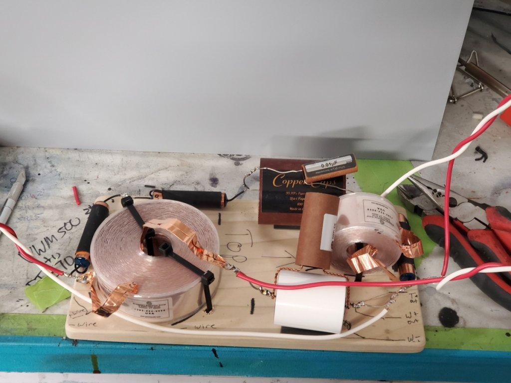

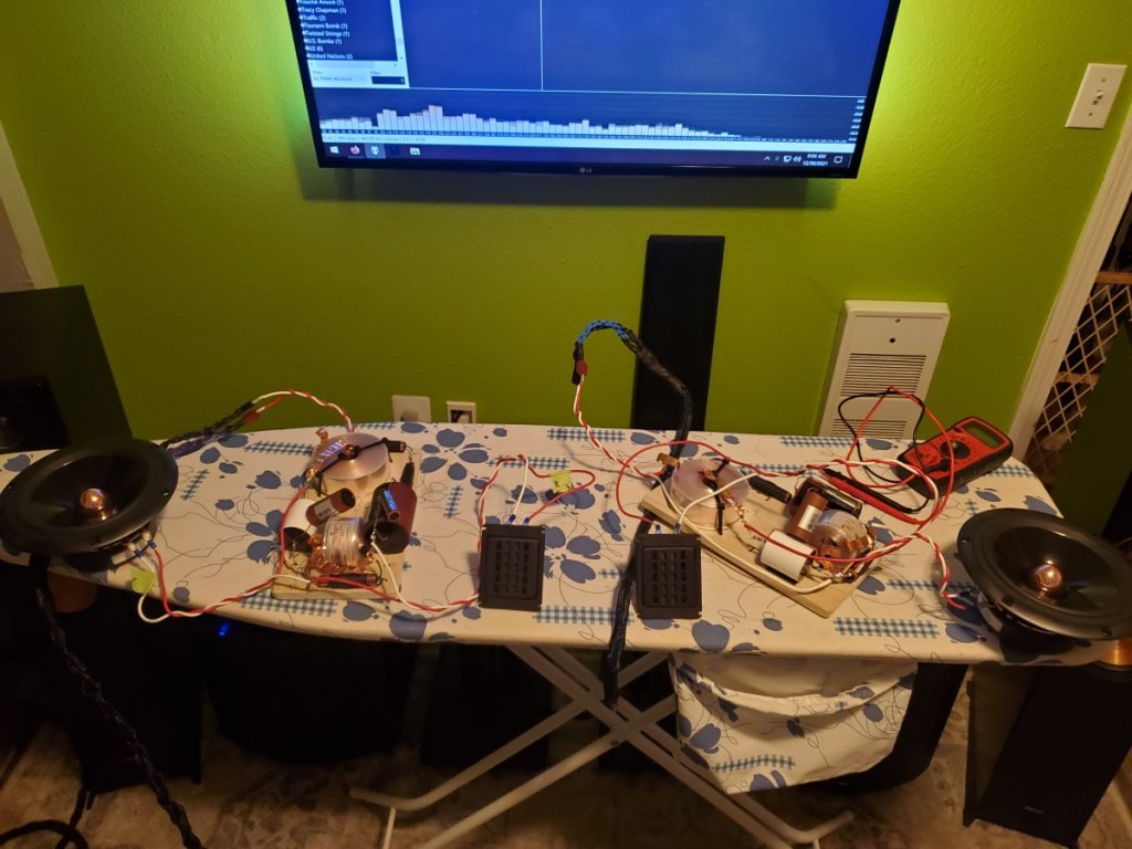

Since I'm on vacation this week, I thought I'd hammer out some of the stuff on my build. It's too cold up in WA this week to prime the boxes again so I decided crossovers and top grill covers would be my mission for the moment. I've completed 1 of each bouncing back and forth for a mental break in between. So far, so good but we'll see if they make sound or not.  :scratch:
A big shout out to Argoncat who was so kind as to gift the copper caps for the tweeter. Should be a good upgrade from the sonicaps I hope.
Also I test fitted the crossover into the speaker and those speaker grill mounts work fantastic for easily securing and removing the crossover.
That's all for now. Back to working on these guys.

Just had to test connectivity before I put away all the soldering stuff, and I'm blown away. I can't move. I'm paralyzed by how amazing it sounds, even just strewn about as it sits. The detail and clarity is unbelievable and these are literally just barely touching contact. Ok, serious double time march on these cabinets so I can get these completed. But seriously, what the #~€/ these things sound so good! Danny, if you read this I just wanted to thank you and your whole crew for putting out the level of product you do and the service you provide. I could not have done this without all the help your team and associates have provided. One or two more songs, then it's back to the garage for more sanding on the cabinets.
