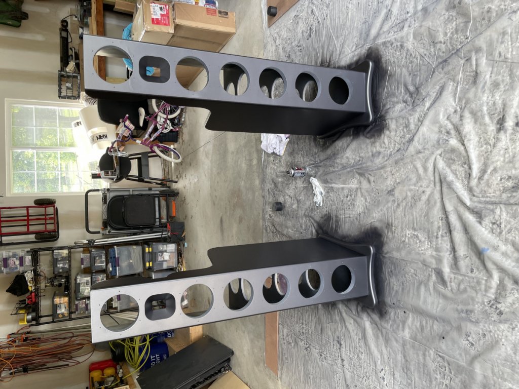

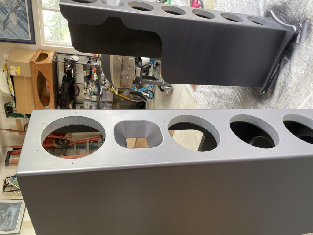

After a couple weeks of sealing, sanding and priming I decided on a color.  I primed with a rustoleum high build auto primer.  Put multiple coats, lightly sanding from 220-320-400 grit 3M paper.  After a couple weeks of that I was happy with the smoothness.  I applied a GM auto paint in the color Iridium metallic.  Added a clear coat.  Waiting for the clear coat to cure and then I plan to lightly buff it with miguels polishing compound.

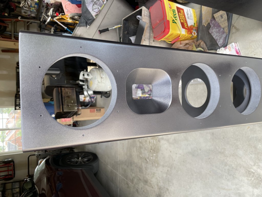

So far, I’ve got a very nice finish. I do not see any seams. I think once the clear coat is cured, I feel I can buff and make them shine like glass. But if I buff, I think I will just buff the side baffle first and see what it looks like before I attack the front baffle.  Planing to use miguels auto polishing compound with a light buff.  Nothing too aggressive.

« Reply #57 on: 19 Jun 2024, 05:24 am »
I am slightly nervous doing anything else to these babys.  I spent 40+ hours on sanding, sealing, priming, finishing, painting and coating.  I have no experience with a polishing compound other than a youtube video and my imagination on a thought experiment gone horribly wrong.  Does anyone have any experience with a polishing pad on a clear coat like this with something like miguels or another compound?  Id hate to ruin a good thing……

It's actually pretty easy, provided you go slow and take your time. Are you using an actual buffer or are you foing this on a drill with little 3in pads? Also, what type of clearcoat did you use? 2 part catalyzed clearcoat (like Spraymax 2K Clear) you can be a lot more aggressive with your polishing steps but a 1k non-catalyzed aerosol clear you can't get too crazy. So as a few quick tips, apply a few drops of compound to the pad and reapply only 1-2 drops as necessary. Do not overload the pad or it will basically hydroplane across the panel and not work properly. Keep a squirt bottle and microfiber towel around to clean up as you go along and can also keep the panel moist partway through application. Work in small sections where normal car is 2'x2' but this would be 1'x1' sections. Meticulously work your way around the speakers with the first compounding step, then move on to the polishing second step. Send me a message with any specific questions and I'll try and get you all set. I always joke with customers at work, "worst case scenario just sand it down and do it again".  :o

So, Nilt…you are hired.  Do you live in the cincinnati area?  😂.  I used a 1k clear coat.  I never planned on anything too aggresive.  Im on the fence wether or not I even need to buff.  Ill add a close up of what im looking at.
