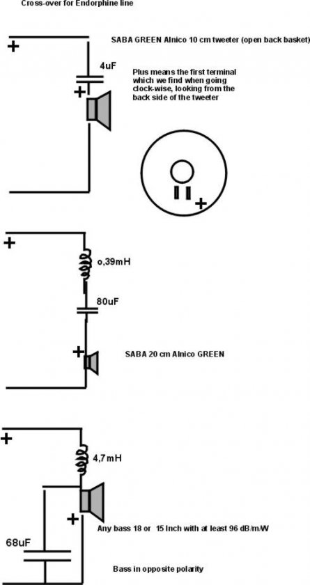

Yesterday I disconnected the bass drivers and ran the SEAS Exotic W8 full range in the bass. This confirmed
1. That the SEAS drivers are really wonderful and quite capable of running much lower than the Saba Greencones they replaced.
2. The Altec 416B alnico bass drivers are crossed over way too high for the SEAS drivers and are trampling on some of the magic.
Current crossover I believe is about 650Hz and SEAS recommend a crossover for their driver of 100Hz, hence the clash.
My first task this evening is to reconnect, then reverse the polarity of the bass driver to see what effect that has.
As I understand it, the low pass filter on the Altec is a 2nd order Butterworth. My inductors are Jantzen C Cores and capacitors are Audionote Kaiseis so a bit too expensive to be experimenting by substitution :(
Can anyone recommend an on line calculator so I can select values for this Butterworth crossover or alternative components I can use to experiment. I am warming to the idea of a calibrated measuring microphone. :)

« Reply #88 on: 24 Jan 2019, 01:53 pm »
Thanks Matevana, you wont believe how long I searched for such a calculator :duh:
In my low pass filter my actual inductors are 3.9mH and caps are 100uF.
The calculator suggests that to get a crossover value of 500 Hz one should use inductors of 3.6mH and caps of 28uF. As the caps are three times the value of those recommended would you know if this pushes up or lowers the crossover point.
Also could could you recommend 'cheapish' inductors and capacitors that I could experiment with before switching to expensive ones to finalise the low pass.
Thanks for your continued help.
PS reversing the polarity of the bass drivers made no significant difference.

« Reply #89 on: 24 Jan 2019, 03:18 pm »
A higher value capacitor in a 2nd order low pass filter, will increase the rate of attenuation of any high frequencies above the cut off point (roughly 500 Hz in this case). The crossover point is largely determined by the inductor in this circuit; the way in which it rolls-off is influenced by the cap.

A friend leant me a signal generator this evening.
The SEAS Exotic has worthwhile output down to 100hz and thankfully is where I planned to cross it over.
The 15” Altecs with the existing low pass filters have worthwhile output up to 3.5khz. This is far too much overlap and the reason I will employ DSP with separate amp for the bass.
Just thinking out loud really, but the Altecs were supposed to be crossing at 6-700 hz. Useful output at 3.5khz seems rather odd. What do you think?
For completeness it’s low pass filter is currently a 3.9mH inductor in series and a 100uF capacitor in series.
Bumpy
