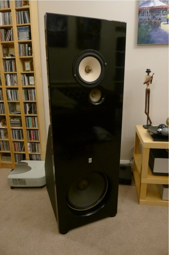

I was fortunate in that selecting the SEAS driver meant it could be bolted into my baffle with only a bit of carpentry. Here it is in location and running in.
This gives me time to think about crossover and tweeter changes

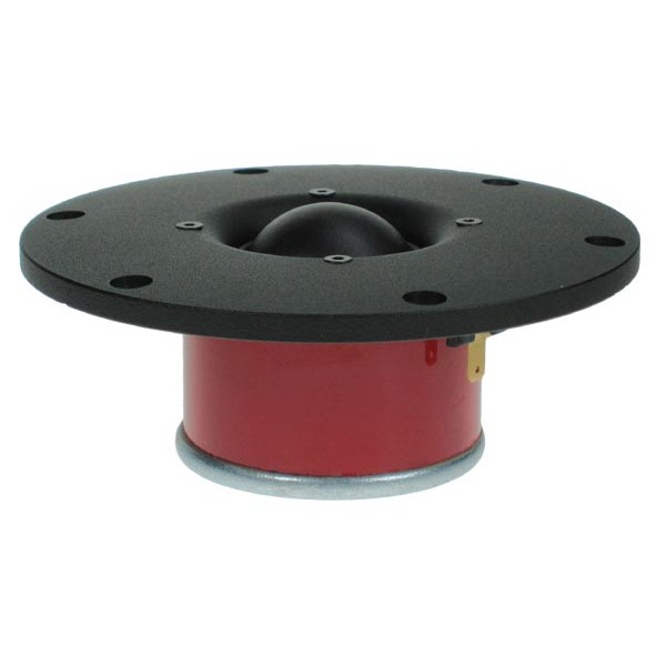

Moving on to tweeters.
My next step is to double up on the Saba Greencone tweeters. The additional one will be round the back, firing up, down, sideways and in and out of phase. The consistent aim is to keep voice coil centres aligned and hopefully because of the wavelengths involved, within about 3" of the mid range voice coil.
Additional Greencone tweeters are selected initially because:
1. Similar sensitivity to main tweeters (95dB)
2. Alnico magnet and thin paper cone to give similar signature to other drivers
3. I have them in the cupboard.
I am contemplating pairing up the SEAS midrange with a forward facing SEAS Exotic tweeter which is a match made in heaven (SEAS!).  BUT it is expensive and mono pole and I haven't yet resolved whether that is a negative thing.
There is some history of pairing the SEAS exotic drivers in the Salk exotica speaker albeit a different design but it is extremely well reviewed.

Here is a picture from yesterdays experiments. The tweeter was secured with bungee ropes. :)  Sorry, the pictures laid itself down AGAIN.
There was a noticeable improvement in ambience without a loss of focus, so it shows promise.
The most successful positions were rear firing directly behind the existing dipole (out of phase) and upward firing from the top of the baffle.  I have formed the opinion that a dipole is not needed in this situation, so I am on the look out for a cheap soft domed mono pole tweeter of 95dB with extended top end to show proof of concept.
