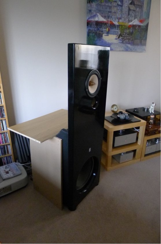

Still using my DSLR camera and still with the mid range driver disconnected I decided to explore the effect of installing a very crude U frame aka a box with no back to the rear of the bass driver. The aim is to help alleviate cancellation of the front signal by the rear at these long wavelengths. I have uploaded two videos of quite different music but believe there is a major improvement.
https://youtu.be/6Ji4yqjtkJ4
https://youtu.be/BV53qw-roBw

Thanks Bemopti for taking the trouble to comment. The music you hear from my system is part of an experiment to determine the contribution from the tweeter, but primarily the bass driver.
The mid range driver is completely disconnected and yes to me it is also very "thick" because of the missing frequencies between 600Hz and 6.5Khz :) My main aim here is to determine how much contribution the bass and HF units have on the mid range - hence playing tracks with male and female vocals
My main conclusion at present is that the improvised (bodged) U frame has improved the impact and clarity of the bass, but there is now a faint echo to the bass. I am guessing the box is too deep or that the low crossover needs to be lowered from 600Hz.
I am happy with either of these conclusions particularly lowering the crossover to say about 200Hz as my new SEAS Exotic W8 midranger is fully capable of playing down to that, whereas the original builder of the OBs may have been working around the lower limitations of the 8" Greencones
Any other comments critical or not are most welcome at this stage.

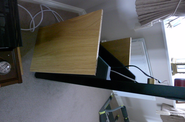

This is where I have ended up with the bass. Results are a bit too subtle for you tube.
1. There is a recommendation to use a shallow U baffle behind the bass driver - no more than 8" deep to avoid setting up an 'echo chamber'. This added a bit of focus to the bass but I could not perceive it being any deeper. This may be because my baffles already have slanting sides.
2. Deep U frame (see previous photo). This did bring out the bass but sure enough there was an echo, particularly on deep male voices.
3. Deep U baffle, without top. This enhanced the bass and removed the echo. I guess this has just created extended front baffles, but is short enough to avoid messing with the mid and HF. For the time being I will pretty up the speakers and live with this.
So that's the midrange and bass sorted. On now to the HF with the installation of 'super tweeters'

Temporary baffles in place, using offcuts from an old cupboard. Time to think about something posher later.

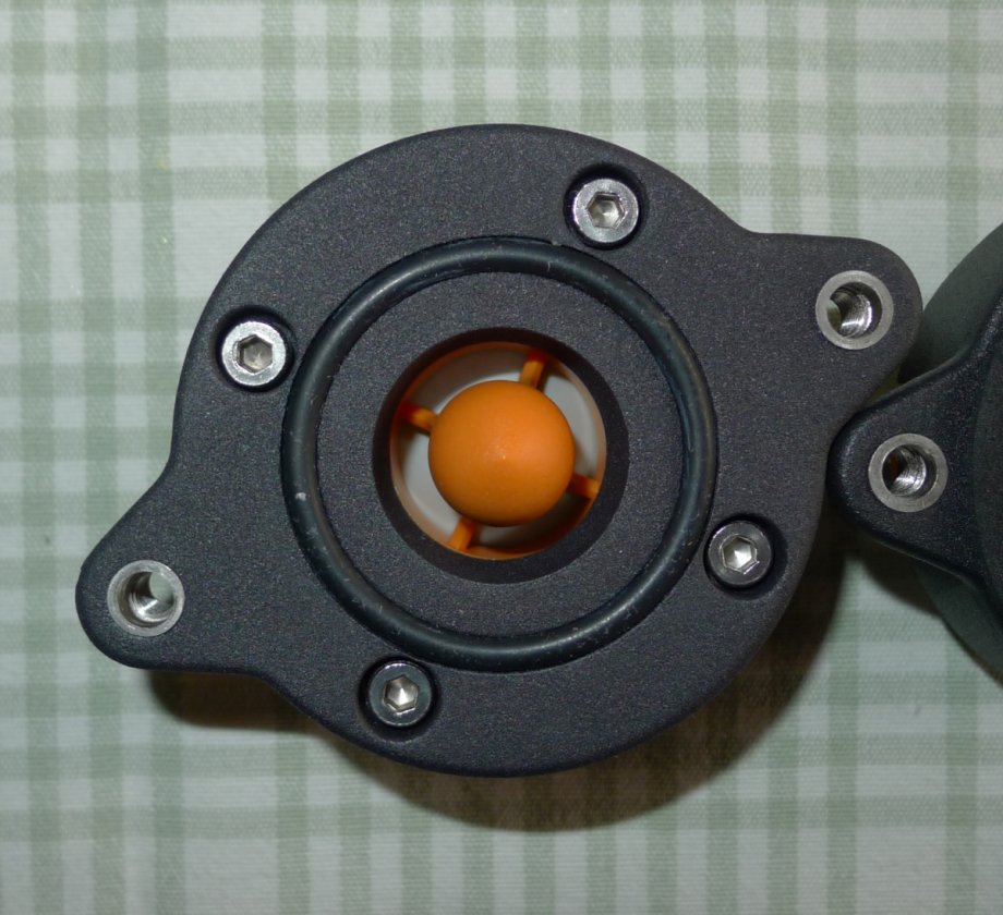

Had a bit of a set back today when I took my new Pro Faital HF 102 tweeters out of their boxes to have a play. As you can see they are different versions.
Apparently one is old stock and will be replaced when more arrive in store.
In the meantime the SEAS midrange drivers and my new 211 valves can continue to run in.  :thumb:

Interesting.  I have a pair of the lower version with the built-in o-ring. Not sure whether I have the old or new, but I continue to like them a lot. They sound like a quality dome tweeter with the output of a compression driver. They are also very small and light compared to typical pro sound horn drivers.
JohnR
Re: My tactics for improving vintage 3 way open baffles
« Reply #76 on: 12 Jan 2019, 05:32 am »
Interesting. Which one is the newer one?
Bumpy
  • Posts: 444
« Reply #77 on: 12 Jan 2019, 08:09 am »
The gasket version is the newer one.
I am convinced they will sound the same, but if the experiment is not as I hope then I will need to resell them and at that point it will become an issue.  :cry:

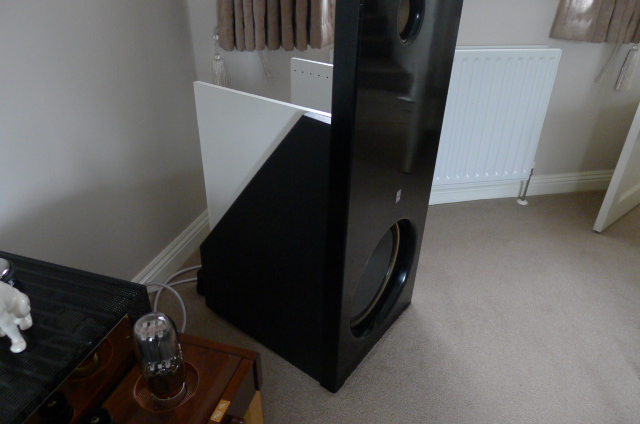

Positioning
Due to space restrictions my speakers baffles have always been about 900 mm from the wall behind. This has always been fine for SQ.
Now with the extended 'side' baffles, the most rear pont of the speakers sits just 35mm from the wall. This didn't seem good, so I moved the whole speakers forwards to make this gap 60mm and have the front baffles now sitting 1020mm from the wall.
This has made a wonderful improvement mainly to imaging, which is now pin sharp, but also to perceived bass. I listen near field and now have the biggest headphones imaginable. This listening position puts critical strain on the quality of the system, which it passes with glory.
The only problem will be the wife who has already remarked that the speakers seem to creep out further into the room on their own. For the sake of matrimonial harmony I am going to make the speakers easily movable using either wheels or gliders. ATM I favour PTFE gliders as they do not leave such a big gap under the baffles.
Picture is of the speakers in their compromised position
