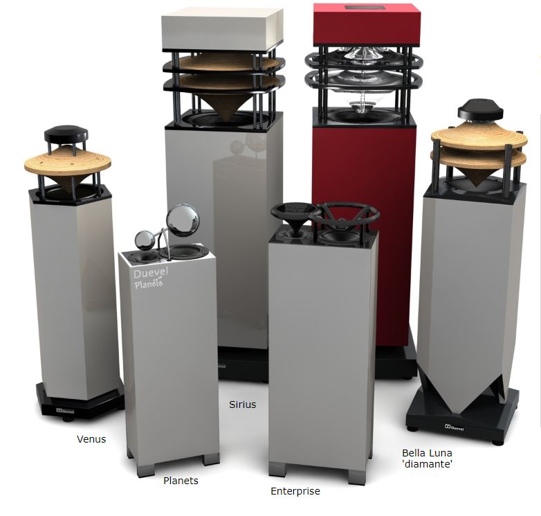

The German loudspeaker company Duevel was one of the first to promote this idea with their Planets speaker:
They also have some pretty interesting ways to address omnidirectional dispersion. They use high efficiency pro sound compression drivers for the mids/highs in both up and down firing configurations.
