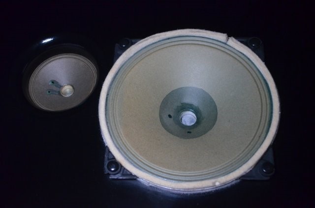

I now have a choice of two 8" drivers to evaluate against the Saba Greencones.
The first are vintage Supravox T215 RFT 64. These have similar characteristic to the Greencones. They are from France in the 60s and have the required Alnico magnets and paper cones, I have purposely avoided the model with wizzers.
Here is one shown alongside the Greencone. In terms of cost, the Greencones can be found below £100 in the UK and the Supravox are about £400 a pair. If it was a boxing competition the Supravox would take the prize, but its not :)

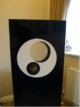

The Saba Greencone hole in the front baffle will take neither of the new drivers and I am hesitant to hack it about until I know where I am going. At present, I plan a new circular baffle into which will be mounted the selected new driver. So as not to disturb the current tweeter (for now) the new baffle will be cut to clear it and allow it to breath.
Here is a paper template for the circular baffle.  Sorry but the software here has again put the picture on its side.  HELP ANYONE?

My first experiment is not to cut the existing piano black front baffle, but to place the new circular baffle on the floor. This presents the greatest challenge to the driver.

Rather than cut into my nice piano black baffles just yet I will evaluate the drivers in the new circular baffles propped up on the floor. This is a real stress test for SQ. The wires were un-soldered from the Greencones and re-soldered onto the new drivers. No other mods were made.
