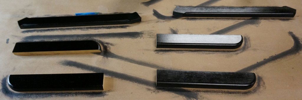

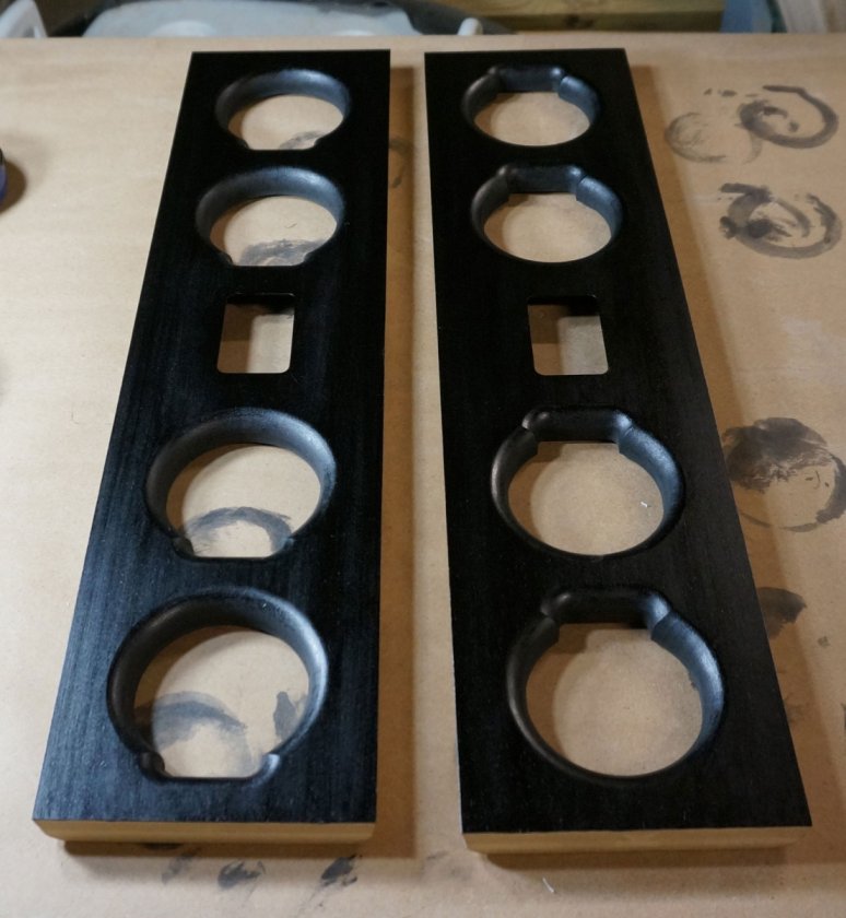

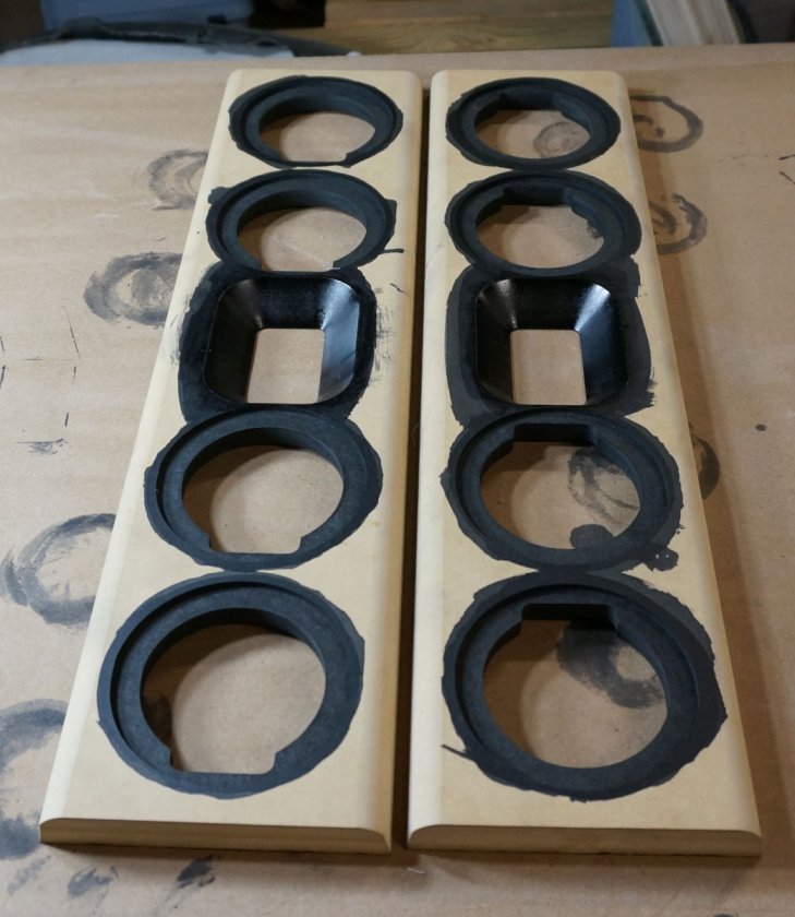

Here's where I'm at with my wedges. After dry fitting to get a feel for how everything went together, I identified the parts that I could not veneer and decided to dye them black then use a French Polish finish. These include the wave guide, the rear of the front baffle, and the inside facing portions of the short wings and the cross brace.

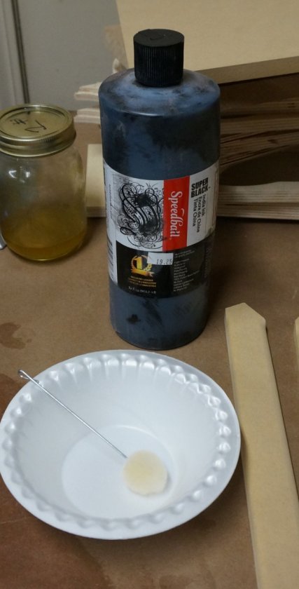

I'm using and an alcohol based India ink as the dye
Here is the front of the baffle. The driver insets are just being dyed black, not polished. The wave guide is about half way done.
The entire rear baffle, including the roundovers is being polished. Again about half done,
Here is the inside of the short wings and the cross braces
I haven't decided if I'm going to leave the black parts glossy or rub them down to a satin finish.

So the dye doesn't leave a blotchy uneven finish on unsealed MDF?
mlundy57
  • Posts: 3640
Re: Something new that sounds incredible
« Reply #392 on: 27 Sep 2014, 11:38 pm »
This particular dye works really well, even application with no blotches, and since it has some shellack mixed in, once it dries it doesn't smear like some other dyes I've tried.  Which makes sense considering it is intended to be used as ink for writing or drawing.
