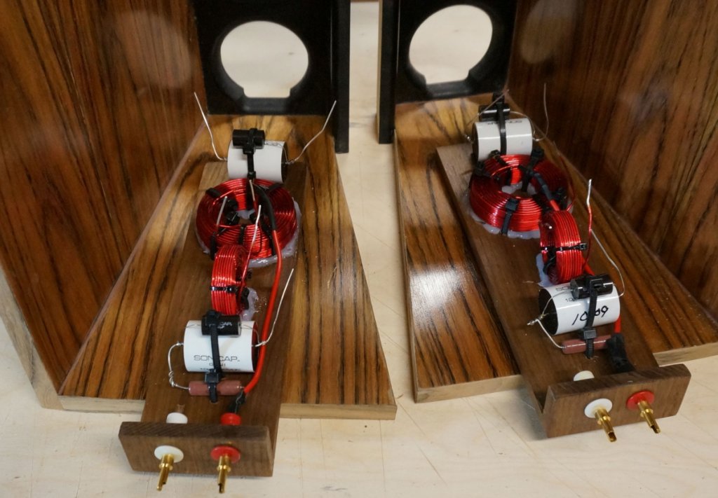

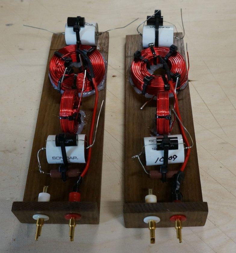

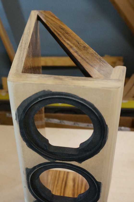

Got a little more done. I have the edge banding applied and the crossover networks built.
Here are some shots of the edge banding
Here are the crossovers
I really should have made them more compact. They turned out at least a couple of inches too long and are going to have to hang over the back.
Hopefully tomorrow I will be able to get the outsides veneered then get the finish applied to everything this weekend.  Then it will be wire them up and go.

Looking good Mike.  I had the same idea regarding locating the tube connectors on the crossover board.  Unfortunately I didn't think about it until I had already glued the connector board to the main speaker assembly.

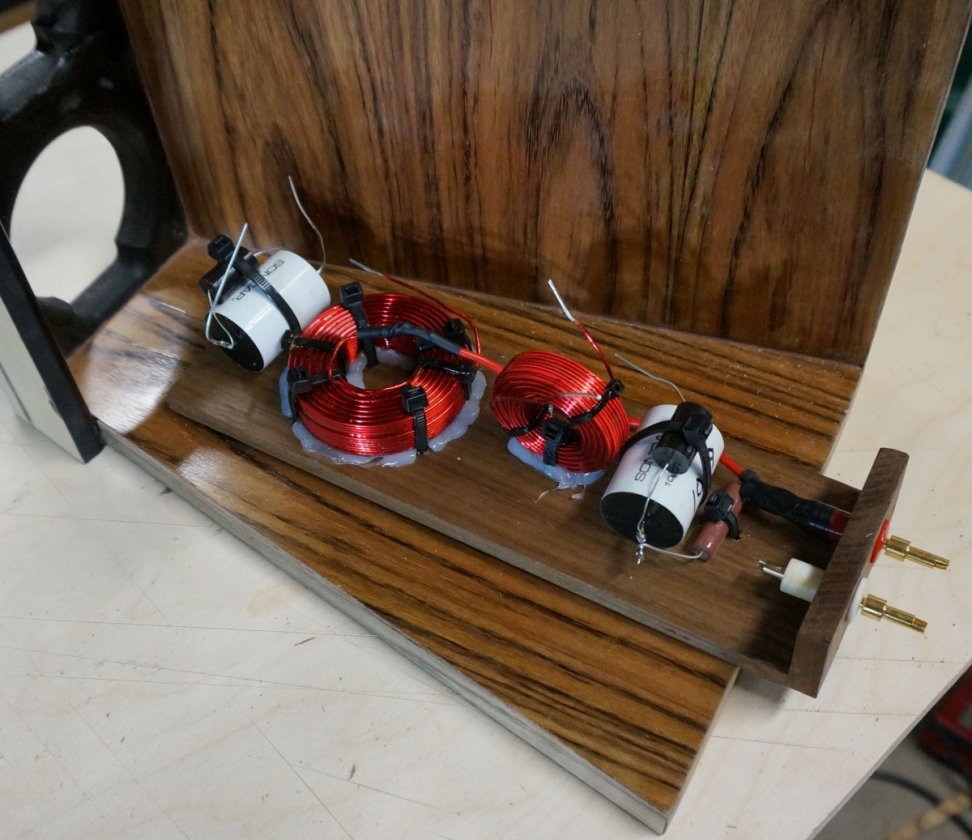

Here a picture of the crossover. It is a 4x6 piece of 3/4" walnut hollowed out 1/2" deep on the backside
with 1/4" sides. End with the tube connectors is 3/4" thick. So all the wiring and soldering is underneath and
if anyone notices the resistor is missing it is underneath.

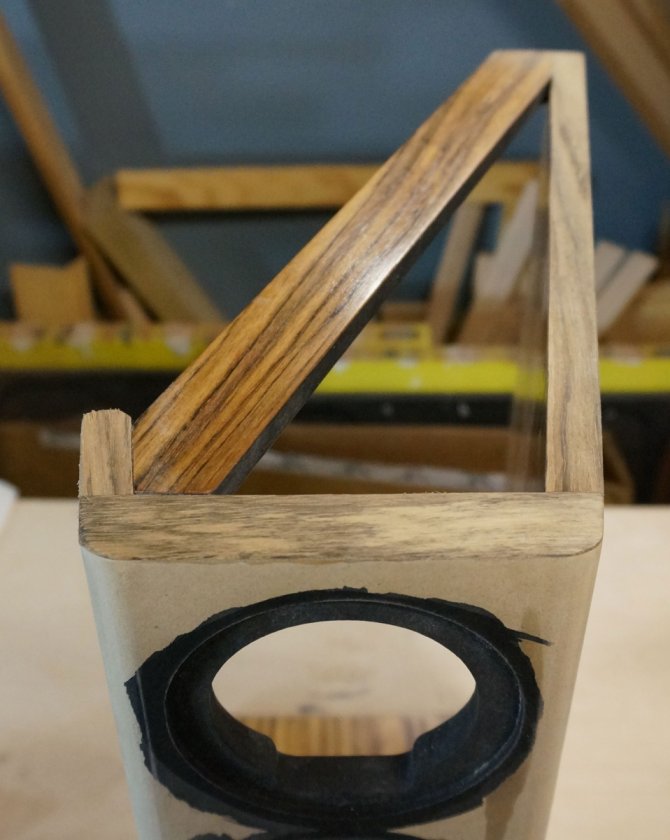

This is the 1/2" walnut top cap. Used dowels on the large wing and the baffle. The brace uses screws. Ran a 1/2" solid carbide
spiral flush trim bit around the top of the speaker. Notice it cracked, 1/2" is really thin for walnut with the grain running
that direction. At least it will be easy to fix with some fine sandpaper, a Q-tip and Watco.

« Reply #465 on: 10 Oct 2014, 04:11 pm »
?  Why are the caps different on these xo's  One is a 10 and one is a 9?
That is really clean and very sharp, both the cap and the crossover. Doing a cap that way looks like it would be a lot easier than gluing on and trimming a bunch of small veneer strips like I did. I'm going to have to remember this.
 How did you hollow out the underside of the crossover, a pattern bit?
Mike
P
If you look a little closer you will notice there are two sets of numbers on each cap. One is the factory etched nominal value and the other is the actual value Danny measured and wrote on the cap with a Sharpie. When he puts the kits together, the cap values are matched as close as possible.

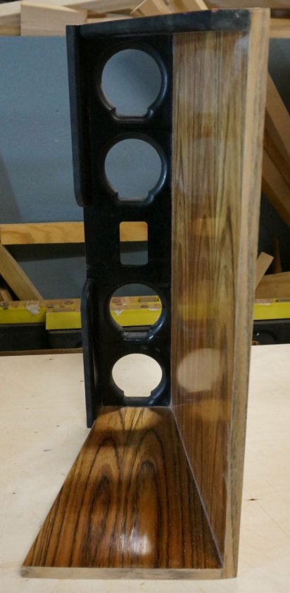

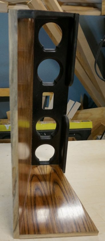

« Reply #468 on: 12 Oct 2014, 10:56 pm »
I have this pair of cabinets finished. I went with less depth and a lower gloss finish than I put on the N3's
I should get them wired up in the next couple of days.

Stunning Mike, wonderfully done. Looking forward to your impressions of the sound.
Greg

Nice mike, I love that veneer, great job!

Simpy gorgeous..outstanding... :thumb:
Re: Something new that sounds incredible
« Reply #472 on: 13 Oct 2014, 04:06 am »
Nicely done  man ,  wow  :thumb: :thumb:
Figured that veneer was going to be something special, as Greg says,  "Stunning"
