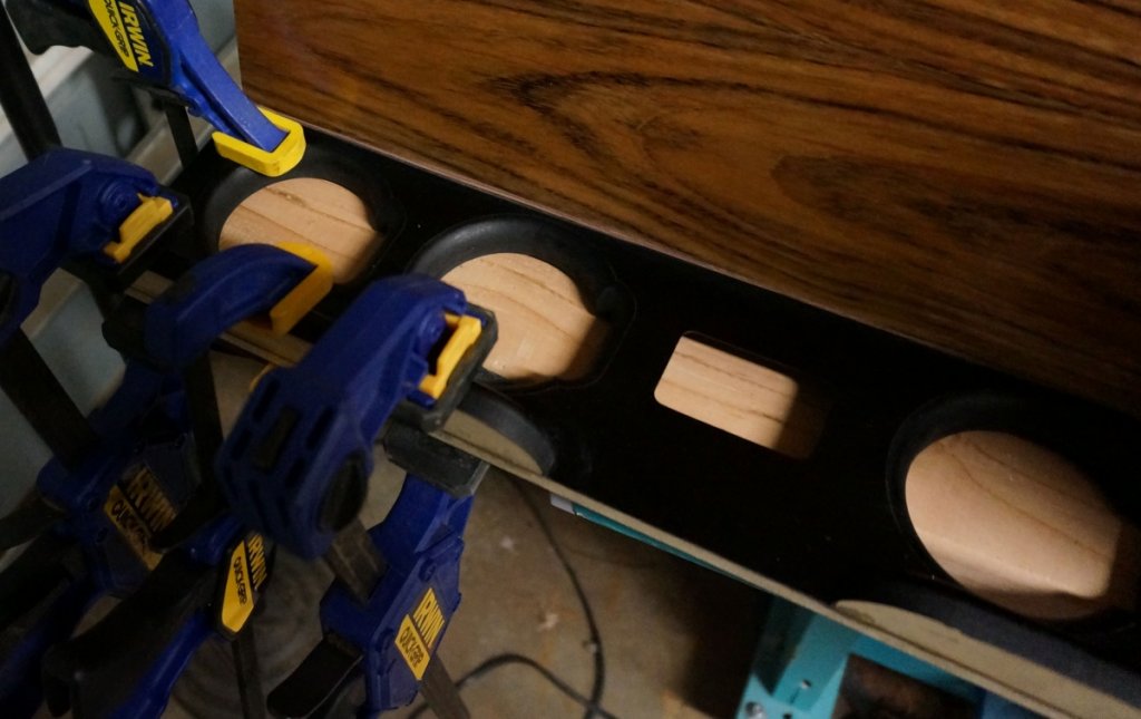

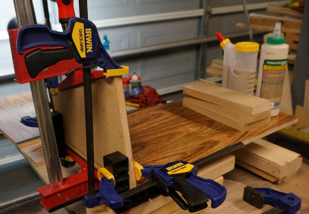

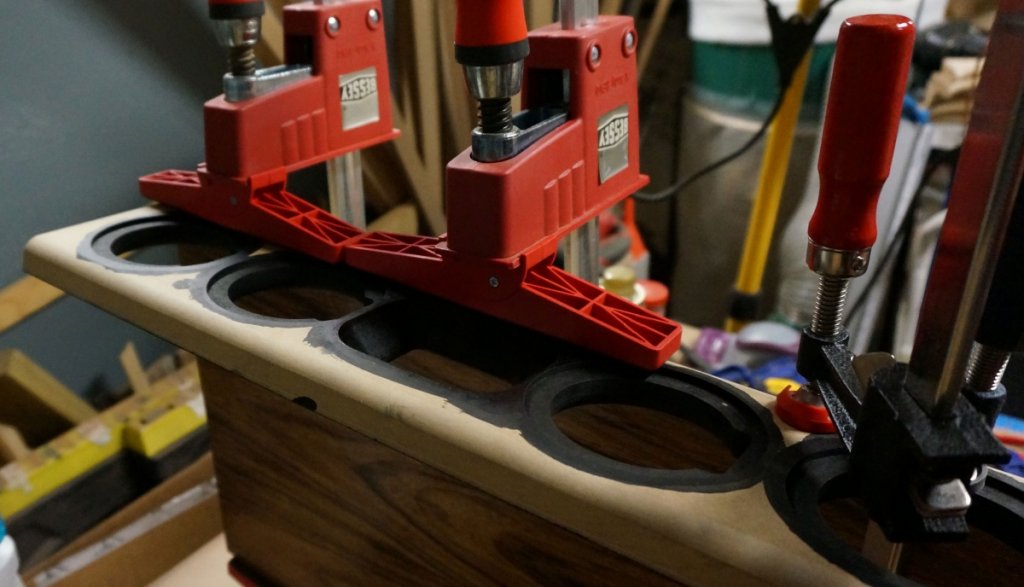

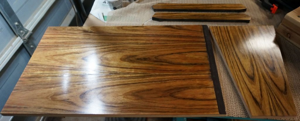

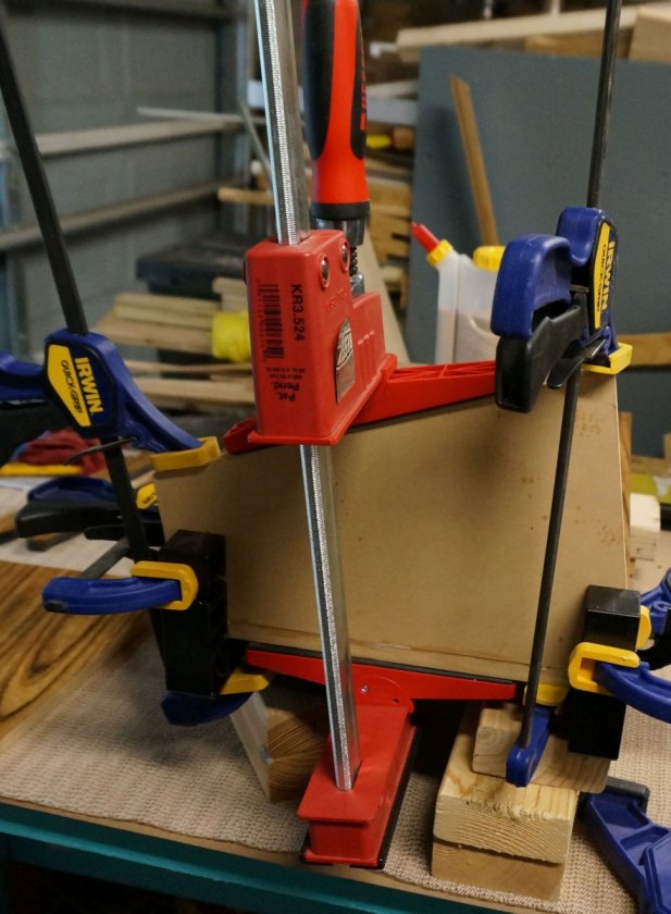

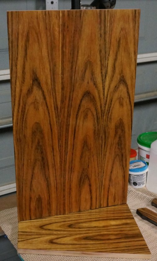

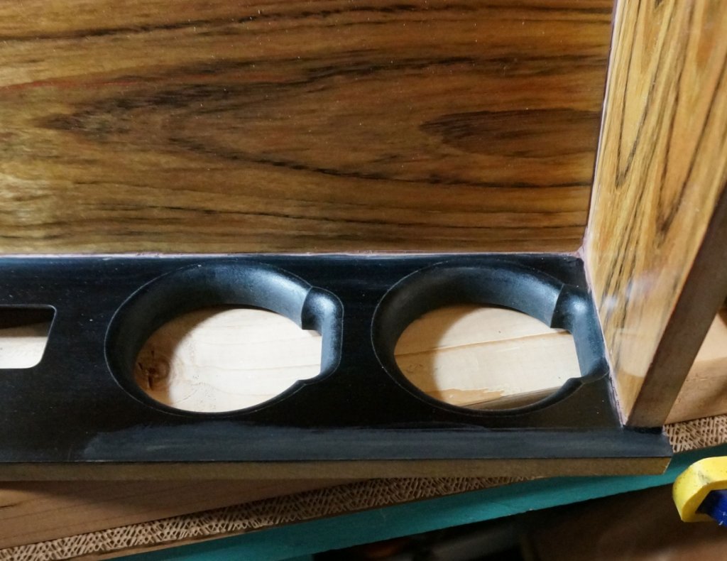

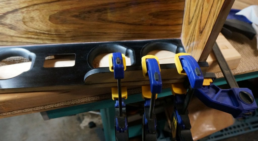

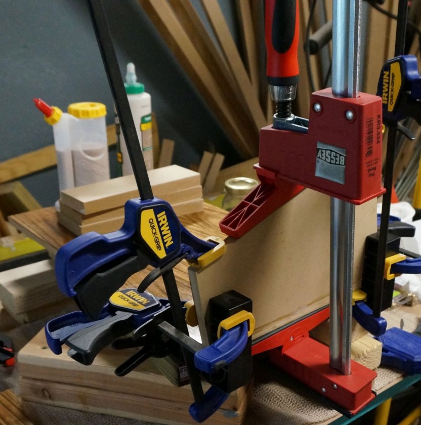

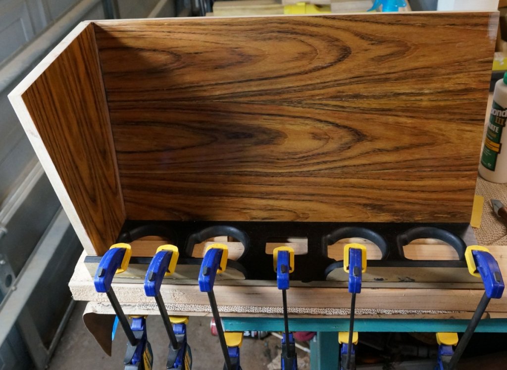

I got some more work done on my Wedges. I veneered and finished the insides before gluing anything up
I glued the bottom to the large wing first. Notice the adapter on the parallel bar clamp. These made clamping the angled pieces easy.

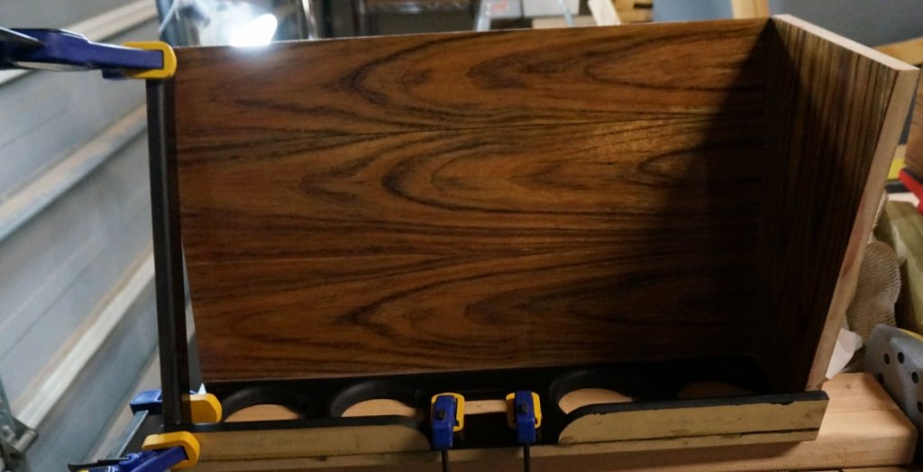

Next I glued the baffles on

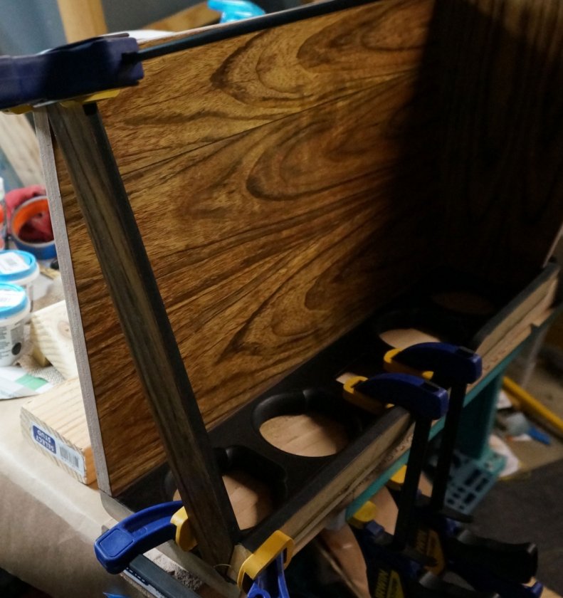

Then came the short wings. First I had to remove the finish where glue was going to be applied (I had to do the same thing on the baffles also)
Then glue the wings on

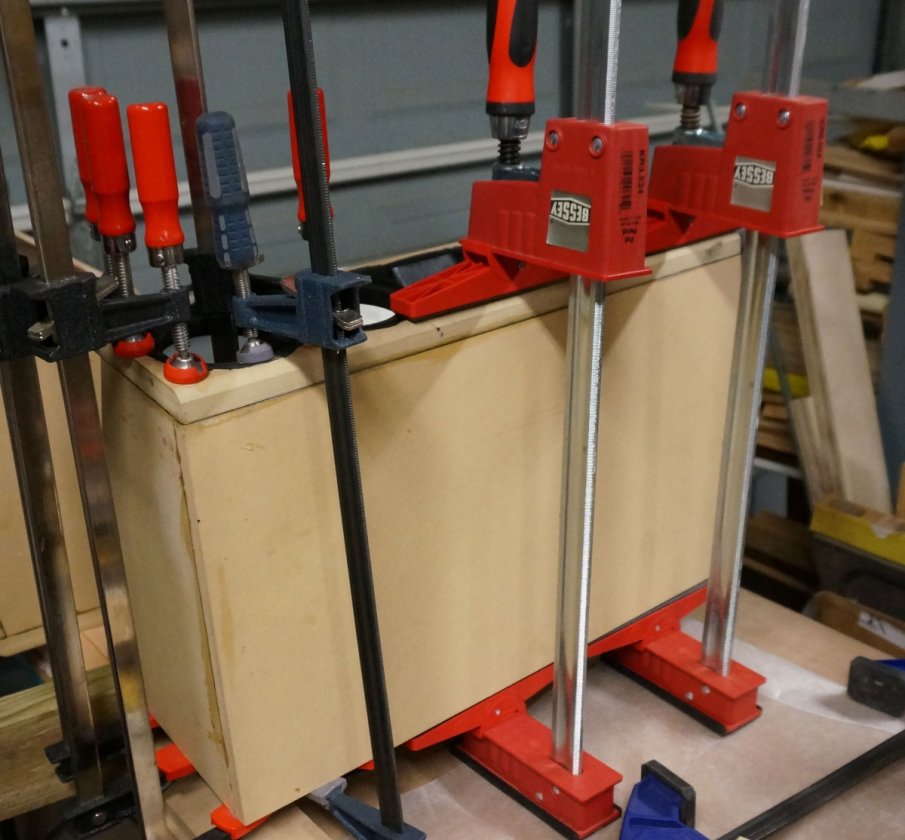

And finally the top brace
I have one more top brace to glue up then I have to veneer and finish the outside and edges
Mike
Re: Something new that sounds incredible
« Reply #432 on: 5 Oct 2014, 11:31 pm »
WOW,  very nice Mike.  The veneer is orgeous  :thumb:

 Those clamp adaptors are something I'd never seen so I nosed around. Looks like they only fit second gen. K bodies but they look handy and are on my "to get" list now.

My Wedge kit was cut out perfectly and since it is so small why use clamps.
Just use a drop of thick or med CA glue every 2-3 inches and spread wood glue between the drops
and press together tightly. Hold for 10-20 seconds for the CA glue to dry. The CA glue acts as a clamp
while the wood glue dries. Also make sure to use wax paper underneath. It took me about 20 minutes
to glue up both. Even though I have at least 100 clamps in my workshop, I only needed 2 small c-clamps
to use as stops to position the large wing.
