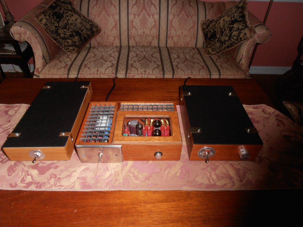

Hey Wind you're looking good. And just like you I'm a little obsessed with the TPA's.
From left to right the TPA3110 power amp, the 6n3 preamp, and the TPA3116 integrated amp. And the blue/black board is on order. :D
For the 6n3 preamp, did you end up using a different volume pot or the built-in?

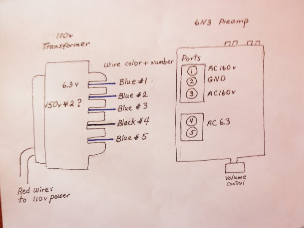

Blue #1 to port #5
Blue #2 to port #4
Blue #3 to port #3
Black #4 to port #2 GND
Blue #5 to port #1
This is a wiring chart for the 6N3 ( four dark blue wires, one black ground wire and two red wires for power cord to outlet ). Communication with Chinese ebay sellers is not the best and if the transformer has different color wires or more than 7 then this chart may not be of much help.

Blue #1 to port #5
Blue #2 to port #4
Blue #3 to port #3
Blue #5 to port #1
Thank you very much for taking the time to draw a diagram! :thumb: I would not have figured it out myself. Hoping now to get the same transformer as you did. Thanks again!

Blue #1 to port #5
Blue #2 to port #4
Blue #3 to port #3
Blue #5 to port #1
Received package of the 6N3 preamp but minus the board--separate mailing package? Return address of sender is in Singapore. And I thought sender is from Hongkong or mainland China.
The transformer I received has 5 wires like Poultrygeist, but different colors. Wires 4 & 5 are thicker gauge (both black) than 1,2, & 3.  I imagine the color does not matter, as long as I follow the order of wires from Poulrtygeist's diagram, it will be correct. Wires 4 & 5 will connect to 4 & 5 of preamp board. What do you think Poultrygeist? Thanks!

Can't you just power the primary, and measure the outputs of the secondaries with a DMM?
mboxler
  • Posts: 300
Re: Maybe the best $100 system ever?
« Reply #78 on: 24 Apr 2014, 01:04 pm »
+1
Even if there is a label describing the secondaries, I always check them with a DMM, just to make sure the tranny isn't defective.
I just (today) received the same transformer you have. The wiring is as follows: the two red wires that are alone are 120V primary input. On the secondary side (5 wires), the two thin red are 150V output, and the thin black wire between these two red is grd. . The thicker black wires are the 6.3V outputs.
