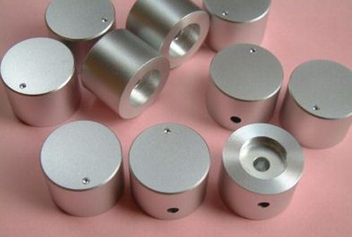

I just posted this an another forum, but since my goal is to build three of these amps as cheaply and cheerfully as possible (while also maximizing sound quality and having an attractive appearance), I thought I'd share the info here as well.
OK, my first parts have started to arrive and I ordered the remaining bits for building three of these amps.
The first parts to arrive were the three Kilo International Wedged Cylindrical knobs I ordered from ebay seller  itches_love_my_switches.  These are identical to Digikey part number 226-3032-ND recommended by rhing, except they are drilled for a 5mm potentiometer shaft instead of the standard 6mm shaft.  But, they are also much cheaper, if bought in quantity.  If you own a drill press and are comfortable drilling out the mounting hole to 6mm, this is a good deal on these knobs. They are EXCELLENT quality and VERY nice looking.  They sell for $10.60 each plus shipping at Digikey (with the standard 6mm mounting hole).  On ebay, he is selling them for $4.00 each with a $5.95 flat rate shipping fee no matter how many you order.  Very fast shipping, too.  Ordered on Friday, in my mailbox on Monday.  Here is what they look like:
Since two of these amps are intended to be gifts, and I can never have too many knobs on hand, I've also ordered some Chinese made solid aluminum knobs from multiple ebay sellers.  The first two are the very common, and affordable solid aluminum 30x22mm round knobs:
These knobs are very ubiquitous on ebay.  So, I won't bother to mention what sellers I bought mine from.  Just do an ebay search for 30x22 aluminum knob and sort by lowest price plus shipping.  I got one of the silver knobs for $4.45 including shipping, and four of the black knobs for $14.48, including shipping - that comes to $3.62 each delivered to my door.  If you use a lot of knobs and are willing to buy in larger quantities, the price comes down even more.  For example, you can get eight of these 30x22 solid aluminum black knobs for $2.87 each including shipping.  That's a great price on solid aluminum knobs of this size.  I'm anxious to see how the quality compares to the Kilo International knobs.
I also ordered a larger 40x22mm solid aluminum black knob for the amp I'm building for myself.  That one wasn't so cheap, at $12.21 delivered, but it's the same size as the tuning knob on my Magnum Dynalab FT-101A and I want it to match.
I have a bid on one other knob that ends on Wednesday.  If I win that auction, I'll post a photo of that one, too.  Like I said, you can never have too many good quality solid aluminum knobs on hand.
