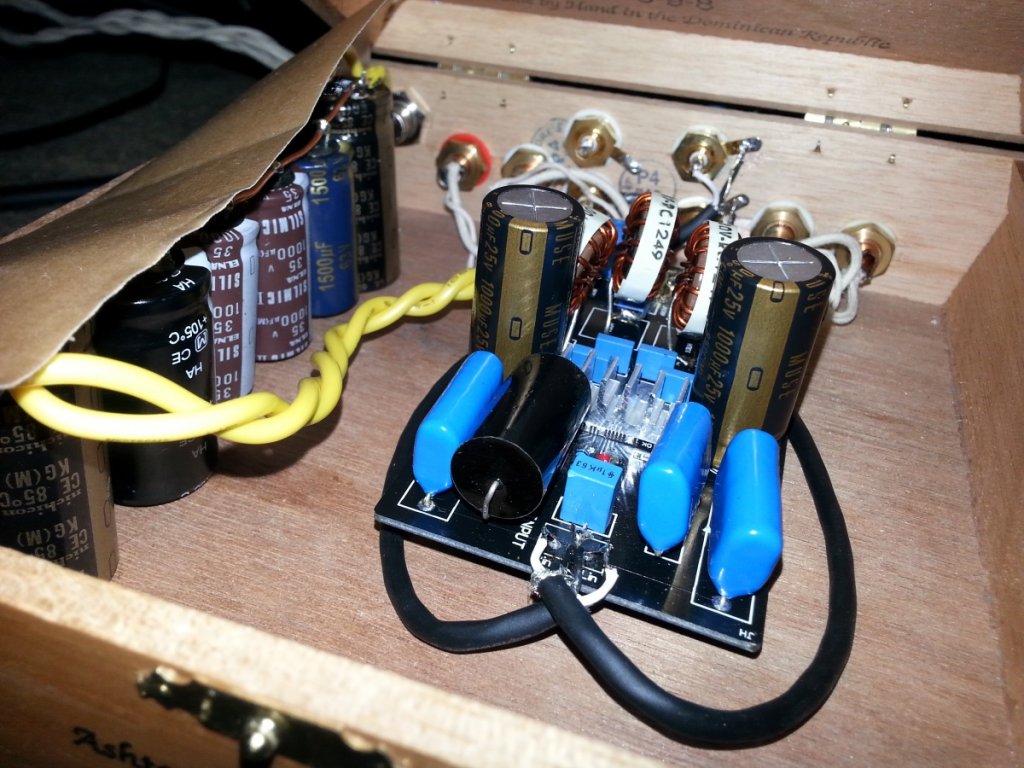

So here's my 3116 build. Pretty sloppy but since I am always tinkering I tend to leave things messy.
The sound quality of these amps can't be overstated.
Did you mention earlier that you bought those 1uf input caps from Radioshack?
Yes. I don't see them listed online anymore but there may still be some at a local store. I can't imagine anyone running to RS for polyprop caps so you maybe in luck. I have a fourth one somewhere but couldn't find it.
Might try some fancy caps later.

wushuliu
can I get a birds eye view of your build please?

wushuliu
If I'm feeling less lazy I'll pull it out and take a pic.
