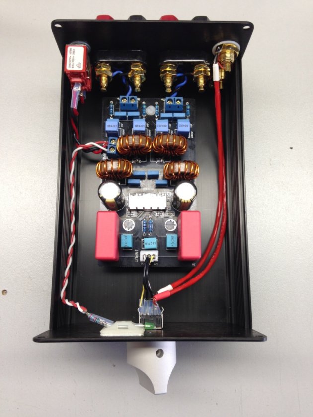

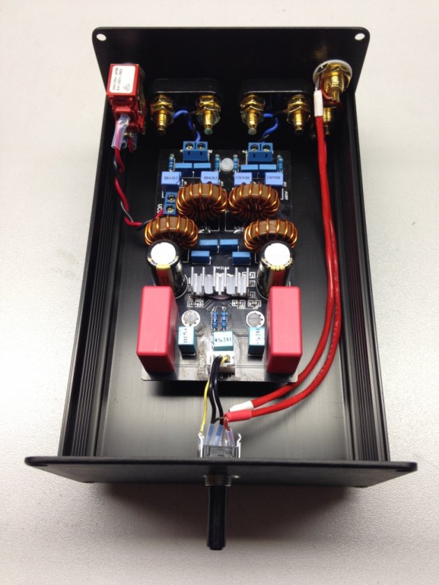

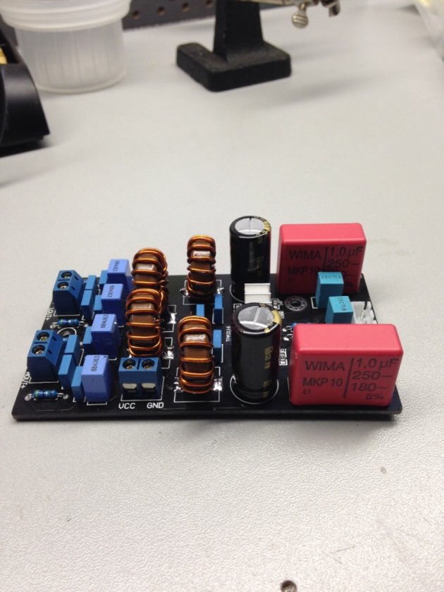

I completed a second Yuan Jing 2.0 blue amp build. In this case, I used a Panasonic EVJ 50kohm log taper pot just like lacro's standalone volume control box. These work really well with these Texas Instruments Class D amps and they are very reasonably priced at $1.70 each from Digikey (PN P2G1503-ND).
After receiving the amp module within a week from Yuan Jing, I first removed the stock DC decoupling caps, the input caps and the inductors to begin the upgrade process. Removing the stock inductors and installing the Bourns inductors is not a job for the novice. It was a bit tricky without ripping the surface mount pads from the amp board. I thought I could just heat the solder joints simultaneously with two solder irons and the inductors would fall off. However, the solder that Yuan Jing uses hardly reflows. I had to use a toothpick to apply some gel flux paste to the solder joints and heat the joints with my solder iron while very gently lifting the stock inductors off the board. The space is very tight, so depending on the size of your solder iron, some people may need to temporarily remove adjacent caps to make more room and avoid burning anything. With patience and a gentle tug on the inductors while reflowing the solder joints, I was able to neatly remove them all and keep the surface mount pads in place. After that, I had a lot of cleanup with alcohol and cotton swabs. You can see I couldn't get it spotless, but it was good enough.
Next, I populated the board with the following:
  • Panasonic FM electrolytic caps, DC decoupling............Mouser 667-EEU-FM1E152
    ....................................... .....................................Di gikey P12380-ND
  • Wima MKP10 film caps, input coupling.......................Mouser 505-M101.0/250/5
  • Bourns 10uH inductors, output filter........    ..............Mouser 652-2100HT-100-V-RC
    ....................................... .....................................Di gikey 2100HT-100-V-RC-ND
To mount the inductors, I snipped off the excess lead length and bent the legs to create "feet" to make more contact with the solder pads on the board. I applied generous amounts of solder for good electrical and mechanical connections. With a little work, the inductors fit neatly on the board. I like the fact that the layout has two outside inductors sitting forward from the two inside inductors. This created a bit more room to fit the inductors without having to position them at an angle.
I wired up the amp with some Belden 88641 shielded twisted pair hook-up wire and tied the shields to the source end grounds only (i.e., RCA jack ground tabs). For mounting the board, I used 4-40 Nylon standoffs and screws.
Later, I added a small green LED to indicate when the amp is powered on. I have a 5.1kohm 1/4 watt resistor wired in series with the LED to keep it bright enough to see in daylight, but not too bright during night time listening. I had drilled a pin hole through the face plate to all the green LED to shine through.
I have been burning this amp in using my Alan Parsons Sound Check 2 test CD, which has multiple test tones, frequency tone sweeps and uncompressed music tracks. I try to put as much as 10-20 hours of burn-in time with this CD playing in repeat mode. It really gives the amp a workout, and it seems to shorten the burn-in process.
I've been listening to music off and on since yesterday, and I have to say these mods really add a noticeable level of refinement to the sound quality. The music is more natural-sounding with more detail and transparency. The stock amp is nice, but the mods really revealed how veiled the sound is. The amp sounds smoother, especially with strings, cymbals and vocals.

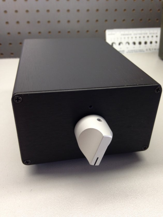

Can someone please measure the height of the blue YJ board so I can continue with the box construction?
With the board sitting on the through hole component solder leads, mine is 0.920" sitting on my approx 1/8" stand-offs (recommended) it's 1.050"
rhing
Re: TPA3110 and TPS3116 amps
« Reply #404 on: 23 Mar 2014, 02:20 pm »
Give yourself some room in case you want to put better power supply caps on the board.

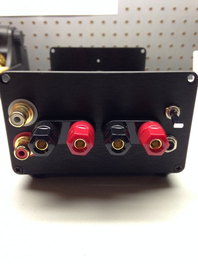

My purpose for posting was to show the modding potential of the Yuan Jing blue amp. The original designer, danzz on diyAudio.com, designed the board for modding. I appreciate any individual effort to create a project using these amps, even if it's a rough looking prototype.
Here's my ugly TDA7297 in an oversized box from Michaels:
Anyway, here are the parts shown in the photo of the rear plate on my latest build:
  • Rean (Neutrik) NYS367 RCA Connector, White...........................Mouser 568-NYS367-9
  • Rean (Neutrik) NYS367 RCA Connector, Red..............................Mouser 568-NYS367-2
  • Keystone 4109 10/32 Binding Posts.................................. ........Mouser 534-4109
    ....................................... ....................................... .............Digikey 4109K-ND
  • NKK SPST On/Off Power Switch................................. ..............Digikey 360-3003-ND
I've used more expensive parts like Vampire CM1F-CB RCA connectors and Vampire CMHEX binding posts as well as Pomona Electronics 3770 Gold-plated Copper binding posts. These less costly connectors are perfectly fine, and I probably won't go back to the more expensive boutique parts anytime soon. The NKK power switch isn't cheap, but it's a high quality power switch and perfect for these amps.

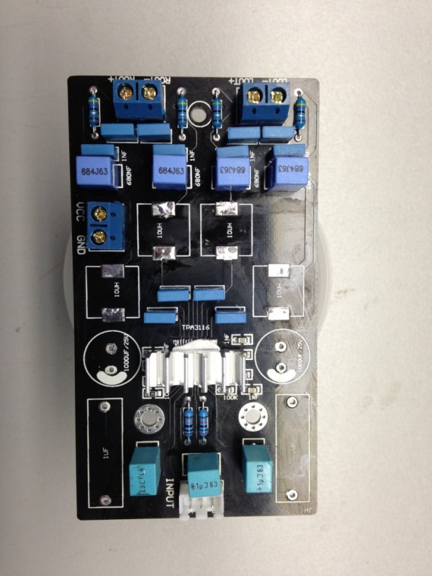

if any novices out there need confirmation of this statement, look a page or two back for pictures and commentary about my efforts with these mods. The amp is functional, but not nearly as nice and problem-free as Rhing's.
