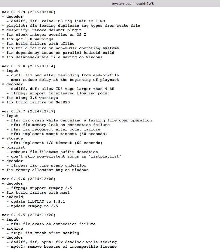

« Reply #1365 on: 9 Dec 2015, 06:53 am »
Hi Chris
Downloaded 2.21 and installed fine I think. Not sure though as system still displays 2.20.
Did it stick (and is this a glitch) or did the install fail somehow?
I did enable mpd 19.9 . Mpd state tracker still incompatible with BDP1?
Cheers

Re: Manic Moose (S2) - BDP's third major firmware release
« Reply #1366 on: 9 Dec 2015, 01:34 pm »
Hi Chris
Cheers
Marius
If you look at the build date code it should be 2015-12-08, it appears in my haste I forgot to increase the version value from S2.20 to S2.21.
The remember state relies on a feature only found in the BDP-2.  BDP-2 owners may notice that there units won't power off for 30 seconds after pushing the power button, it is the delay that the BDP-2 is given time to do shutdown tasks like save the current MPD state.
« Reply #1368 on: 9 Dec 2015, 05:29 pm »
correct. check, thanks.
News link still won't work...
Marius
yah thats currently busted in 0.19.9 is selected, but will be fixed in tonight release
« Reply #1371 on: 10 Dec 2015, 08:54 am »
Bingo! Thanks Chris, this is a first on my BDP1  :thumb:

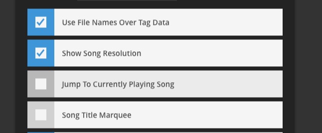

Marius
« Reply #1379 on: 18 Dec 2015, 10:24 am »
Hi Chris,
asked before: what does the 'Jump to currently playing song' do, and when? Can't seem to find the answer in the manual, nor in using the BDP....
Marius
