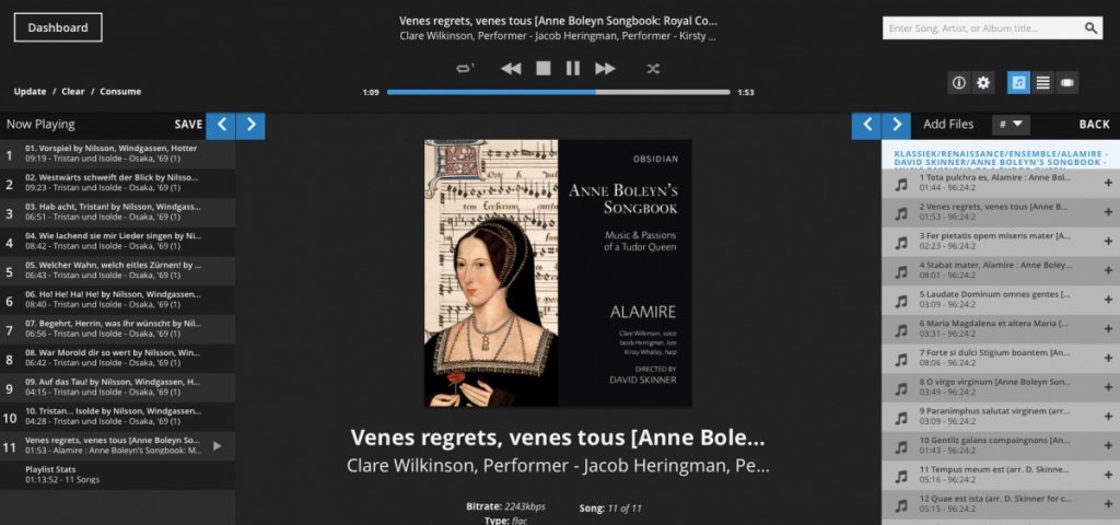

In MM there's at least four places, the files being played are shown. Including their extension/filetype, which is specified separately also.
Wouldn't it be nice if MM only displayed the file name? That would centre the attention to the music, instead of the computer-side of things.

Hmmm, I suspect you have show file name over tag data selected or those tracks are missing the title field

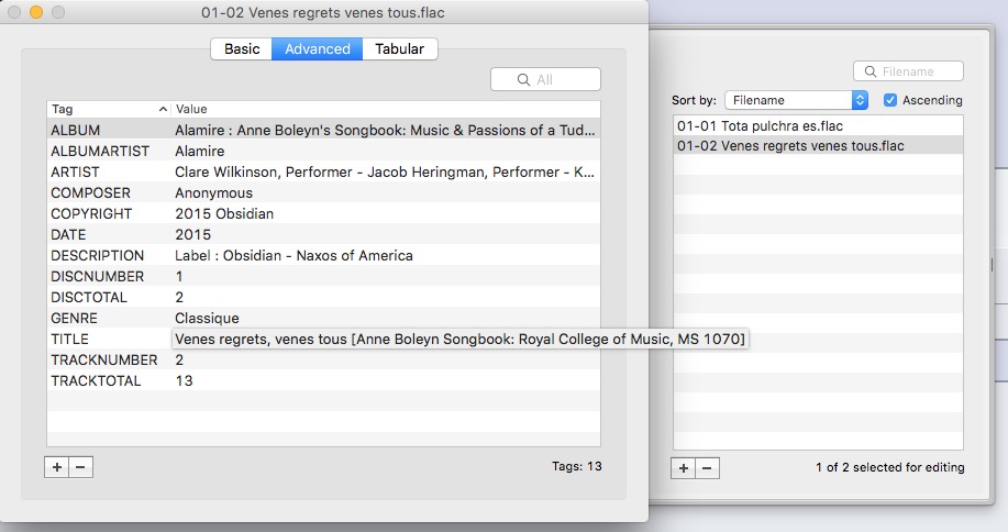

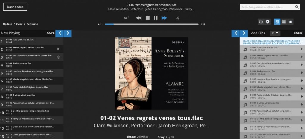

I tried that but it didn't make a difference. (File name over tag data )
Have to check the title field. Any suggestion for a good Mac app?

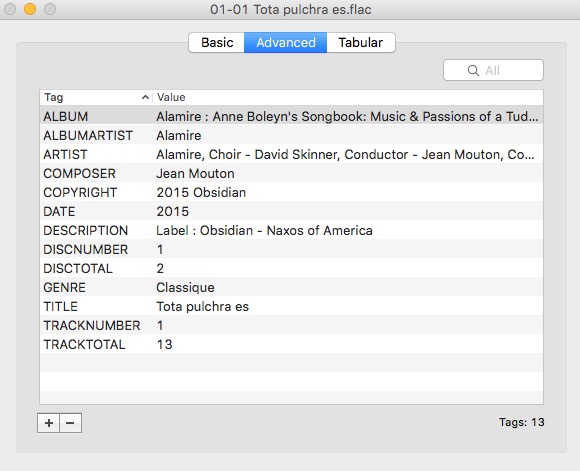

edit: using Tag http://sbooth.org/Tag/ i found the title field tag also to be correct:

Could you show a pic how it would display if the above is were set all right?
However,
this does show my point of the MM interface being a bit too much 'computerish' instead of being more music or even user oriented .
Only the file name is of interest , not it's type . Leaving it out on those places wouldn't do any harm ( file type is already being specified separately) would look better in 4 places, would save screen estate, and would relieve the user of having to think about getting their tags right ;)

Well Chris,
forget about my tag/extension question...
Don't know what happened, but after loading a new mp3 download (OperaDepot, great source!) the extensions are no longer visible... :scratch:
