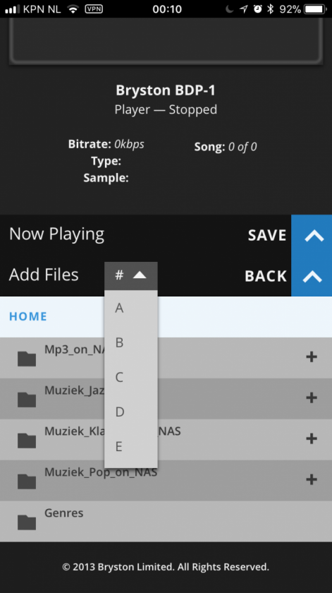

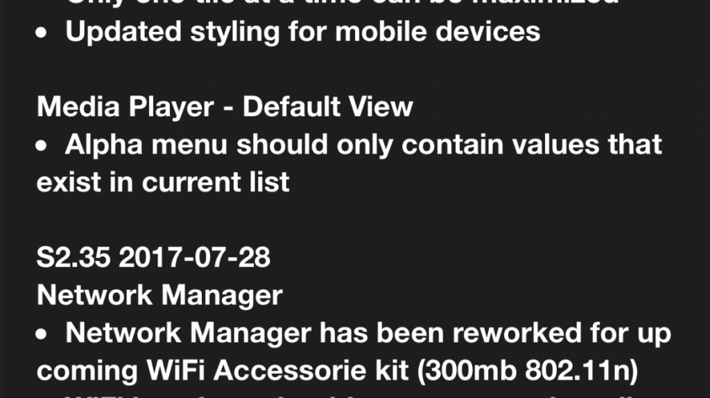

Also, and Chris that might be able to perfect that, the Dropdown also shows letters without having an item for that letter. Leaving a click on that pointless letter without any action. Maybe empty letters could be grayed out, or just not shown?
Be safe,
Marius
Chris, Thanks !!
Doesn’t work on all listings yet though. Check for example my root, only these 4 subfolders and still the full alphabet in the dropdown.
Quick analysis seems to indicate that only folders with actual albums containing songs work correctly. All other folders don’t just yet.

A certain number of headers need to be generated before it'll take effect, 4 or 5 I think
Not here, I’ve 2’folders with 6 and 8 subfolders and they show the full alpha-dropdown.

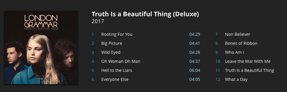

This issue seems to be with the new Dashboard view AND the Default View. With the Artist View, the track ordering is correct, as seen with the same album in the image below:
And... it seems to be limited to MP3 files. I even tried re-writing the ID3 tags using version 2.3 instead of 2.4 - no difference. Every album of MP3s I have presents this defect in the new Dashboard and Default view, but track indexes are correct in the Artist view.
Eventually we'll either offer an option to attempt enforcing this format or just enforce this format, should be part of S2.38
Cheers
Marius
But their is a criteria for the dropdown menu to be relevant which i believe is something like 20 items, i don't believe anyone would bother to use it with a few items in the list.  We'll do some more work on it this week.

Re: Manic Moose (S2) - BDP's third major firmware release
« Reply #2192 on: 8 Aug 2017, 06:51 pm »
Hi Chris
I must have misunderstood but I replied to your post mentioning the need for 4 or 5 headers ?
I agree with you on the need for the drop down, but since it is there, also in smaller listings, it would make sense to make it consistent in al places, no matter the count in the listing.

Hi Chris
 Cheers
Marius

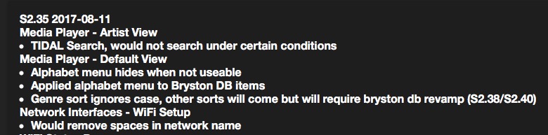

Both criteria would need to be met, i might simply hide the drop down menu if there aren't any of the headers.  Again i'll take a look at it later this week when i return to work.
« Reply #2195 on: 8 Aug 2017, 07:00 pm »
 :thumb:
Chris, a big thanks!
