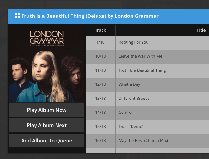

Krutsch
  • Posts: 568
Re: Manic Moose (S2) - BDP's third major firmware release
« Reply #2162 on: 29 Jul 2017, 11:25 pm »
We are back to the problem of ordering songs with more than 9 tracks. See attached image:

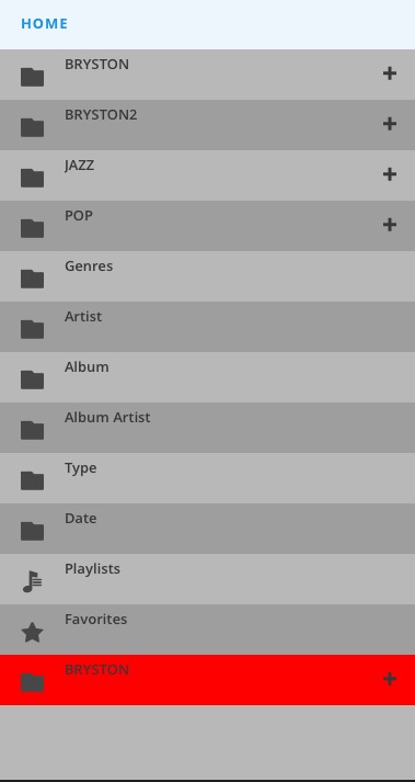

Marius
« Reply #2164 on: 30 Jul 2017, 09:59 am »
adding to the above poster about unstable bdp1: mine won't play at the moment... keeps saying MPD is turned off, while it is not, according to the Settings tab.
I've taken the jitterbug out again, to no avail, nothing will play. The DB is still loaded, i can browse the files, but after adding to a playlist and click play, nothing happens and BDP is stopped.
Remarkable: the red entries that were there for all HDD's are gone, only the front usb is shown  :scratch:

Marius

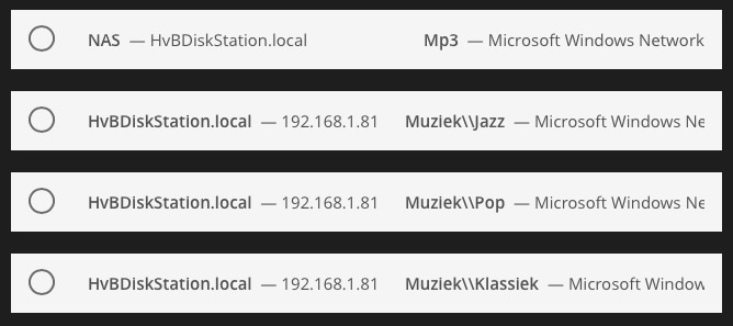

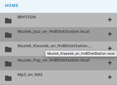

Chris,
Where in the 28-7 beta firmware can i find the reset DB button? I need to restart building it because of changing the HDD's/network shares setup.
Somehow i can't rename my shares like before. In the MM interface I've browsed and installed 3 extra shares, pointing to subfolders of my Muziek folder in the Root of my NAS.
Previously i had a share and renamed it MP3 on Nas, while it original name in MM was Mp3 on HvDDiskStation.local.
My newly installed shares now in MM are of the Muziek//Pop on HvBDiskStation.local type. If i rename these to Pop on Nas, which is highly preferred, things go wrong.
Would really love to have the option back to rename these shares to something more user-friendly. How to proceed please? Editing the name in the MM interface won't work, neither does editing the NAS file in //User .
I would also like it very much if the _on_xxdrive could be left out in MM, but that's of secondary priority for me right now.

Chris,
Marius
Hi Marius,
You should be able to change the server name field during setup without issue, however the path "music/pop" must be left as is.  I'm glad you brought this up, i to agree this is something we need to add as a feature.  I meant to move the buttons to be found under the Bryston DB section, but i guess i must have just removed them by accident.  You can use the below address to trigger an update until the next release.
http://bryston-bdp-1.local/mpd/dbreset.php
« Reply #2171 on: 1 Aug 2017, 05:46 am »
Hi Marius,
Thanks Chris, cool.
Any reason MM won't allow the use the .local instead of the ip address anymore? I always set my network devices to dynamic addresses, so don't really like being forced to use the fixed ip addresses.
So as not to confuse:
the .local naming would be preferred for localizing the server in the NAS setup interface, but not for the naming in MM interface.
I really think it is a pain to the eye in MM. Hope you would be willing to let us just name it Pop or what ever, and have a dedicated icon indicate the folder to be on a network share, instead of on a local drive. That way we could dispense of al the horrible underscores too...

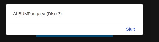

Chris,
A Bryston DB is detected. Since you said some feedback was provided in the error messages, i clicked, et voila, this it the result.
Now what does that mean ;-)
Would be cool if these messages were a bit more precise about location and reason of the error occurring to this album. It happens have several Pangaea files..Not knowing what to look for makes it hard to lift and prevent the error.

Krutsch
  • Posts: 568
« Reply #2178 on: 2 Aug 2017, 02:16 pm »
S2.35 2017-07-28
Build: Manic Moose
MPD: 0.19.21 NEWS
Kernel: 3.16-0.bpo.2-486
COPYRIGHT BRYSTON LTD. 2010
This issue seems to be with the new Dashboard view AND the Default View. With the Artist View, the track ordering is correct, as seen with the same album in the image below:
